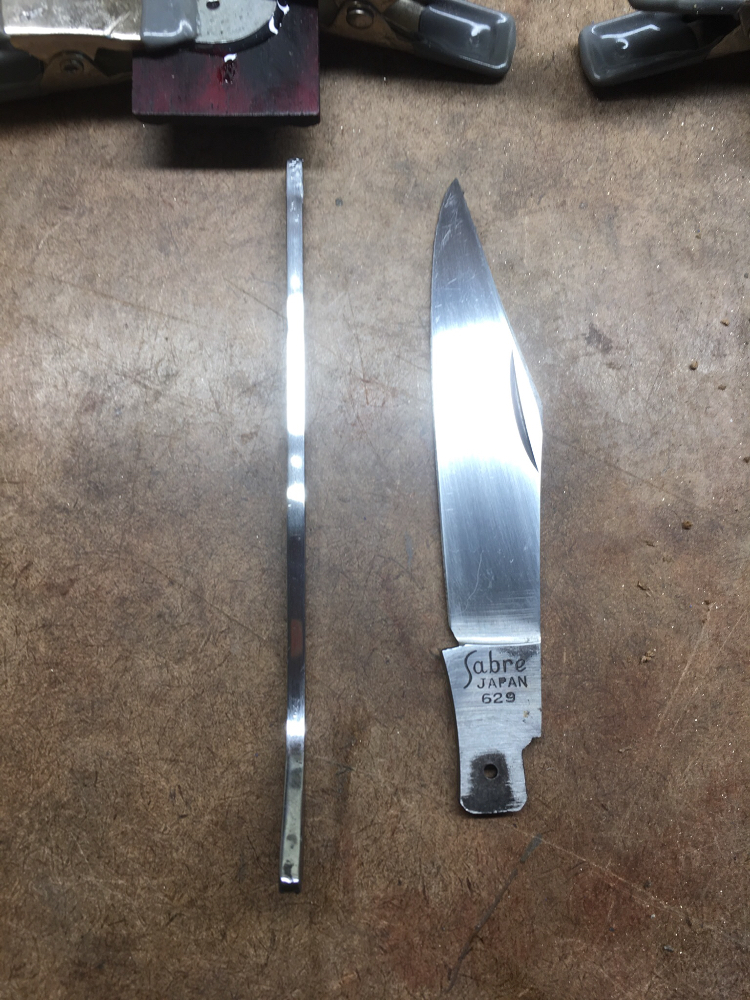

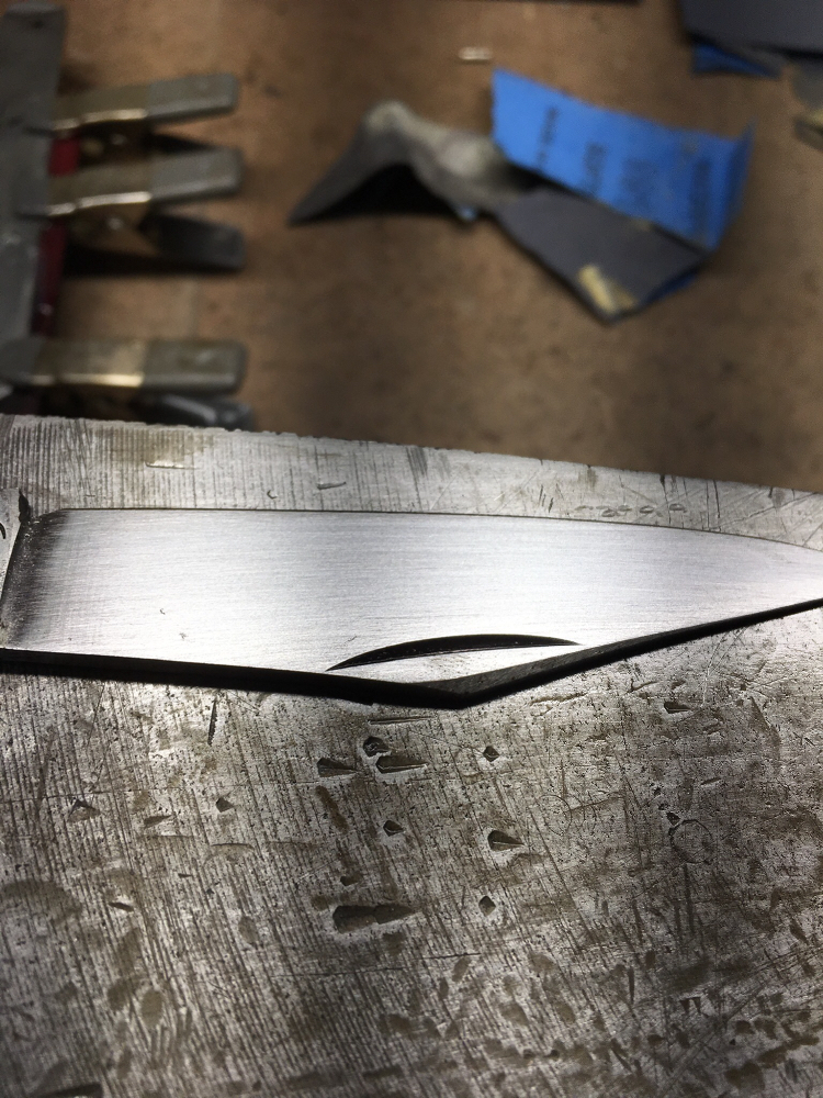

I started this knife project by cleaning up the blade a bit (200, 400, 600, 800 & 1000 grit paper and some elbow grease). The blade didn’t need much so it turned out okay;

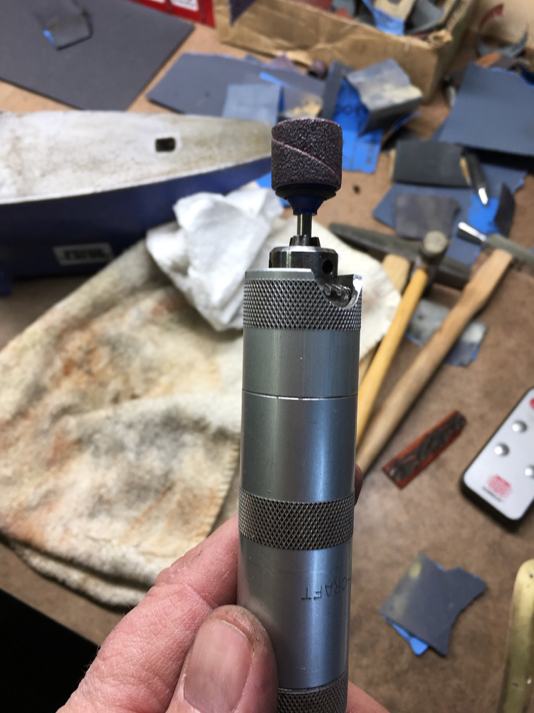

With the blade done I turned my attention to the backspring. I like to clean and polish the inner and outer edges of the spring and my tool of choice for this task is the Foredom hand piece and some sanding sleeves;
The blade and spring turned out pretty good after some additional hand sanding;

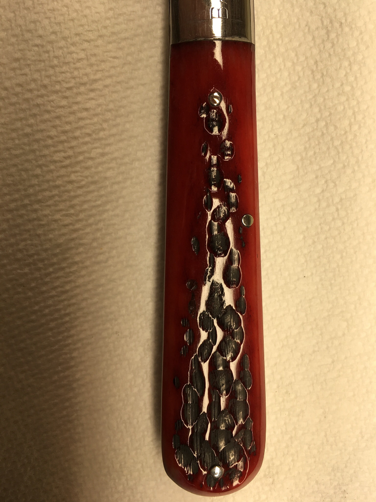

Time to drill some holes so I can finish securing the bone handles and test fit the pieces. The liners had holes in both edges for the backspring pin. I assumed that I had drilled the holes in the right location until I went to put the halves together and realized there was one hole in the top of one handle and one hole in the bottom of the other handle. The knife gods are now laughing their asses off! I know, I should have stepped away but that whole stubborn/pig headed thing prevented me from doing that.
There’s no way I was going to scrap the handles. I had some bone scraps from the handles so I sanded them down, collected the dust and packed it into the errant hole. I put a few drops of Zap a Gap in the hole, let it set and sanded and polished it out. It turned out alright (the repair was mixed in with the jigging so it virtually disappeared);

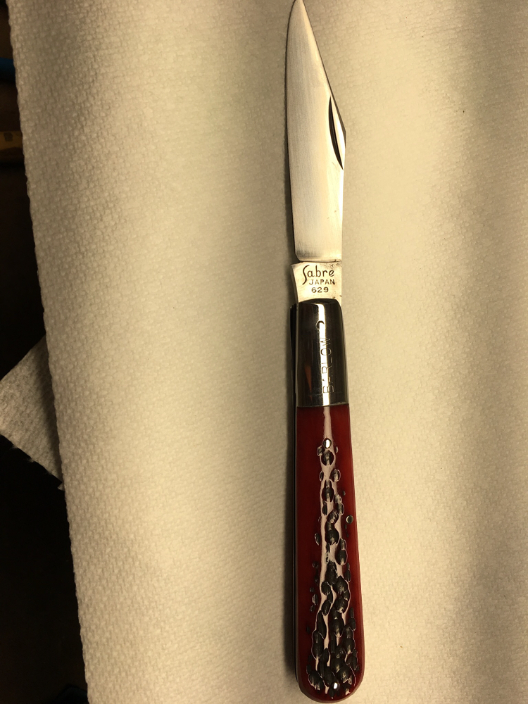

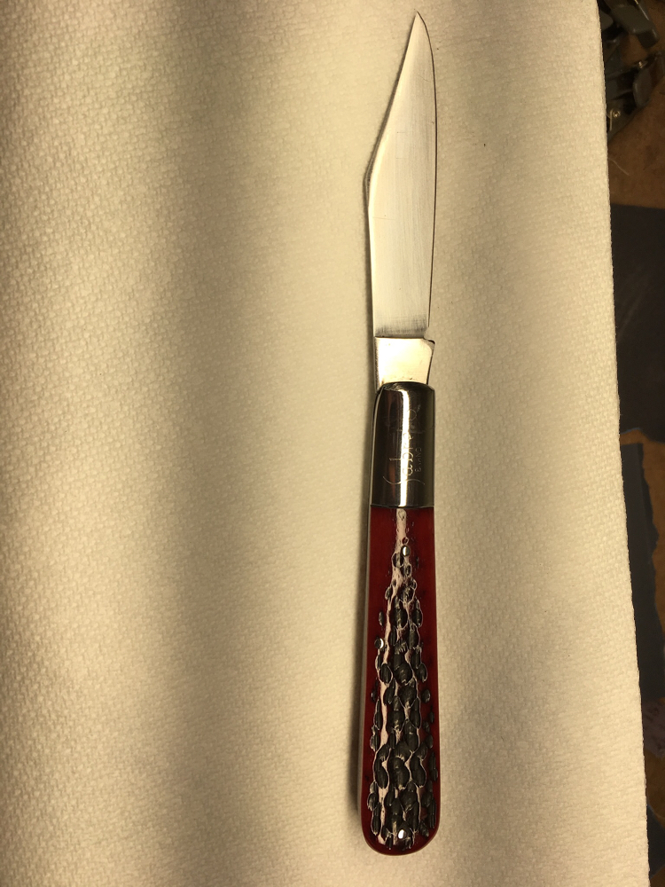

I finally put it together, polished it up and put it on my shelf so I can look at it from time to time to remind myself of how things can go wrong when I get stubborn.
Parts didn’t fit, misdrilled holes, errant grinding and mis-shaped blade tang, but I managed to get the cursed knife done.
