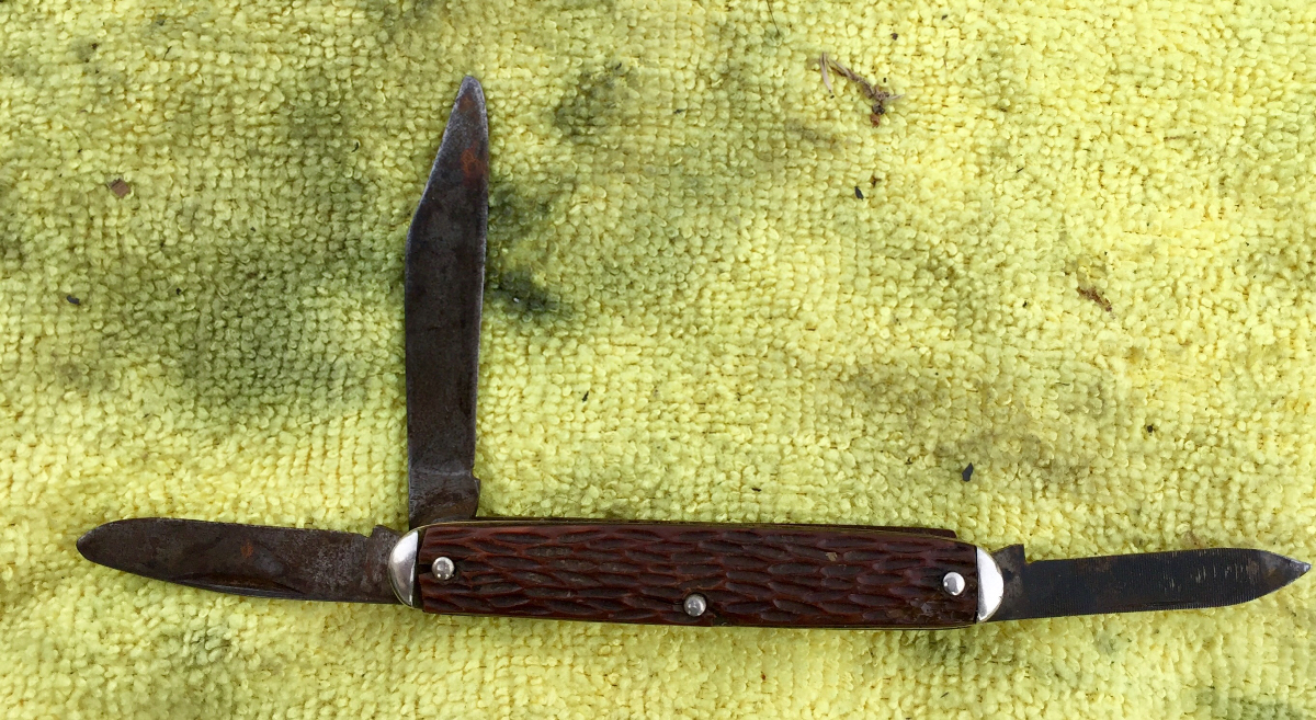

Found this no name knife that needs new scales. I will be using black Delrin and jigging them. The 2 blades are in Good shape and the file is ok too.
This should be a fun little project.

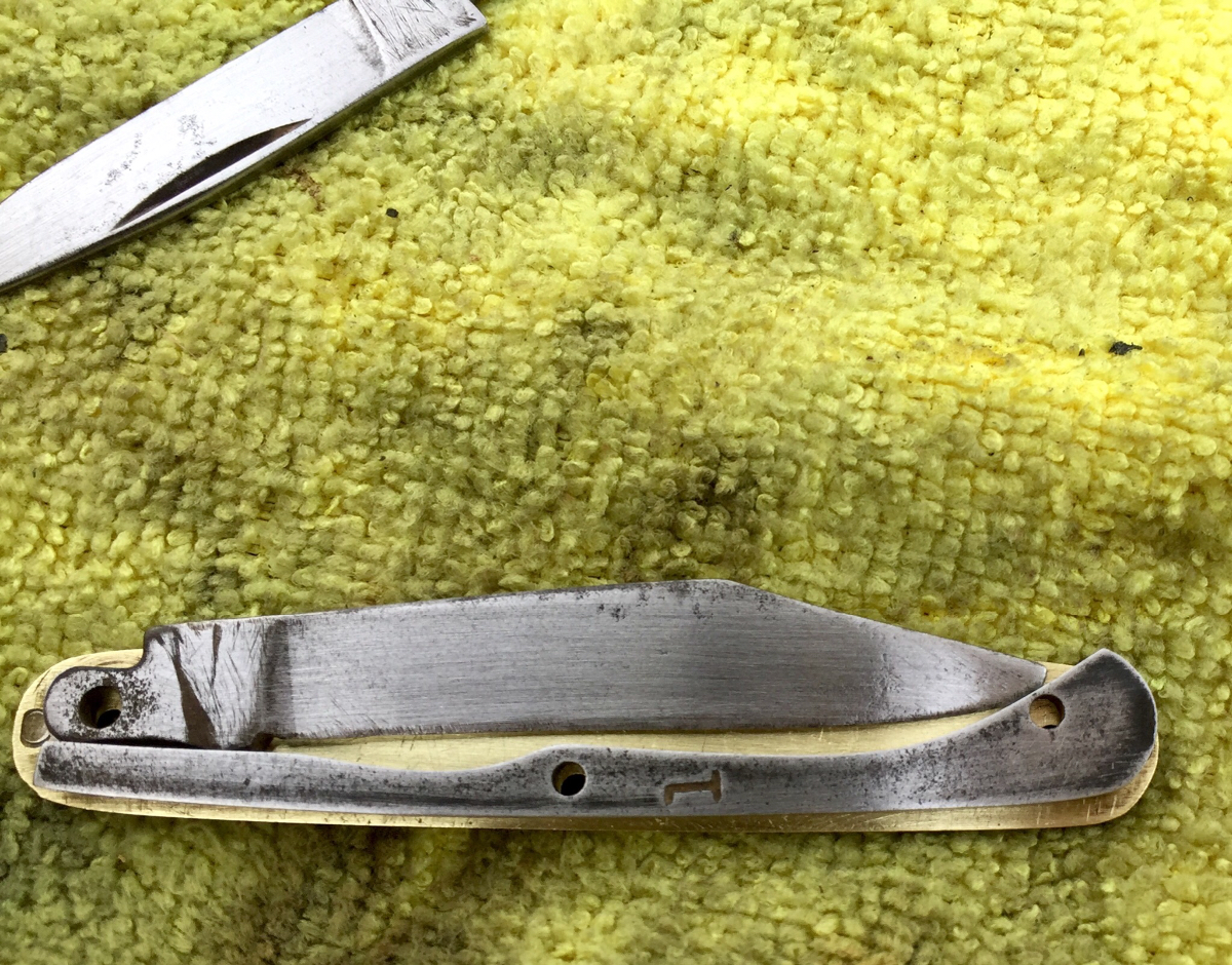

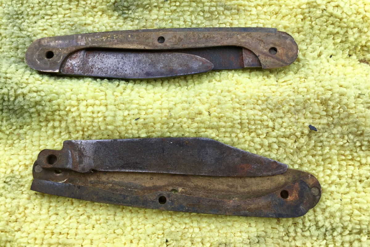

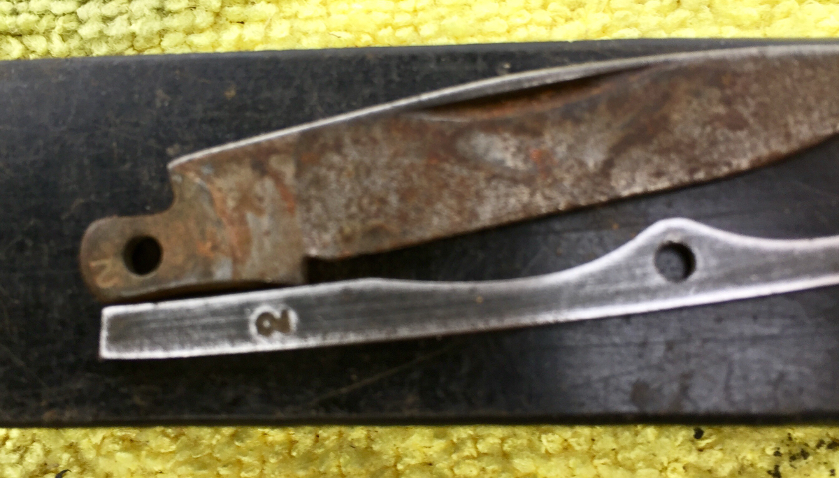

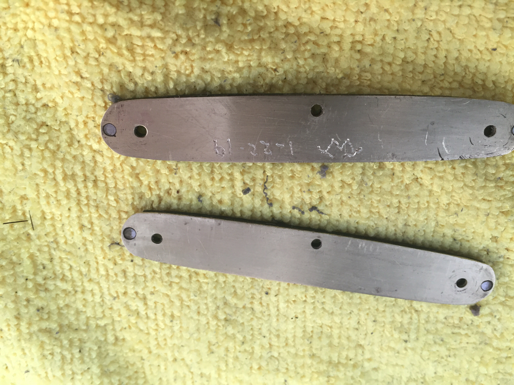

Here are a few in process disassembly pictures and starting clean up.

How Interesting , Blade and spring Stamped with corresponding Numbers . Just an Observation :roll: Kool ::tu:: K.C.

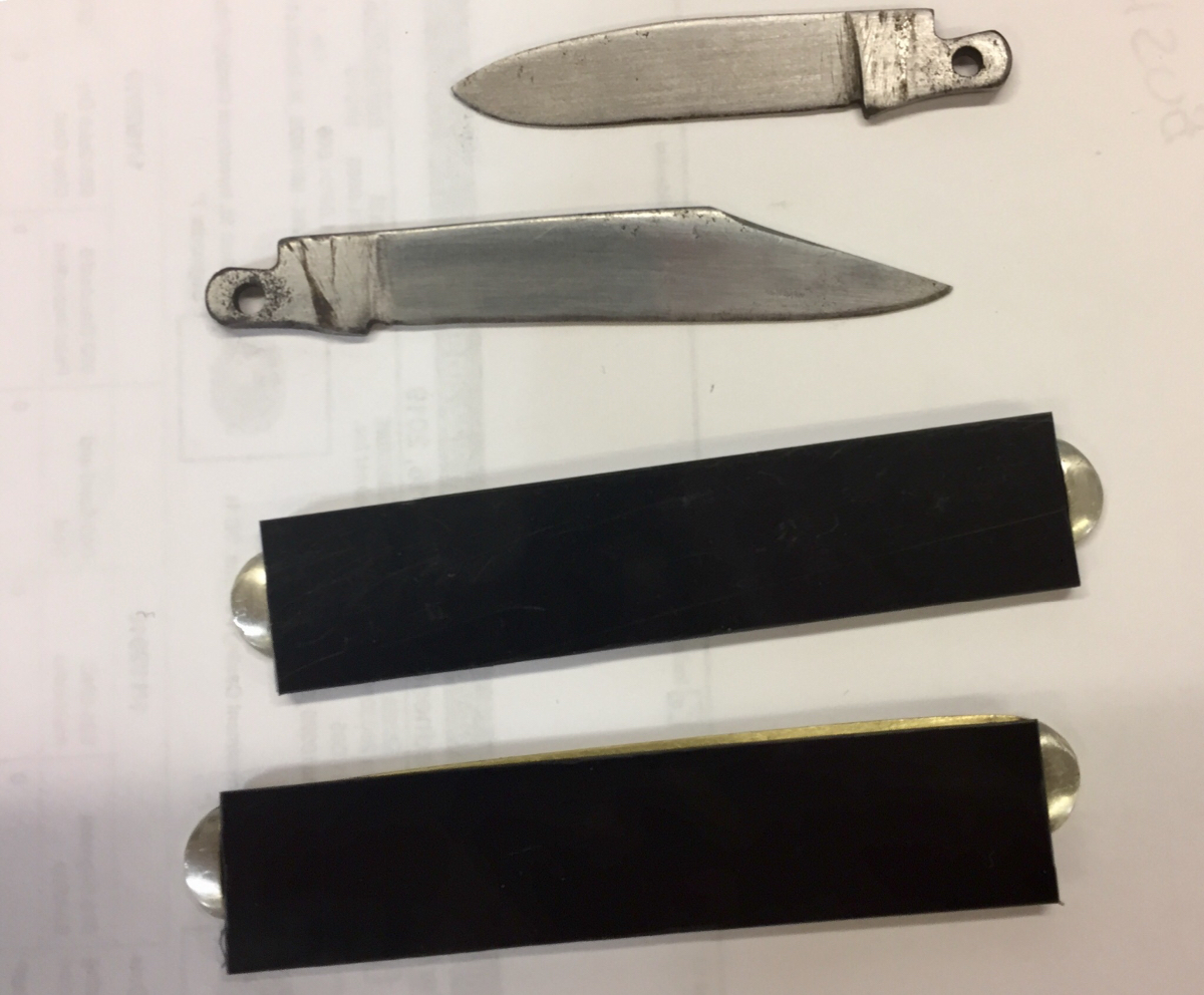

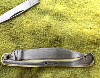

Last night I cleaned the blades up. I only went to 600. The scratches were deeper than I thought. So I did not want to remove more material. I also reshaped the tips of the blades.
Today I had a bit of time at work so I thinned down the Delrin to .080 thick and fit to length. Tonight I hope to jig the scales and assemble.

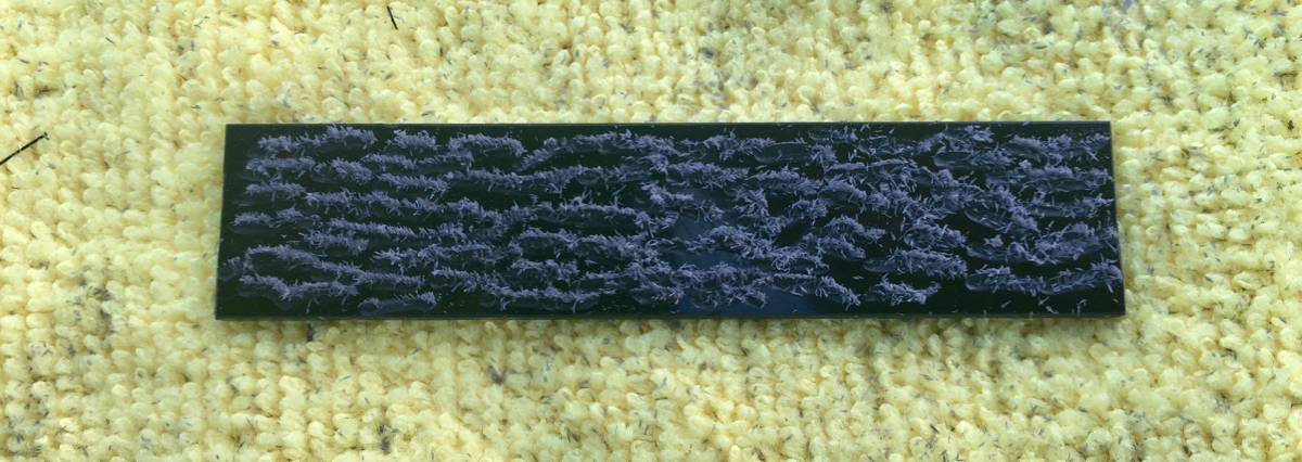

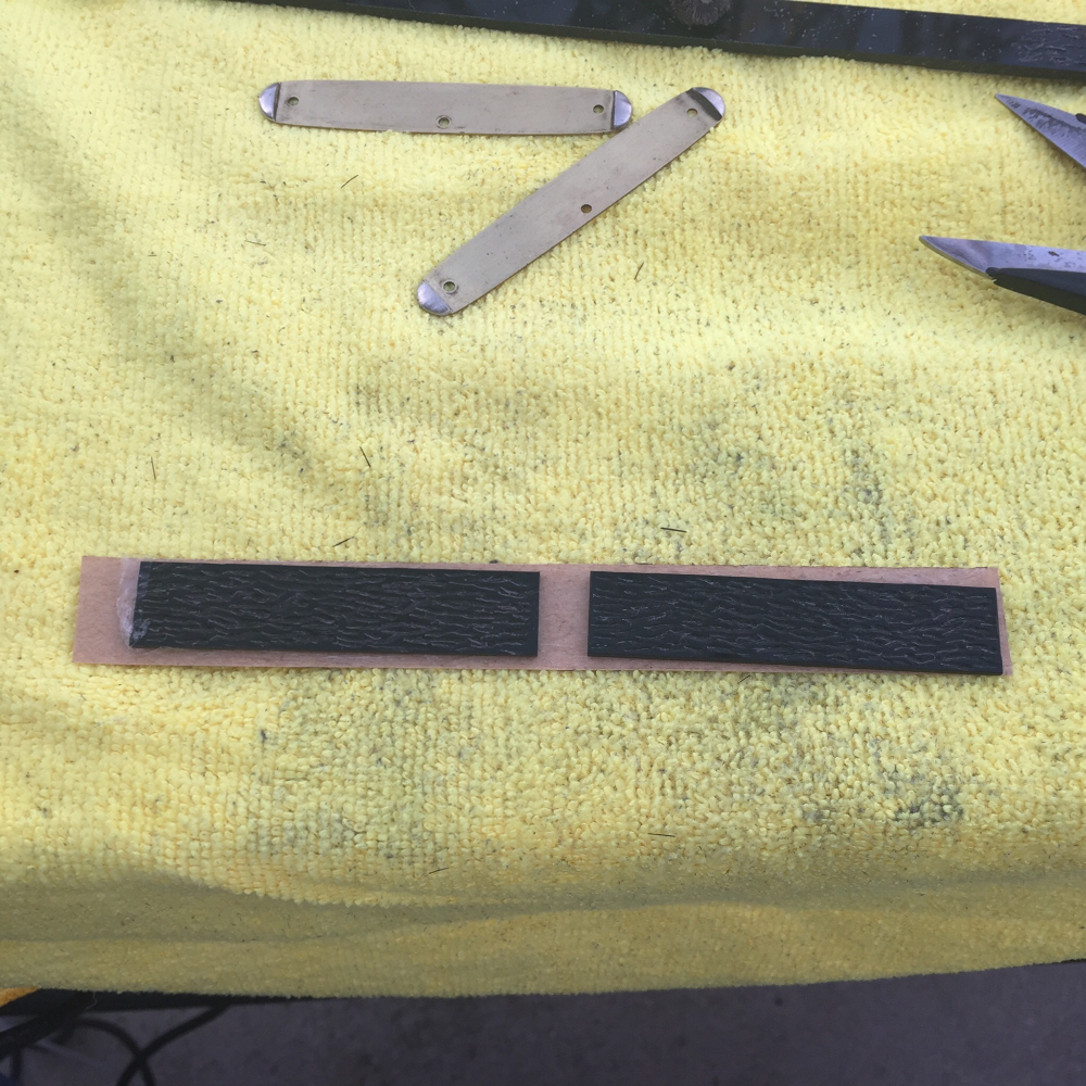

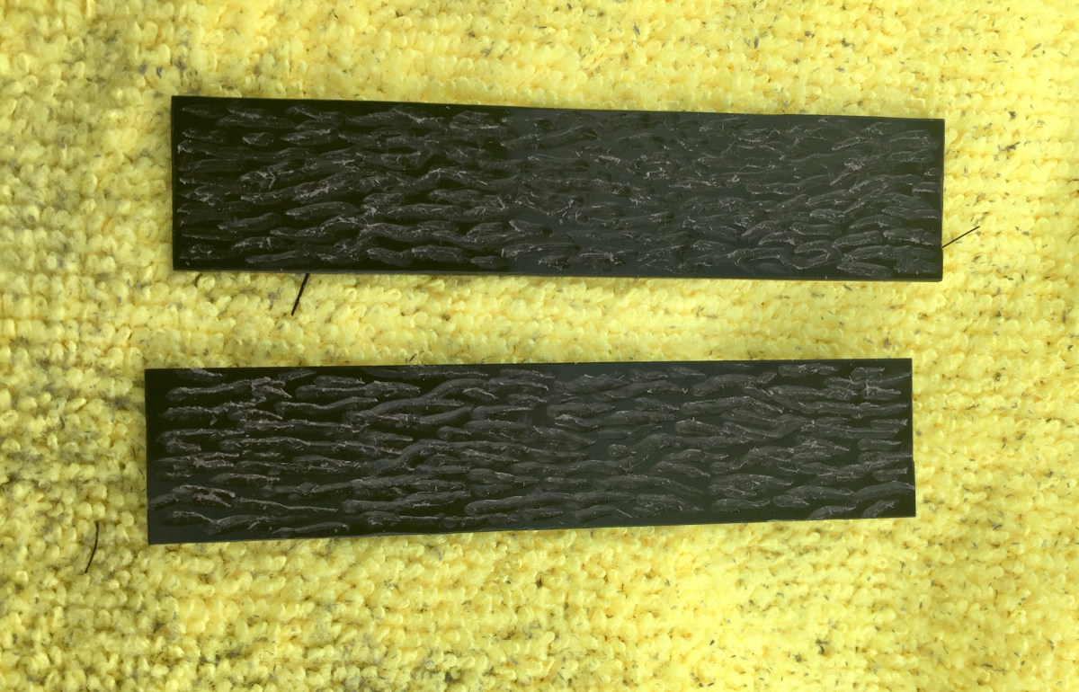

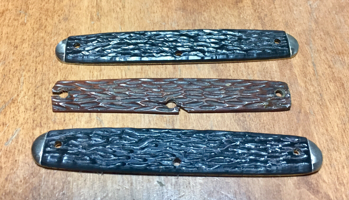

Here are a few in process pictures.

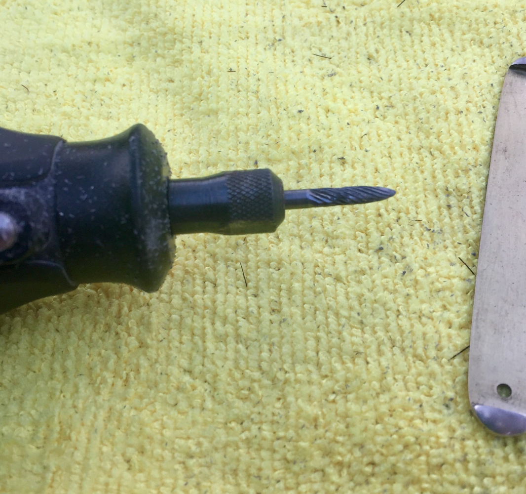

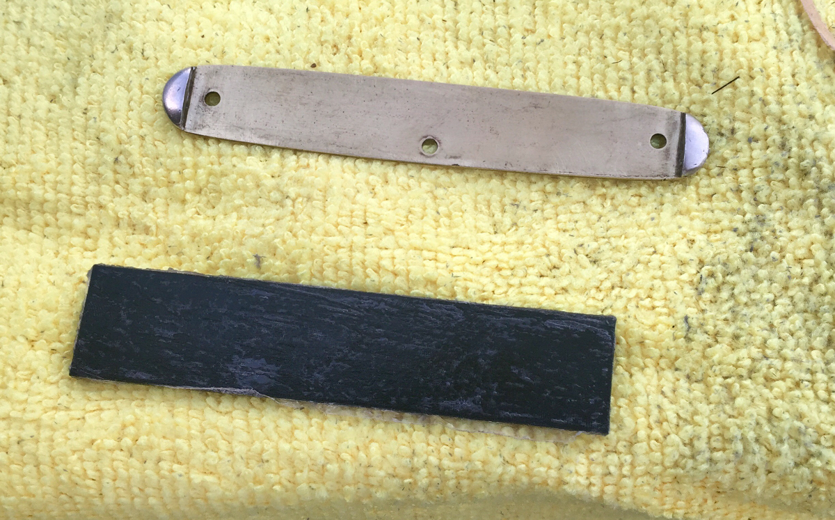

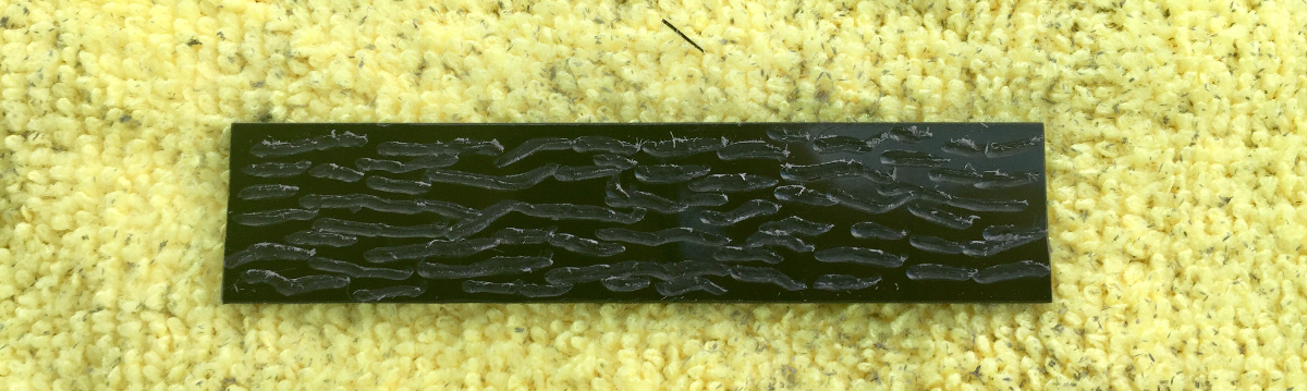

Picture 1 is first pass of jigging before removing hair. Second pic is pass 1 hair removed. I repeated this process 2 more times. Getting in between previous jigs. I did not want to go to far at once. Also cleaning up between passes allows me to see where to add more.
Third picture is finished jigging. The last is the burr I used. I held the dremel at 30 degrees from parallel when jigging allowing the burr to walk a bit. I also varied pressure to get variation in depth.

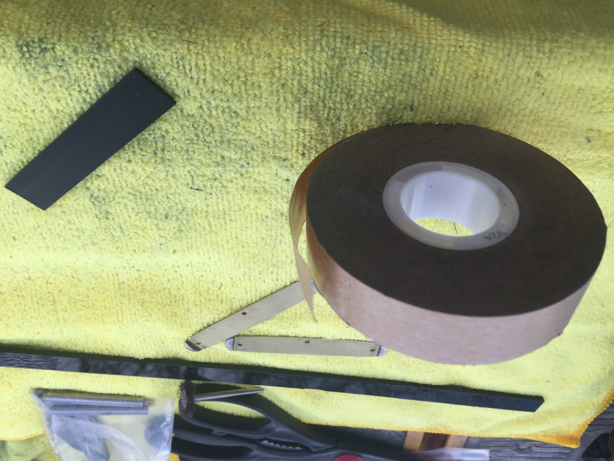

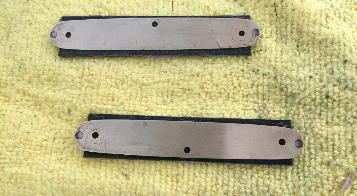

Next step I just did was mount the scales with some acetate tape. It is super sticky and only .001 thick. I am hoping this will hold enough to shape them to the brass.

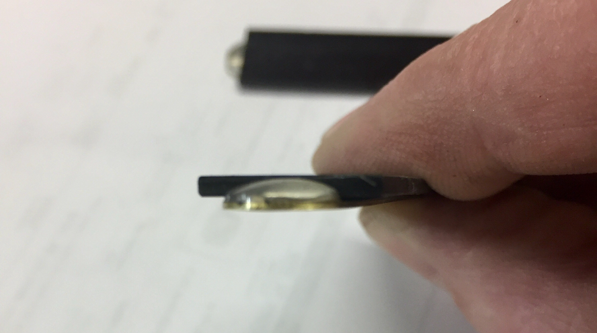

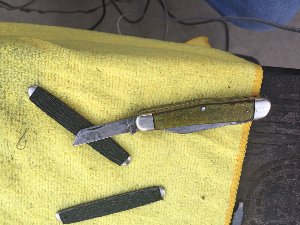

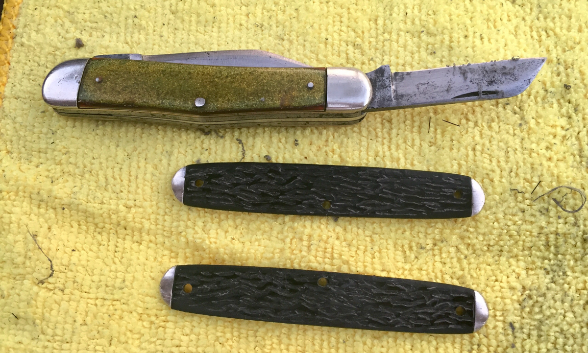

Scales are shaped and blended.
I used my beater belt sander to shape the scales and my western whittler to blend and radius everything.
I marked the knife with my brand and date.

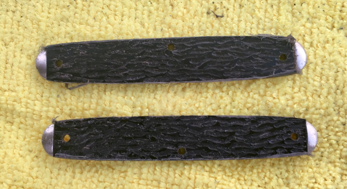

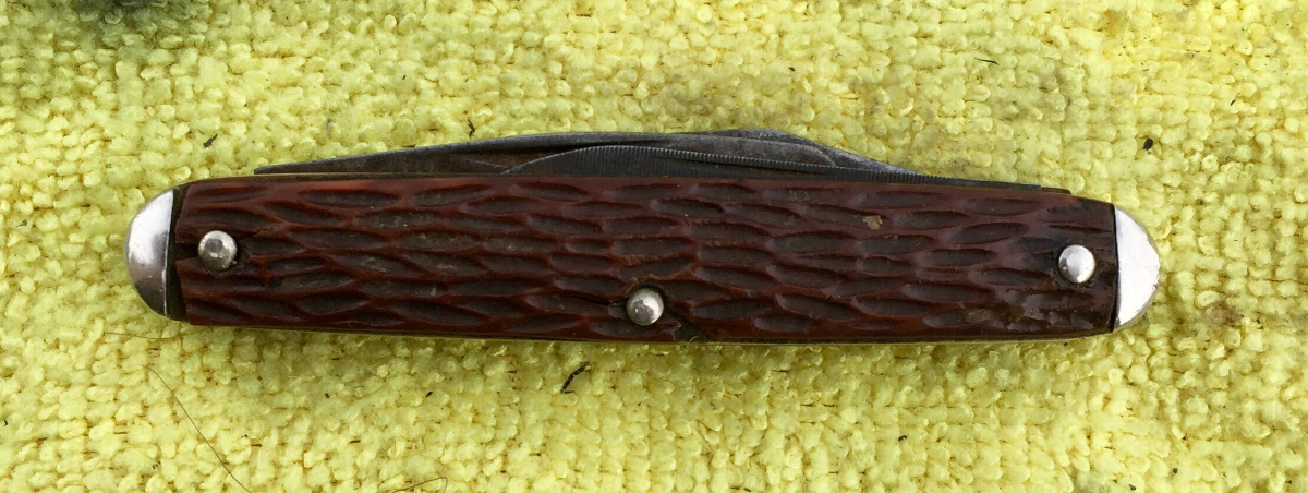

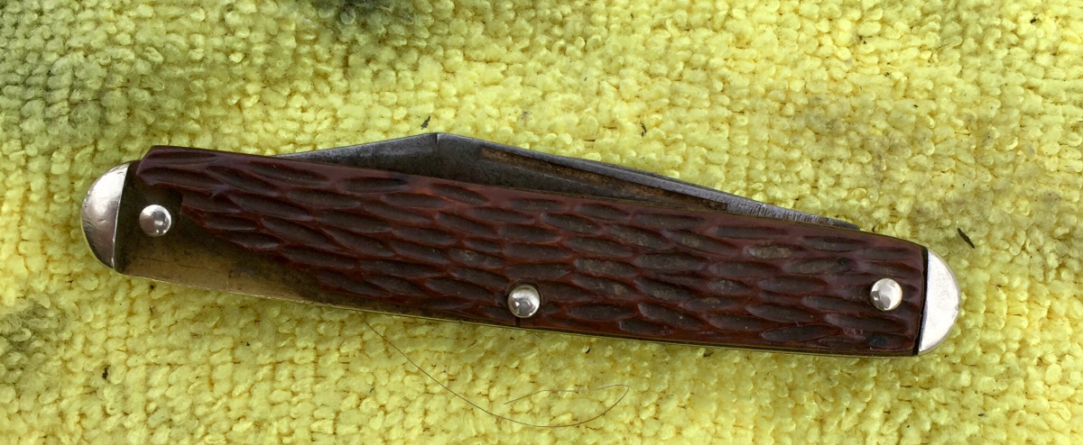

Here is a comparison to the original
