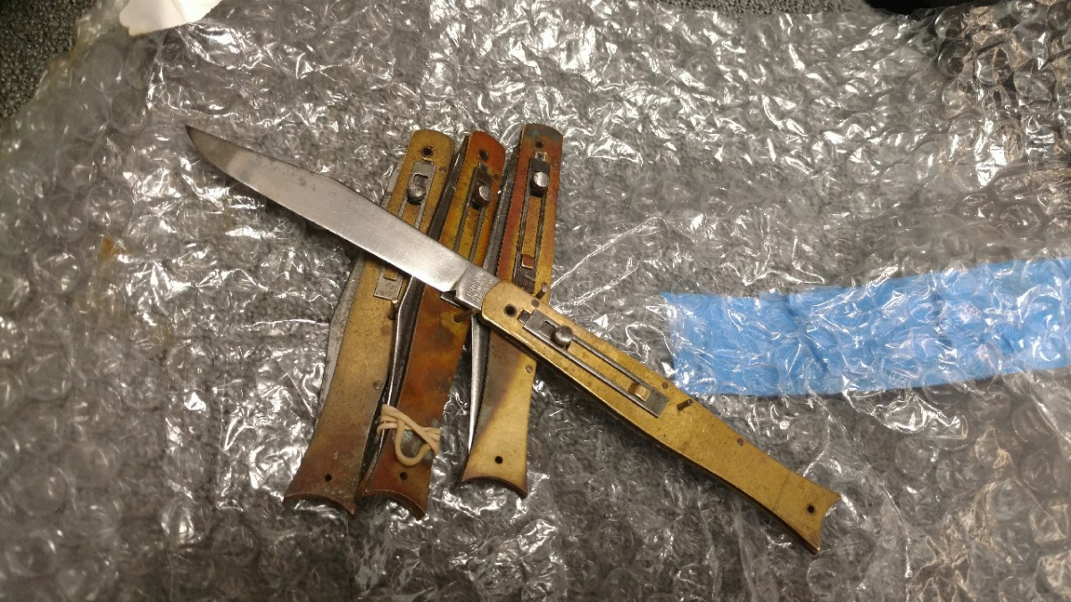

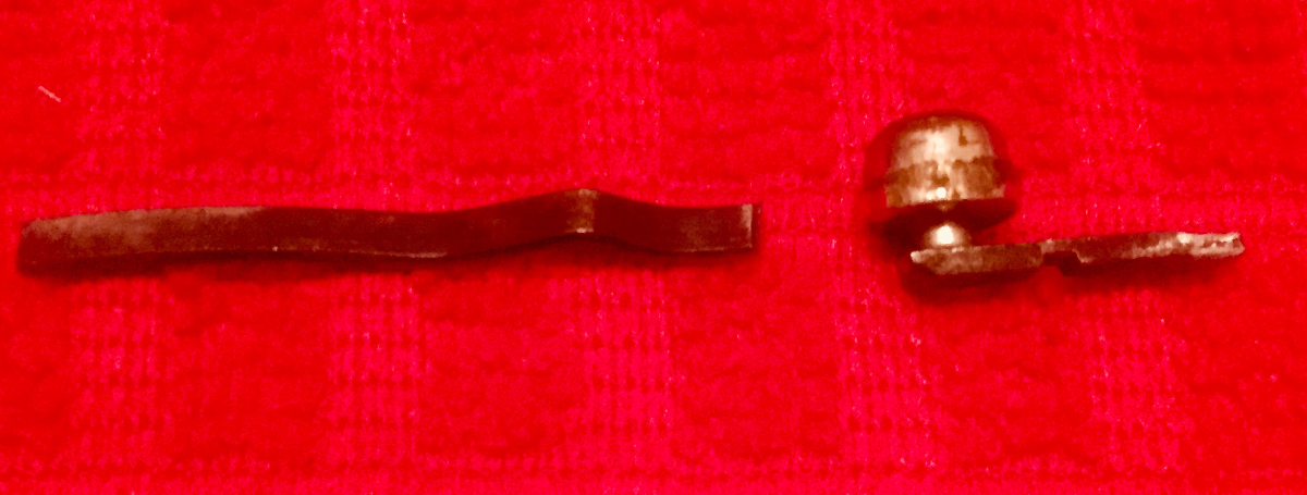

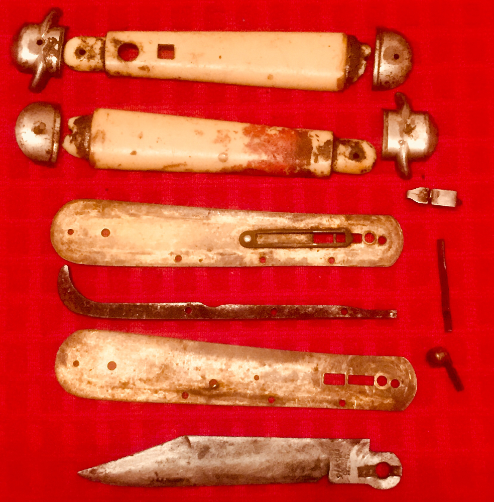

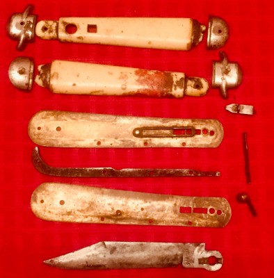

Ok my fellow AAPKers, I received the knife in the pictures, in its present state. In other words it came to me in a zip lock bag. I wish that it was left together but it was not. I have never repaired one of these but I would like to think I would be able to do it. All my repair/restore peers please help me out. I believe the push button is broken. Not sure if I can repair it or I may have to find another to replace. Anybody have pictures of the inside assembled? Hints, help, ideas all the above welcome. Also not sure what I will make the new scales out of so suggestions welcome as are ideas. Clarification... the knife was given to me. I will be repairing it for myself. Thanks everyone in advance.

I looked and don't see the patent for this on line. Maybe Kaleb or someone else would have a knife with a broken spring you could buy for a few $ and take it apart and see how it works and make a diagram of how it goes back together? I don't have one right now but have In the past. Best of luck with your project.

Not sure if you can easily tell by this pic. Looks like you will possibly need a new spring, but maybe it's the right size.
Kaleb or Bill would explain better, but I'll give it a try. In my pic, the gray rectangular slotted piece acts as sort of a spring for the button, held in place at the bottom end, and allowed to float at the top end. The button, if you look at that assembly, has a little groove in the bottom of the bar. That will sit on the little cross piece, and act as a pivot. That button assembly holds the blade closed, and when depressed, allows the blade to spring open.
Hope that helps a little.
Re: Colonial Shur Snap questions
The little flat folded formed piece is a safety that slides up and down in that slotted piece. All the way up, and it engages under the button, keeping the button from being able to be depressed.
Glenn explained it pretty well. It looks like to are in posession of all the parts except a kickspring which isn't a big deal these can be salvaged from old junk knives or I sell ready made replacements. You'll also need to make a blade bushing, these can be turned from brass using a file and a drill (a drill press preferebly)
