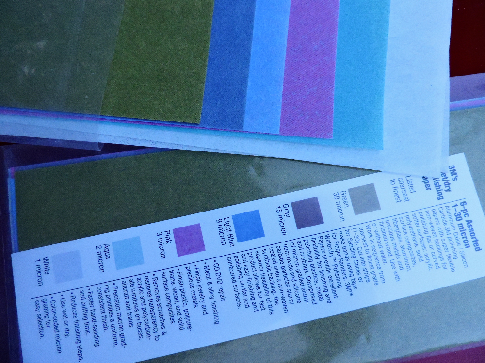

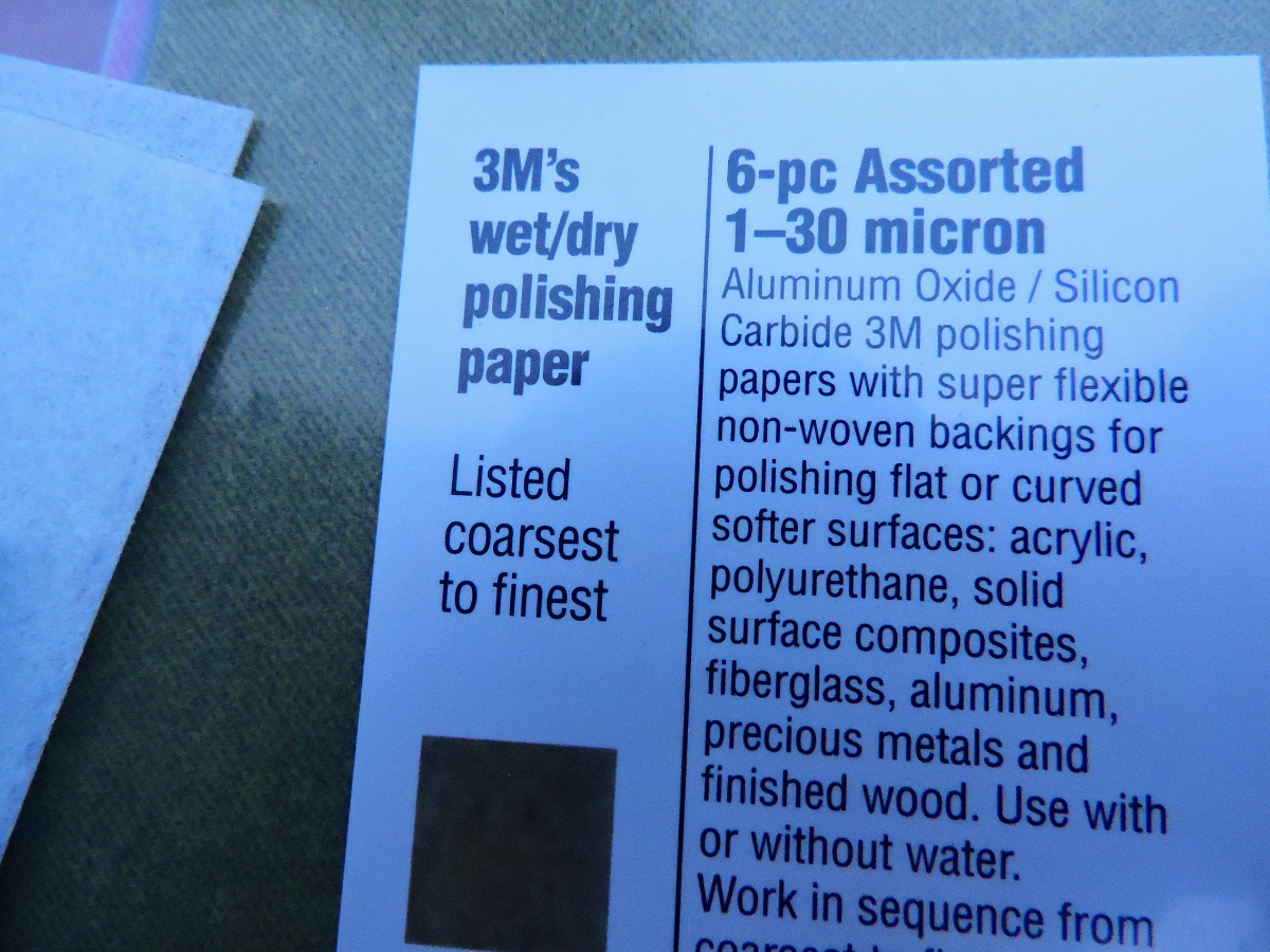

Here are some abrasives I bought on Amazon some time ago. It's pretty fine stuff but worth having around I think.
I haven't taken the time to use this stuff so I can't recommend it. I thought it was worth mentioning.
I was going to use it on some of my kitchen knives.

I regularly use the 3M polishing paper that you mentioned in your post. I think it is really the best thing for someone who does not have a buffer or belt sander available to them. The scratch pattern and grit numbering system is different than regular sandpaper. I will usually use regular sandpaper to about 1000 grit and them drop down to the 400 grit 3M polishing paper and then work progressively from 400 grit to 8000 grit. If you use all six grits in succession, 400, 600, 1200, 4000, 6000 and 8000, by the time you have finished you can have close to a mirror finish on a blade.FRJ wrote:Here are some abrasives I bought on Amazon some time ago. It's pretty fine stuff but worth having around I think.
The scratch patterns produced by the abrasive on 3M polishing paper are different than the scratch pattern produced by a comparable grit sandpaper and they are not as deep as the scratch pattern of sandpaper, that is why I sand to 1000 grit was sandpaper before dropping back to 400 grit polishing paper.

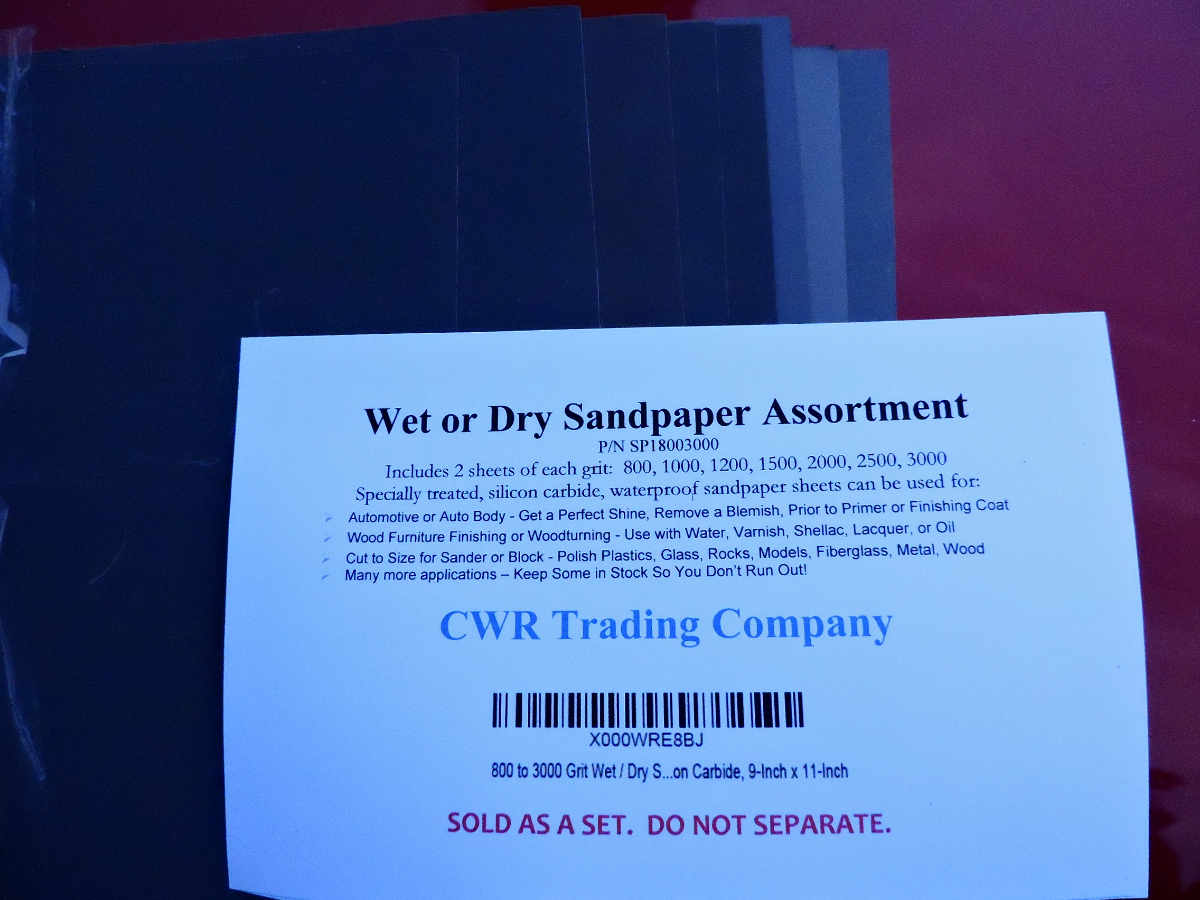

Re: Starting Grit for removing scratches
Thank you, Dale.
It's nice to have some conformation of the use of that 3M product.
Would you consider going to the higher grits with the wet dry sand paper I showed?
It's rated up to 3000 grit.
Thanks
Thanks

I would certainly try it and if I like the results I would definitely use it.FRJ wrote:Thank you, Dale.
Thanks
I have not seen that brand before. Did you get it online or purchase it locally?
Thanks Dale.
I bought both the 3M and the CWR Trading Company abrasives from Amazon.
