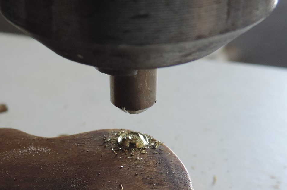

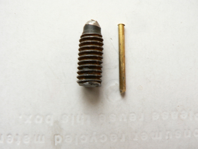

I have made spinners from set screws that worked better than the commercially available spinners.

I made one from a bearing set screw.(also check out high tensile bolts some are concave on the end )you notice some grinding on the end. I did it on a wet stone otherwise the metal gets hot and losses tensile strength.Not perfect but cheap.
