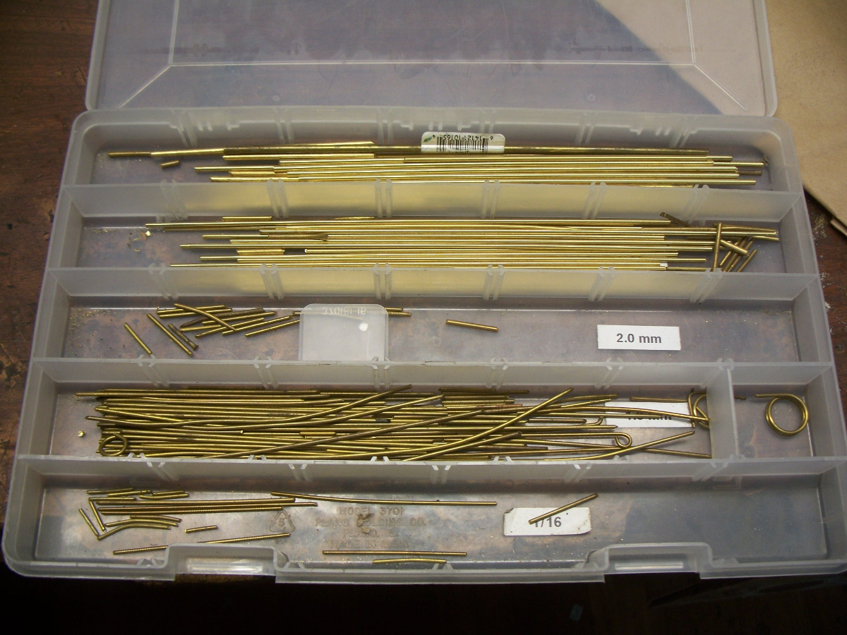

I use several of those little plastic parts containers, the ones that have the removable dividers. I keep the NS separate from the stainless.

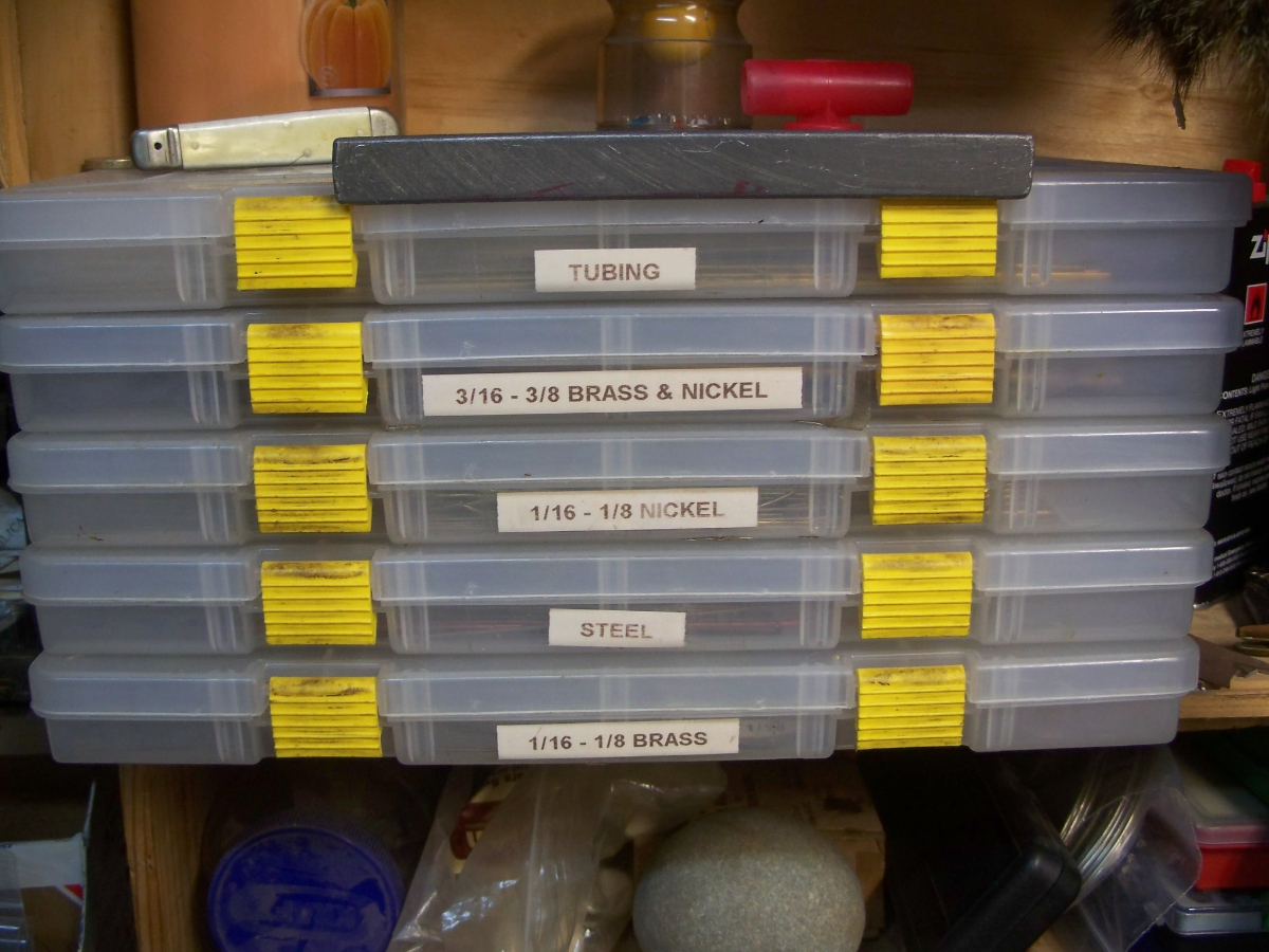

This is my solution. I have some plastic tackle box type boxes that I use for shorter pieces.

Best option I have found Plano model 3701. Holds 12" pieces of pin stock with ease. I label each tray with the size, the rule is when I can see the sticker it's time to order. Easy to keep things organized this way. I still have oddball stuff individually labeled in a cigar box but generally if I run into something weird I just turn down a pin to fit and don't stock a bunch of off the wall sizes. 1/16", 1.8mm, 2mm, 3/32" and 1/8" will cover most jobs.
I also keep a book with the item, item number, place of purchase, last known price etc. makes it easy to re-order later when supply runs low.

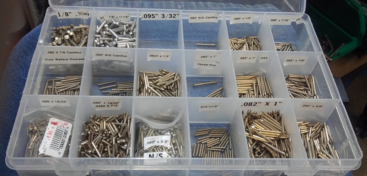

When I read Jeff’s first post I was thinking of the 12 inch long pieces of pin stock. Here is the picture of my storage for the 12 inch pin stock, turned the right way. I also buy some sizes from Ace Hardware in 3 foot lengths. I usually cut those into 12 inch lengths and store them here also.

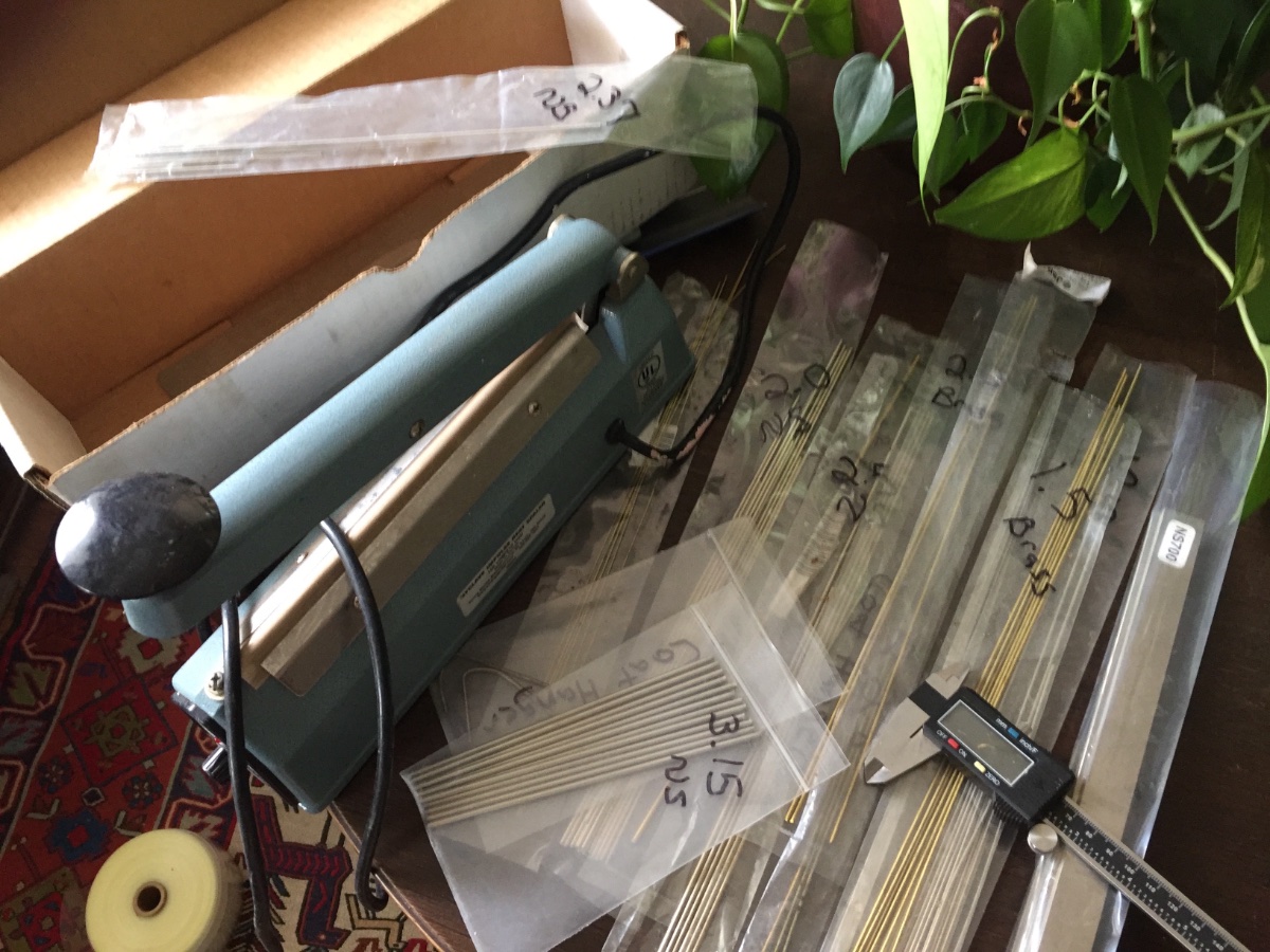

Old Cutler mentioned that he has trouble finding 0.082” pin stock. I buy K & S Metals brass pin stock in 0.081”. It comes in a package of three 12” pieces with the stock number of #8168.
Several months ago Wallace Rockwell, formerly of Camillus Cutlery, sold a bunch of 0.082” nickel silver wire. It was the same wire that Camillus used to make pins for their knives. I think he sold it in 25 foot rolls. You have to straighten it out but it’s a whole lot easier straighten out a piece of wire than cut a piece down on the drill press. I don’t remember what the price was that it was really very reasonable. I had tried purchasing brass and nickel silver wire from jewelry wholesalers before but even the hardest wire they had was too soft for use as knife pins. So I was very happy to get a roll of 0.082” nickel silver wire from Wallace. I don’t know if he has any more for sale.

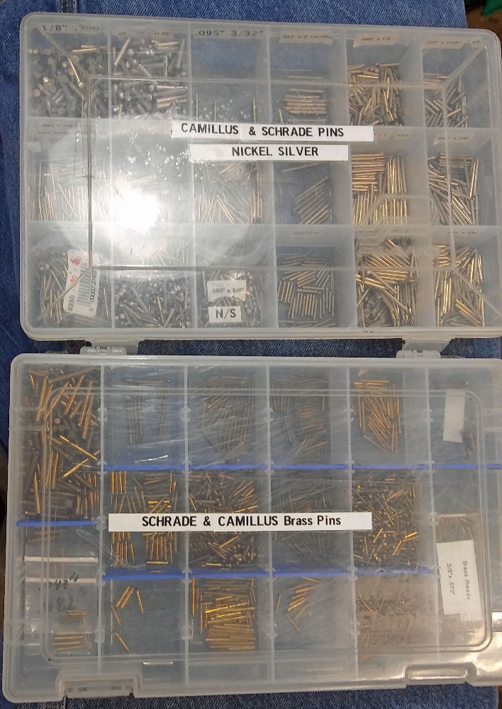

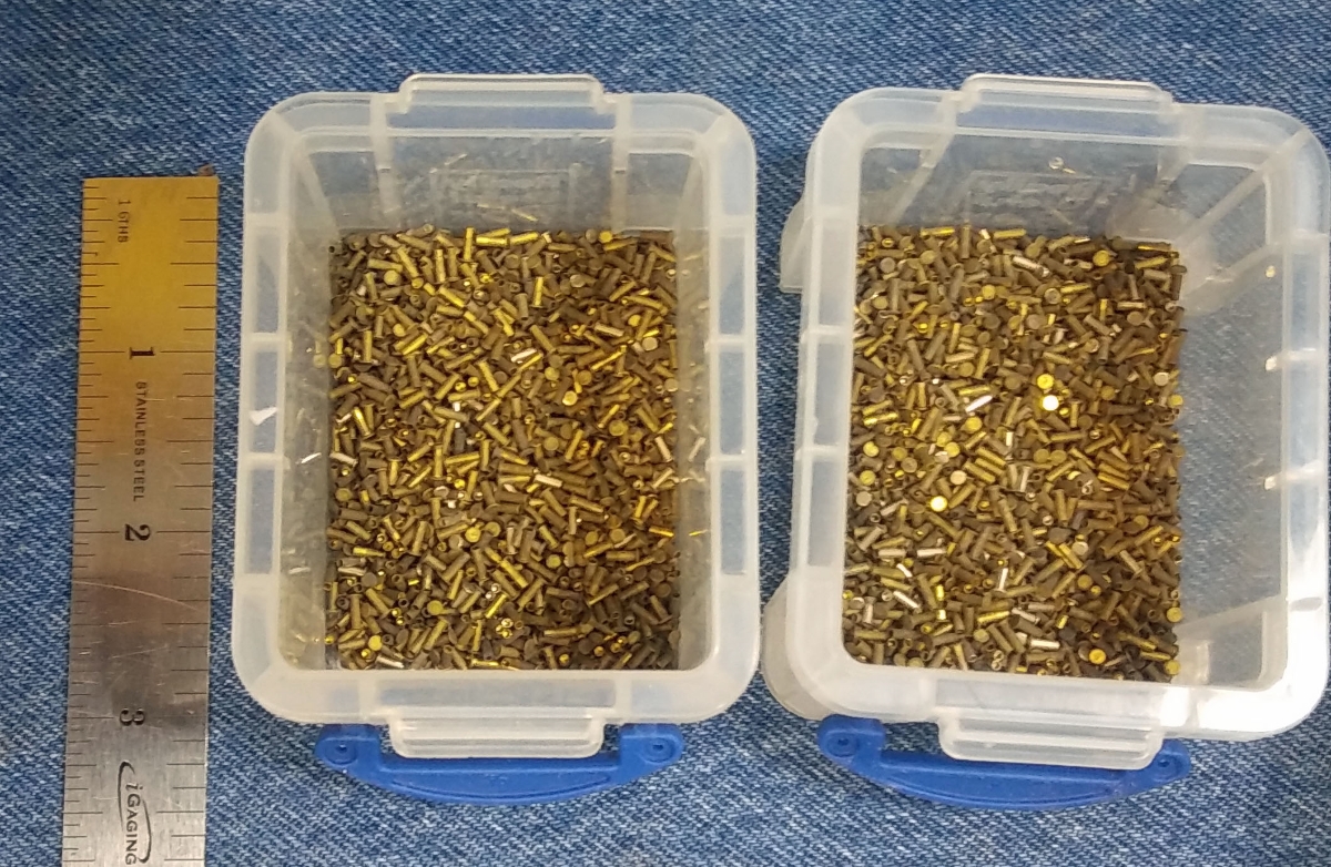

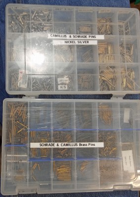

I have two tackle trays full of manufactured pins, one of nickel silver pins and one of brass pins. Many of these were purchased on eBay at the price of $7.99 for a bag of 50 pins. As you can tell there are many dollars in each of these trays, but it’s sure nice to pick up a pen that fits perfectly and not have to make a pin.

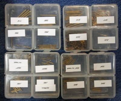

These little four-part plastic boxes are full of various sizes of pins I have premade by cutting them to length and spinning a head on one end.
These two boxes contain semitubular pins like those used by Schrade and Camillus to install Delrin handles that had predrilled holes. The small end of this pin is hollow and is very easy to peen down without leaving a lot of the material inside on the liner. Unfortunately, they don’t work really well with bone handles unless you drill a hole to recess the head of the semitubular pin inside the bone handle. Occasionally I find a use for these, but not often. They are valuable for repairing a knife with a loose Delrin handle.
I have other odds and ends of knife pins, but this is the majority of what I use.

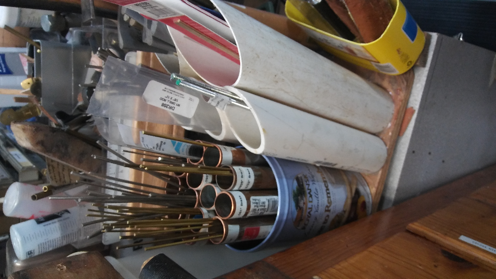

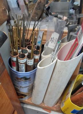

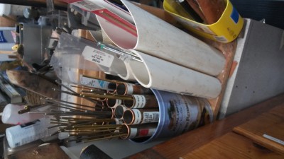

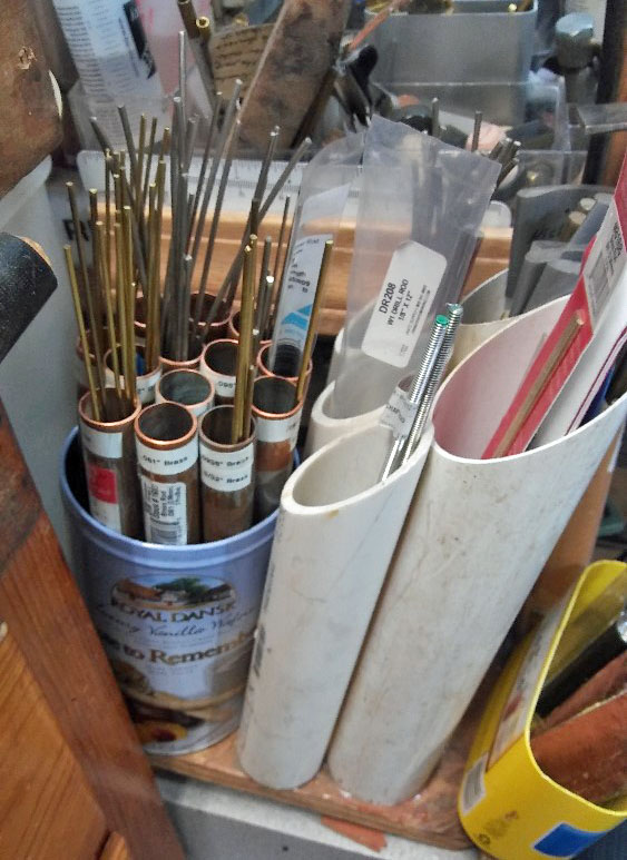

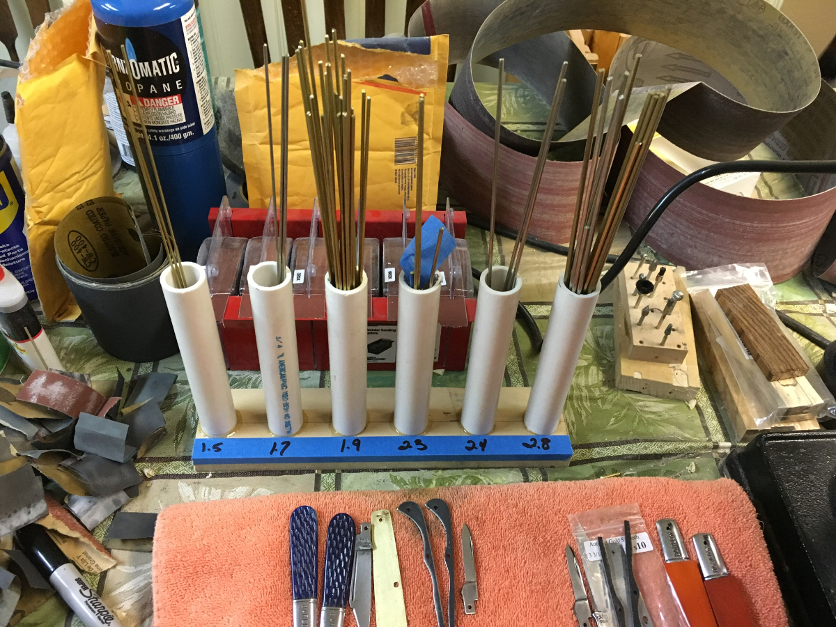

I had some stuff in the garage so I decided to make a quick organizer for my pin stock. Some 1" pvc pipe cut into 8" lengths, a piece of poplar wood and some epoxy and I'm organized for now. The blue tape is temporary until I can get around to determining the American standard sizes of the stock (as opposed to the metric measurements).

I love the PVC pin stock holder Jeff, way to make use of the stuff you have around the shop!
The reason I used copper pipe is because I had it laying around the shop. My neighbor was going to throw it away so I recycled it along with half a sheet of finished plywood and several other items. My neighbor doesn't keep things he has left over for use later on some other project; he tosses the scrap and buys new material for the next project.
But he is very generous to allow me to take his scraps.
Re: How Do You Organize Your Pin Stock?
I like to re-use things whenever possible. It saves me a few dollars and a trip to the hardware store. It's nice that your neighbor allows you to re-purpose his scrap. You can give something a second life and keep a few items out of the landfill!
Jeff
Jeff

I used a set up like that for years, works greatJeffinn wrote:I had some stuff in the garage so I decided to make a quick organizer for my pin stock. Some 1" pvc pipe cut into 8" lengths, a piece of poplar wood and some epoxy and I'm organized for now. The blue tape is temporary until I can get around to determining the American standard sizes of the stock (as opposed to the metric measurements).
I only switched to the boxes a year (or two?) ago

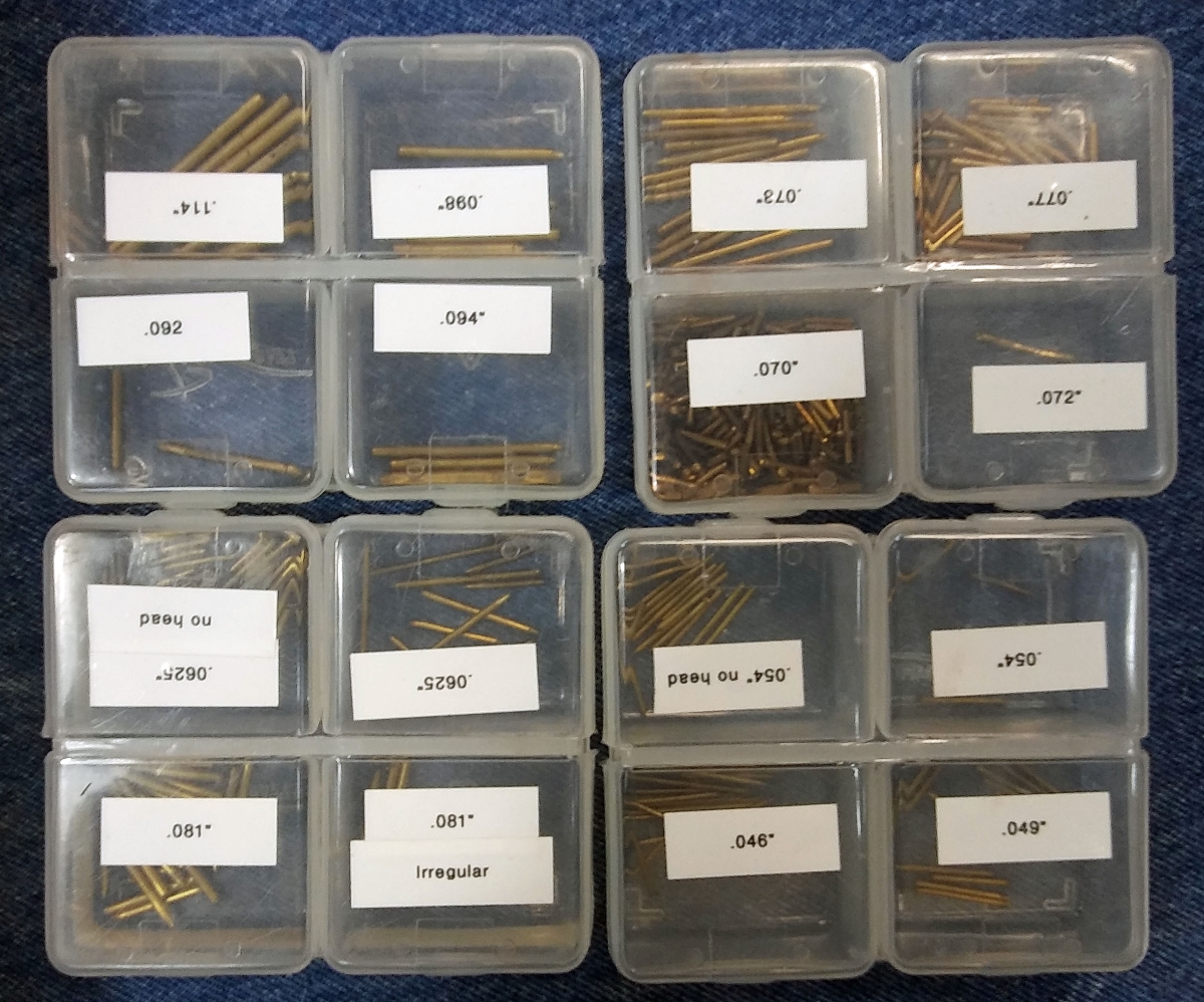

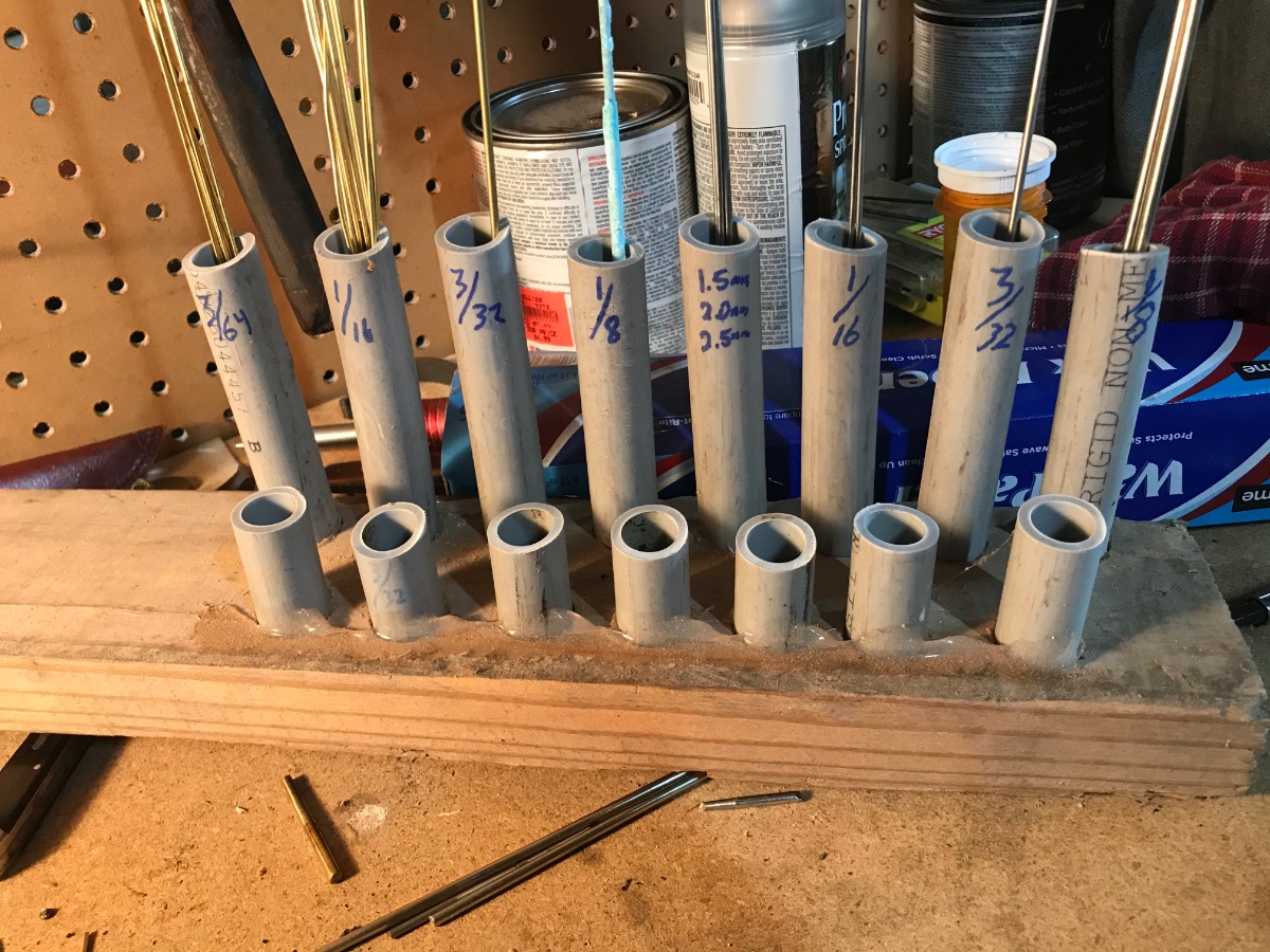

After seeing what the other guys had, I made some storage from an old 2x4 and some 1/2" PVC pipe.
It took me a while to settle on which sizes I need to stock, so I need to make a new one with separate compartments for the metric sizes.

My storage container looks a lot like yours Reverand. Only mine doesn't have the sizes written on the tubes. I probably need to be better organized but I just usually match sizes and move on. If I need a size in between 2 I have on hand, I take a larger size and thin it down to size.
If I ever get a real work space...where I don't have to carry my stuff out (and back in) to the porch...I'd like a set-up like that!
