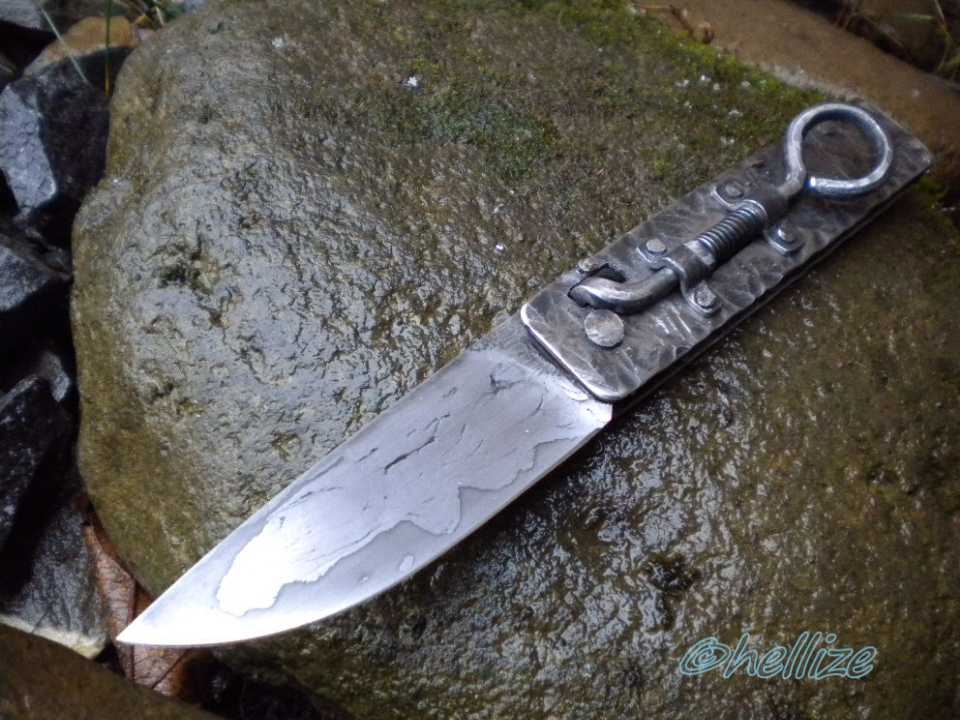

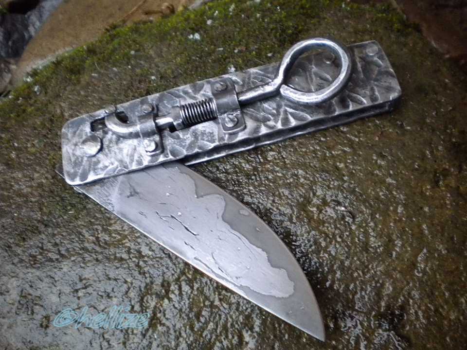

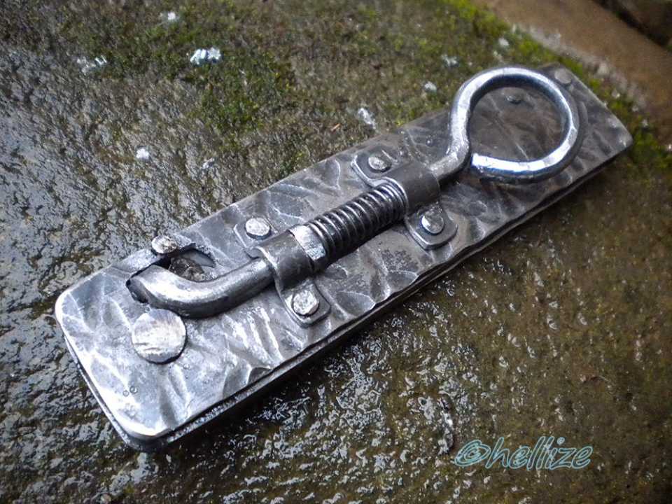

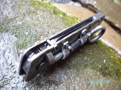

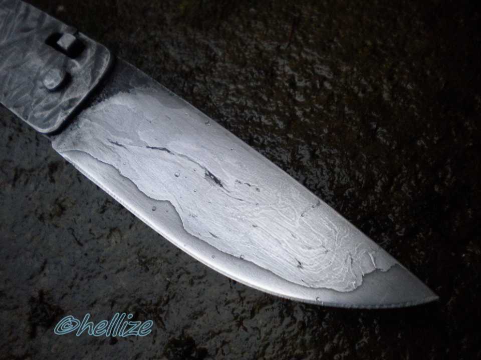

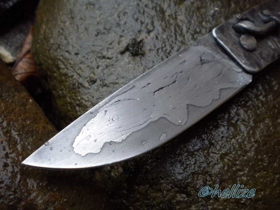

Good day,

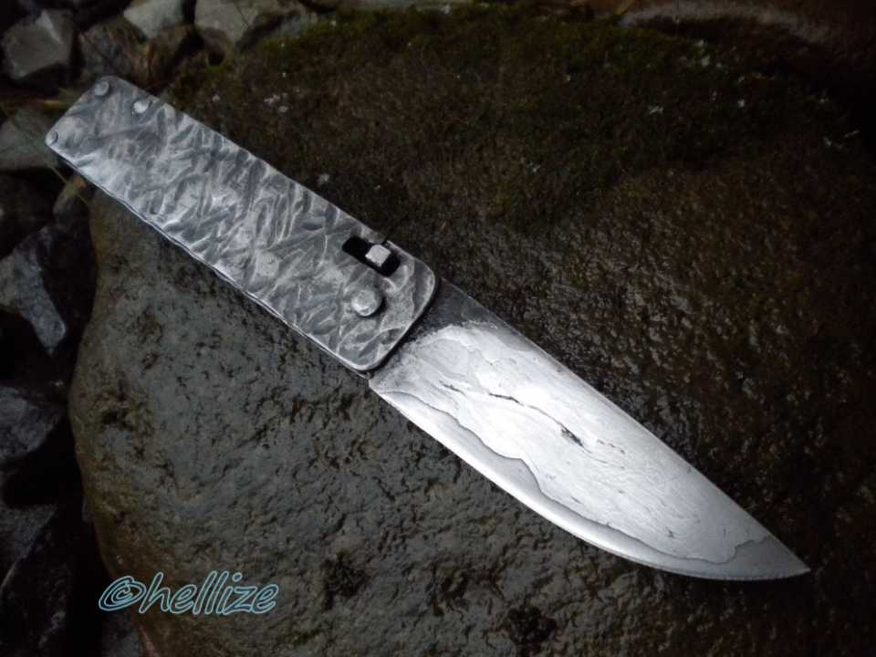

I am ready with another tinker's folder. It is 13.5 cm long when closed and 23.7 cm when opened. The blade is 10.2 cm long, 31 mm wide and 5 mm thick. It is a san mai, forged of barbed wire with a 5160 core. Unfortunately the weather is crappy and so are pics, sorry.
Hope you like it :)

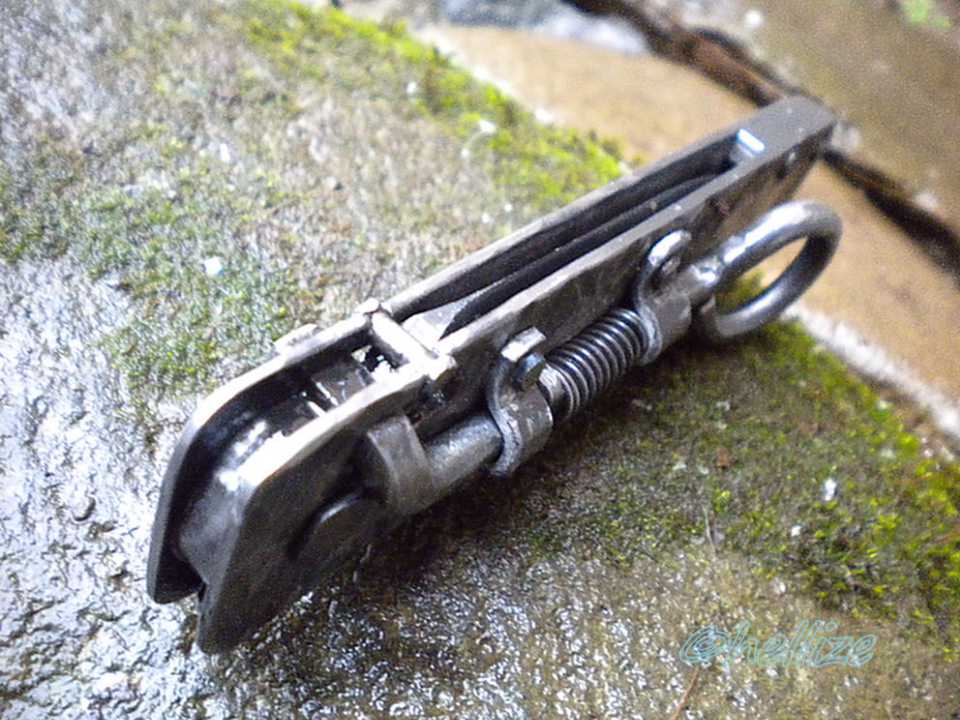

Interesting lock and release mechanism. Regarding the barbed wire: what do you mean? Surely you did not melt down wire to make the blade ...

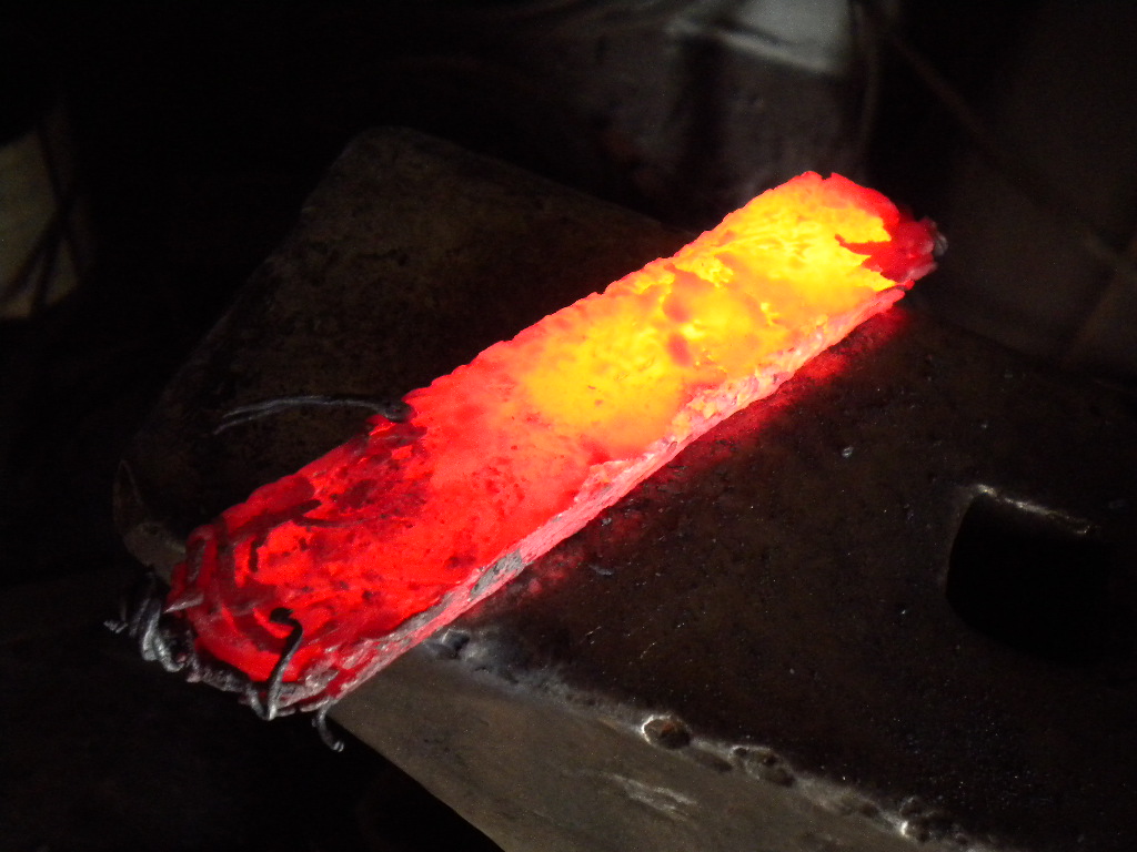

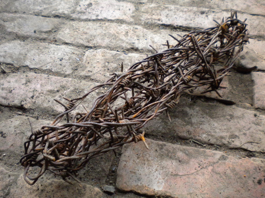

Dinadan wrote:Interesting lock and release mechanism. Regarding the barbed wire: what do you mean? Surely you did not melt down wire to make the blade ...
Thanks :)
Melting?? Don't be silly! Or course not.

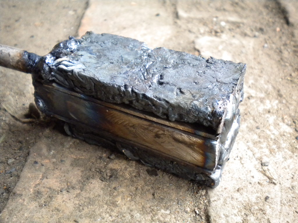

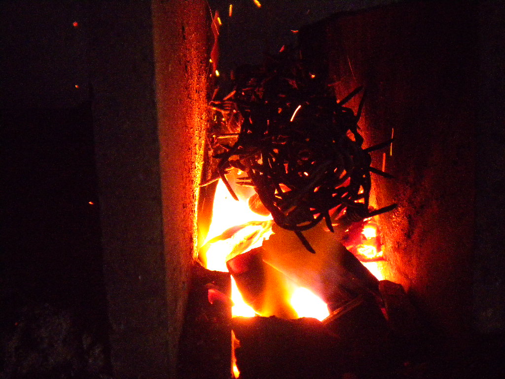

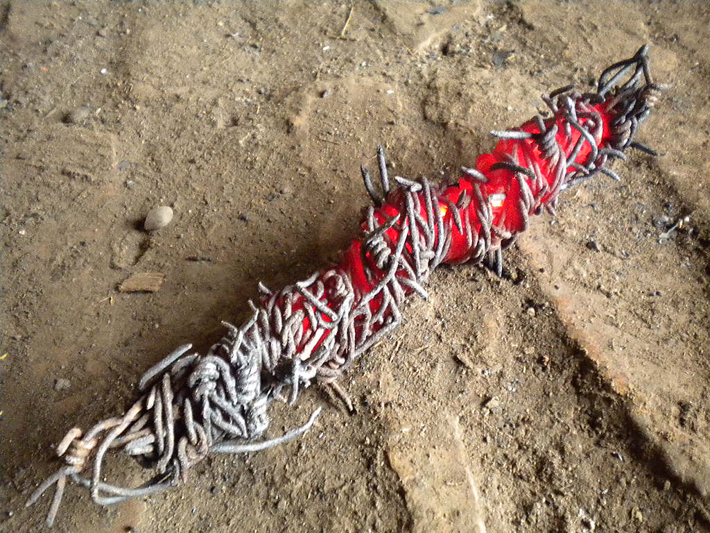

It is forge welded. A few wip's attached for enlightenment.
Thanks :)
Okay, I get what you mean. My Dad did some blacksmithing type stuff and showed me how I could weld steel by hammering it together red hot. Why you would use barb wire is another question. Anyway, the results look cool.
Thanks :)
Well, make that lemon yellow ;) red hot isn't enough.
I would use it for aesthetics of course!
