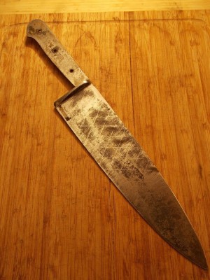

I've been doing filing and shaping with a sander on this knife.
It is a big old heavy French Chef's knife. Ten inch blade and about a pound in weight.
The knife has been ground somewhat by the factory already.
It is already tapered and roughly shaped with no edge when I received it.
This metal is very tough.
Probably the hardest I've sanded including known heat treated knives I have worked on.
The holes for the pins are already drilled also.
I think it was treated . We will see as I am going to use it without handles when I'm done the finish and see how the razor sharp edge I put on it holds up.

Can you post a picture of the knife?

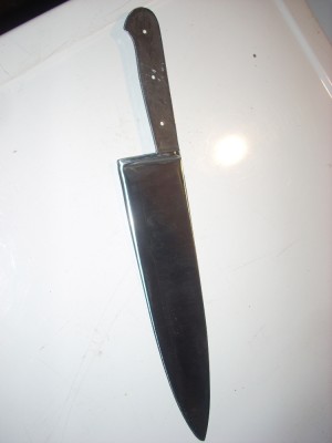

I was told by a Company that heat treats custom knives that to try and drill a inconspicuous hole with a sharp bit in the tang where the scales will cover.
If it is hard to drill and skids around the knife was most likely treated.
If it is very easy and the bit grabs right away the knife needs treatment.
I used a new bit and it was difficult to drill and dulled the bit quickly.
In my opinion this knife was treated and is hard enough for use in my Kitchen.
:BEFORE: :AFTER SOME FINISHING:
"I put a convex edge on it"

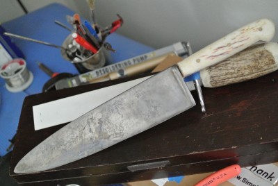

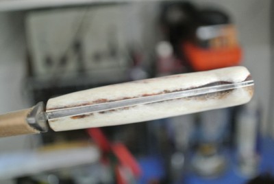

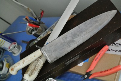

Re: heat treated?

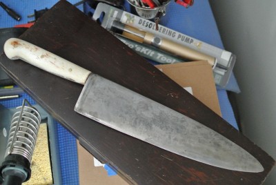

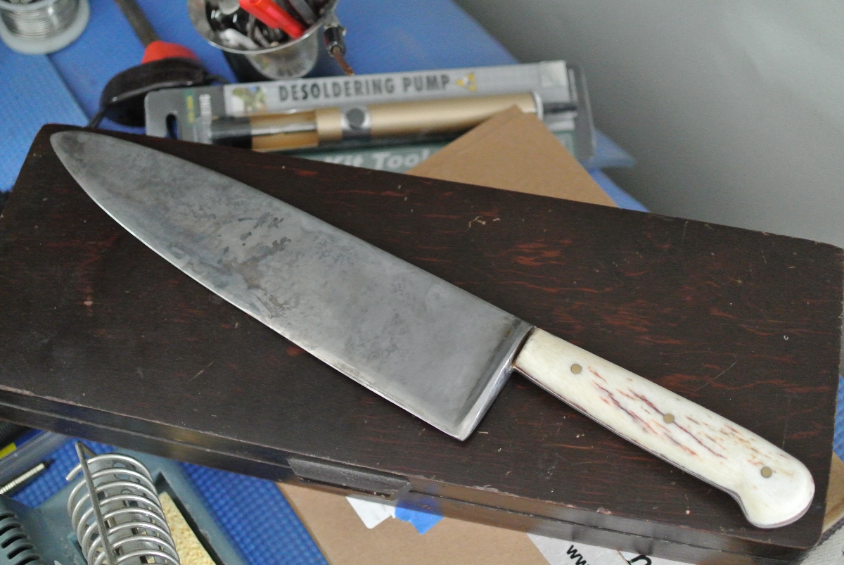

Well I ended up getting real busy.
For almost a year!!!...BUSY...... and never got back to this knife or any other since.
Now that I stopped working for awhile to take full time care of My Father I'm finding a little time to create knives again.
This knife sure comes in handy now that I'm Chief cook and bottle washer around here too.
I have been using the knife for a month or so and it's been sharpened only once but I give it a few strokes on the steel before using every night.
Razor sharp...............always~

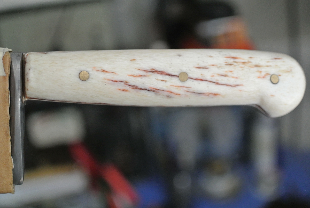

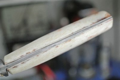

Old World carbon steel with giraffe bone scales and white nylon liners attached with hand peened brass pins.
(no epoxy this time)
After the initial blade grinding everything was done by hand with files and sanding blocks.
"Same approach with the scales after peening" Too stinky of a substance to use a sander.
Just a coping saw, files and block.
I didn't go too crazy with the finish as the knife will see constant use.
I was a little worried about the tang as it had a slight bend in it.
But my assumptions were right that installing the scales would pull out the bend.
$75.00 dollars in materials including the 20 buck price for the blade blank.
Plus many nights filing and sanding here and there while watching TV over the last few months.
I guess the knife could be called an "antique factory custom kitchen cutlery knife".
"She's a keeper"................
