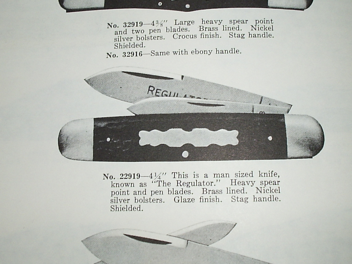

Re: new blades/ old handle?
Post by patch1 »
Wrong on all accounts.Cobbled together for sure.
The main blade is out of a regulator.
I can't find a handle of that length that belongs to a Catt.
Lack of any worm grooving bothers me.
The location of the pivot pin so far out on the bolster is suspect also.
Adding a picture of a true 22919.
Patch1

Post by peanut740 »
These Catt`s pop up quite often with those unfinished blades.Sometimes the patterns are correct,but usually not. ::td::

Post by tongueriver »
Lots of good information here; I learned something (until the short-term memory loss kicks in); thank you all. I think that knife would be an excellent user, but not for that price. I would jump @ $80. Meanwhile, I have several authentic Cattaraugus folding knives that do not have the Indian Trails or worm-groove type jigging. My understanding of that wg style, btw, is that it was purchased from Rogers Bone.
