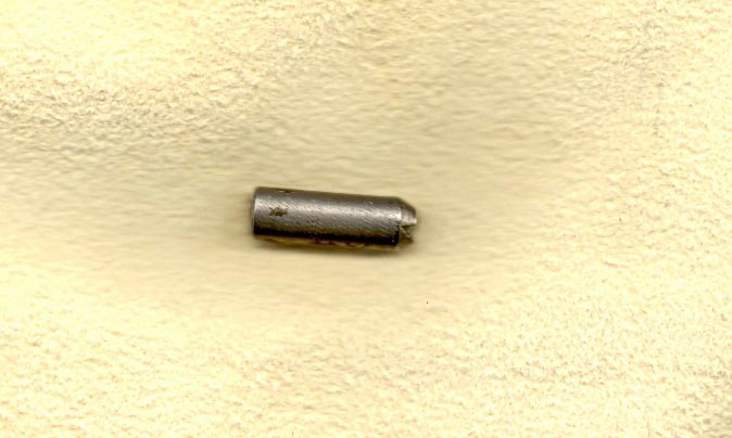

Here is the Camillus pin spinner that Tom sent me.
It works great!
Thank you Tom!
I will post more later when I get time.
The length of the spinner is ¾ inch.
It works great!
Thank you Tom!

I got my spinner from CAMCO in the mail a couple days ago (thanks Tom) and WOW! It works great! I used it on a remington rehab I was doing and it spins nice big uniform heads with ease.
Hukk,Hukk wrote:Is there a drawing around that I could get to see if I could have some made? That would be great to have!
I don't have a drawing & I can't get a better scan than one I posted.
But if you are coming to the OKCA show in April, remind me to bring the Camillus spinner & I will show you how to make one for yourself.
I made a couple and a bigger one for larger pins. They work very well. Much better than the ones you can buy from the supply houses.

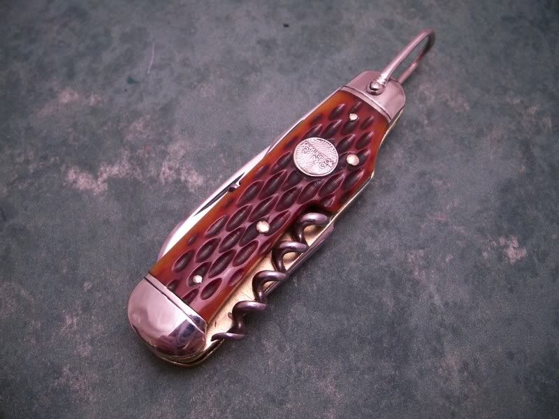

used Tom's spinner on this old Remington, worked like a charm, nice big shiny uniform heads
