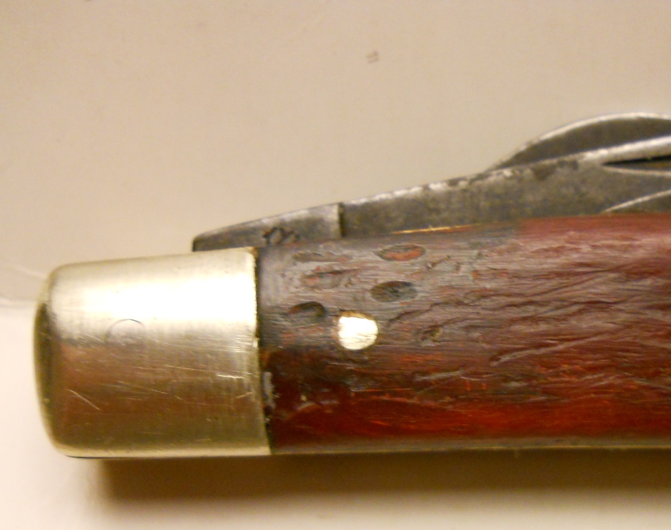

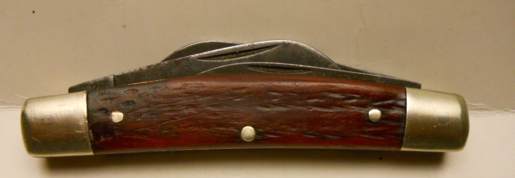

Duh. I happened to think after that last post that I had a knife here that the guy patched. 4 blade German Boker congress knife with red bone handles. I looked for a handle for a year and gave up on ever finding one. This isn't a perfect color match on this. With black or very dark colors the guy can match them dead on and that is the key to a nice repair. Look at the upper left corner of this knife. Super glue, leather dye, rough shape with nail, Dremel.

just bob wrote:Duh. I happened to think after that last post that I had a knife here that the guy patched. 4 blade German Boker congress knife with red bone handles. I looked for a handle for a year and gave up on ever finding one. This isn't a perfect color match on this. With black or very dark colors the guy can match them dead on and that is the key to a nice repair. Look at the upper left corner of this knife. Super glue, leather dye, rough shape with nail, Dremel.
thats a very nice patch job. I would be interested in knowing what brand of glue and leather dye he is suing. The superglue I use tends to gum up instantly whenever any kind of pigment is added to it.
