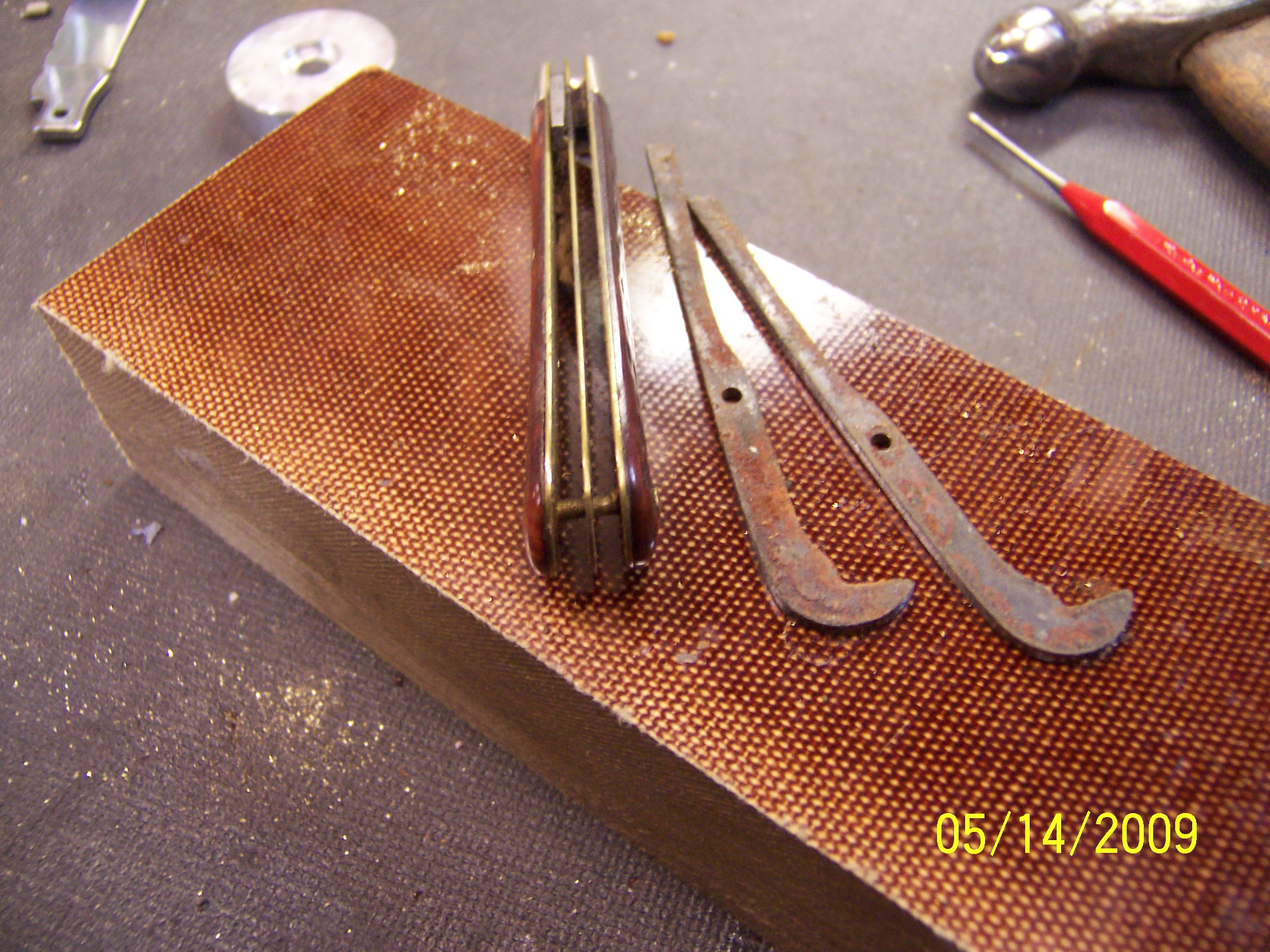

Taking Knife Apart
1- Start with the knife, file & a spring loaded center punch. Pic #1
2- File the head of the rocker pin and rear pin flat. Using the spring loaded center punch make a deep enough indentation to start a 1/16” drill in the rear pin, rocker pin & pivot pin. Drill deep enough in pivot pin to reach about the center of the pivot pin. Pic #3
3- Using a Dremel, Foredom or other rotary tool, remove most of the head of the rocker pin. Pic #4
4- Open blade(s) of the knife and place in a spring compressor (Camillus type knife vise) to compress the back springs. Using a 1/16” pin punch tap out the rocker pin, releasing the spring pressure in the knife. Pic #5
5- With a rotary tool, remove most of the head of the rear pin. Pic #6
6- On this knife the rear pin did not go through the ends of the back springs so the springs came out at this point. Most knives have a hole through the end of the back springs that the rear pin goes through. It is necessary to drive this pin out with the 1/16” pin punch, or cut it with a razor blade to remove the springs. Pic #7
7- Drive out the pivot pin with the 1/16” pin punch, or cut the pivot pin with a razor blade. On this knife the pivot pin was small enough that drilling into the pin weakened it enough that the pin broke. Pic #8
8- Using a small hammer, drive the pivot pin from the inside back out. This is necessary in most cases as the hole for the pivot pin is tapered to prevent the pin from coming out. File down about ¼” of the outside end of the pivot pin. Pic #9
9- Using the spring loaded center punch, drive the pivot pin back in the hole. You can use the 1/16" pin punch for this, but you must be careful not to mushroom the head of the pin. I find the gentle action of the spring-loaded center punch is usually more than enough to push the pin back through tapered hole. Pic #10

Cleaning Up The Parts
1- Clean the gunk off the insides of the liners & polish the liners. In this case I just buffed them with a Scotch Brite wheel. Pics #11 & #12
2- Since I am changing the knife by removing a blade from the knife, I engrave my initials and the year on the inside of the mark side liner. Pic #13
3- Clean the rust off the back spring you will use when reassembling. Pic #14
4- Clean the blade on a Scotch Brite wheel. Pic #15

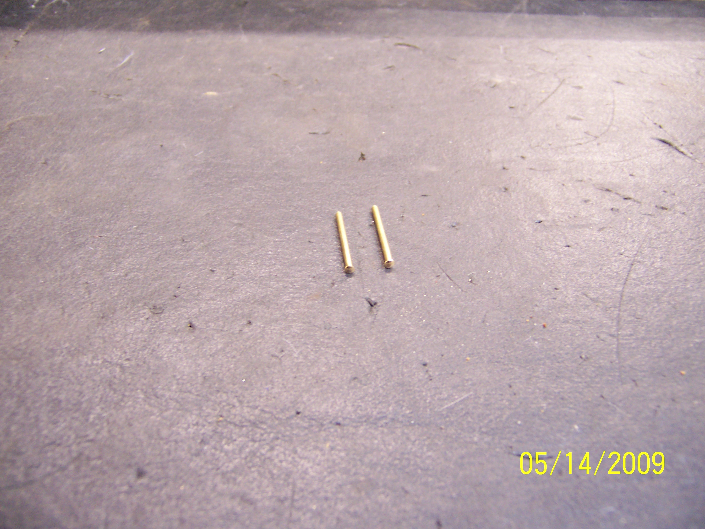

Reassembly
1- 1- Make two brass pins about 1” in length to fit the rocker pin hole & the rear pin hole. On this knife they were both 0.070” brass pins. Be sure one end is flat, (I run this end on my belt sander to ever so slightly take off the sharp edge by holding the pin lightly against the belt at a 45degree angle to put a very slight shoulder on the flat end- you can do this with a file & sandpaper), and the other end is tapered. Pic #16
2- 2- Place your pin spinner in the drill press and the pin stock in the vise with about as much sticking up as the diameter of the pin stock. Pic #17
3- VERY IMPORTANT- Use a heavy lubricant on the spinner. Pic #18
4- Spin the head on the pin. Pic #19
5- Make two pins like this. Pic #20

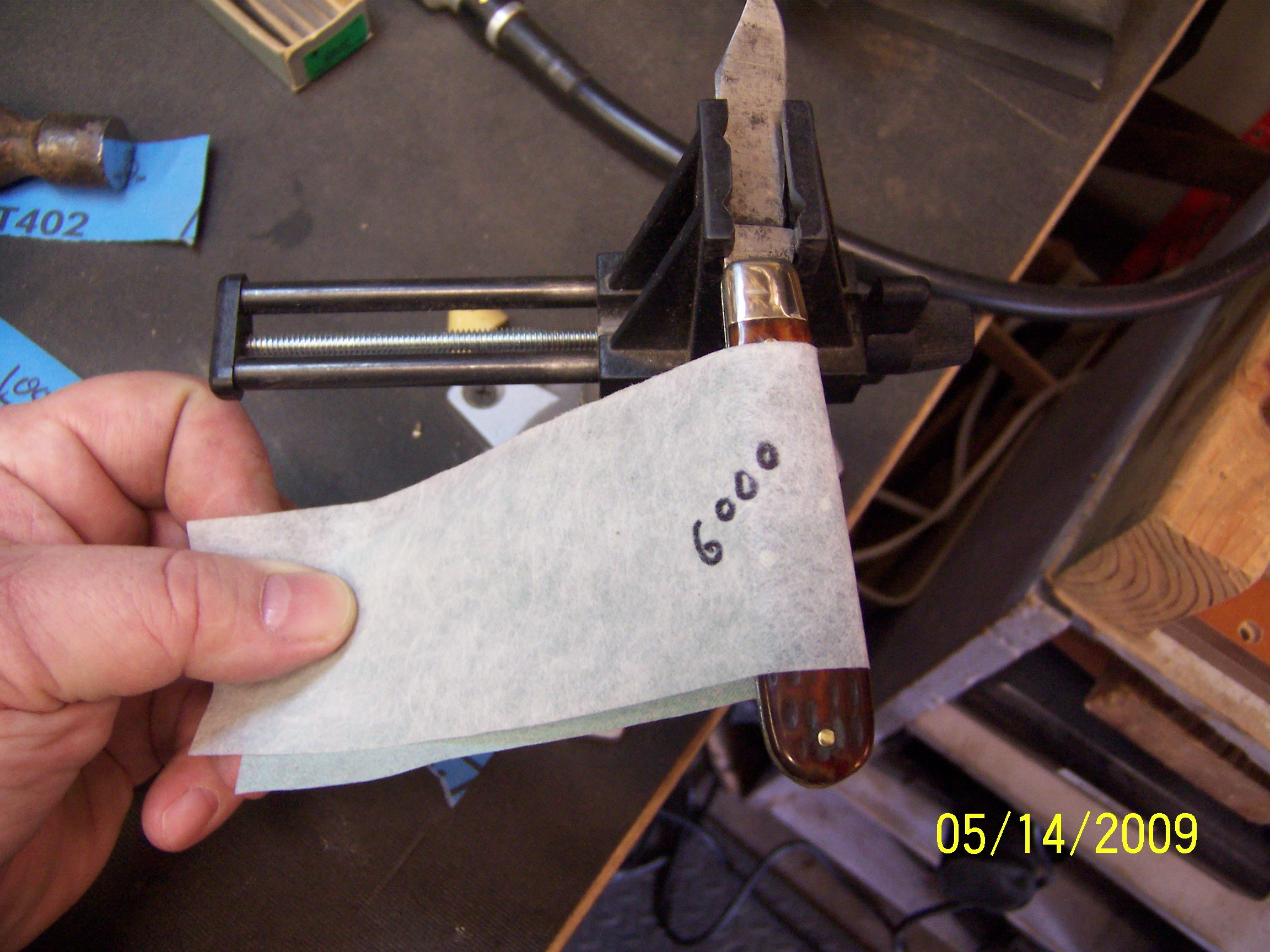

Finishing Touches
20- I use micron paper in 4000 grit (3 micron), 6000 grit (2 micron) & 8000 grit (1 micron) paper on the bolsters and the handles to give the knife a nice smooth finish. Pic #35
21- I finish off by buffing the handles & bolsters with No Scratch Pink compound on a loose muslin wheel. Pic #36
