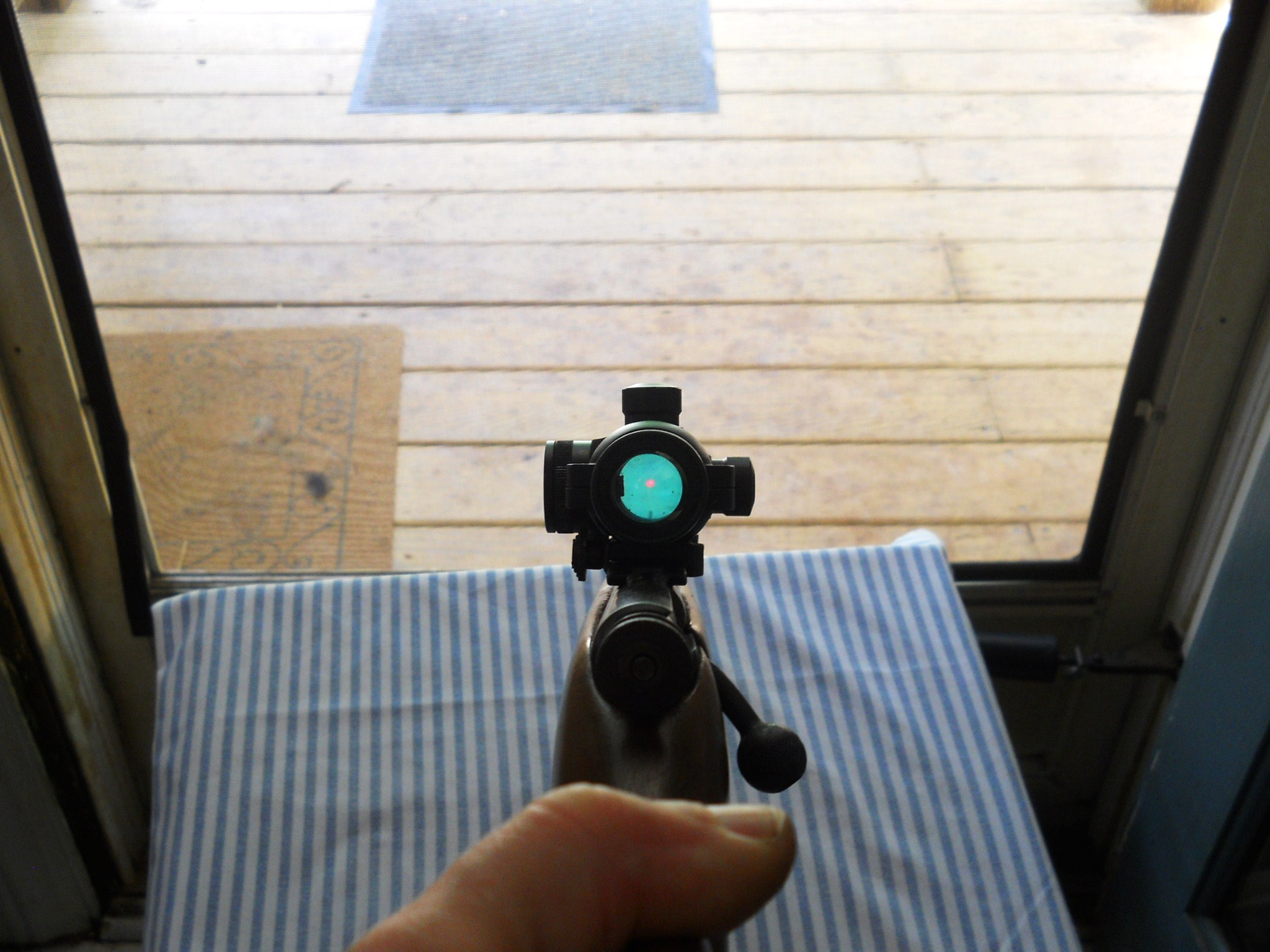

Problem solved! ::ds::
I had the rail .100 above the barrel. I simply lowered it to .050 and was able to catch some threads with the original screw! ::nod::
Thanks for the idea, Jim! Re-taping probably would have been my next step (I really wanted to keep it all original if possible though) ::tu::
Thanks for the help, guys!!!
Now the fun part..... sightin the old plinker in ::woot::
Couple of pics below
...... Joe
