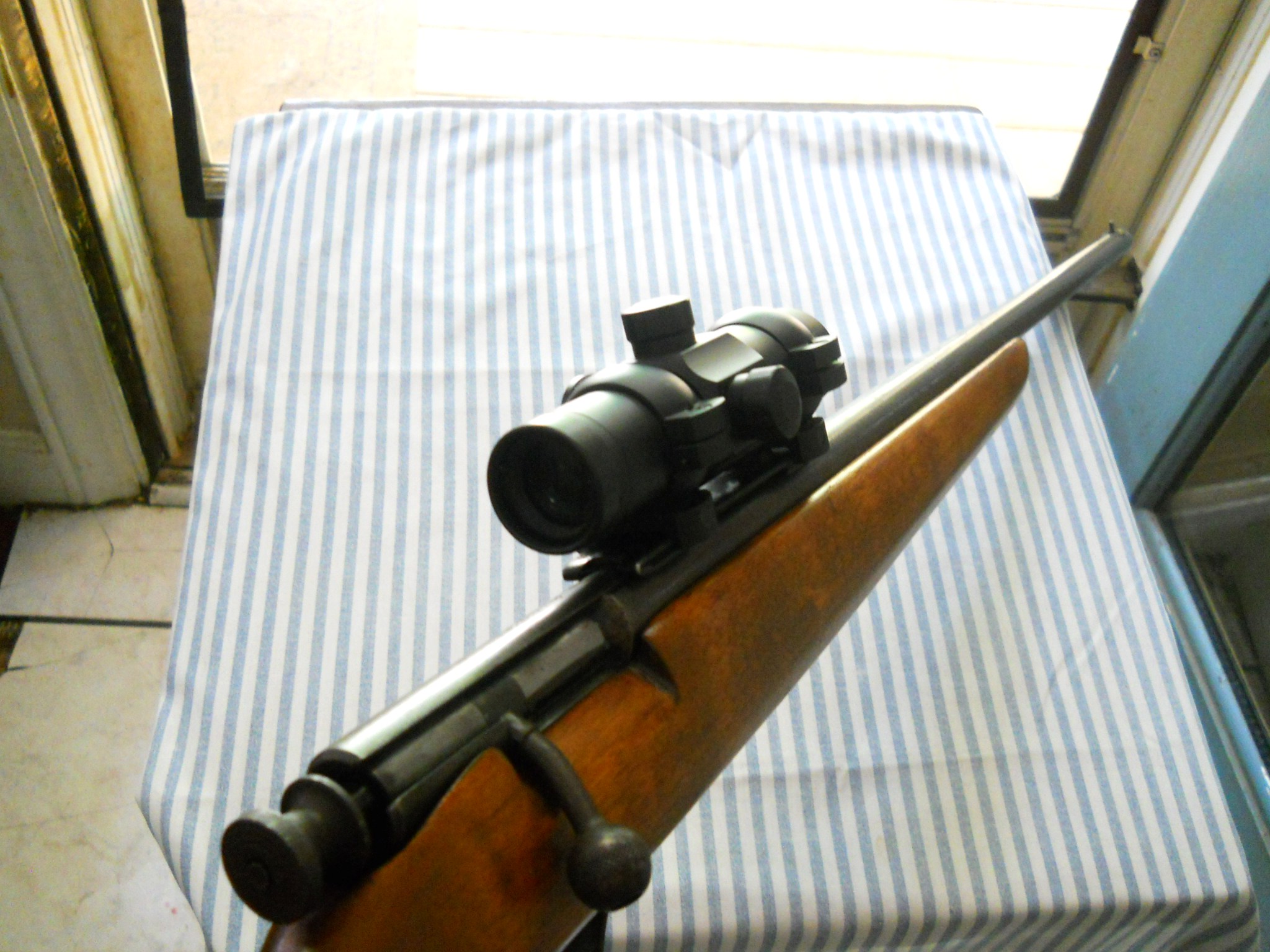

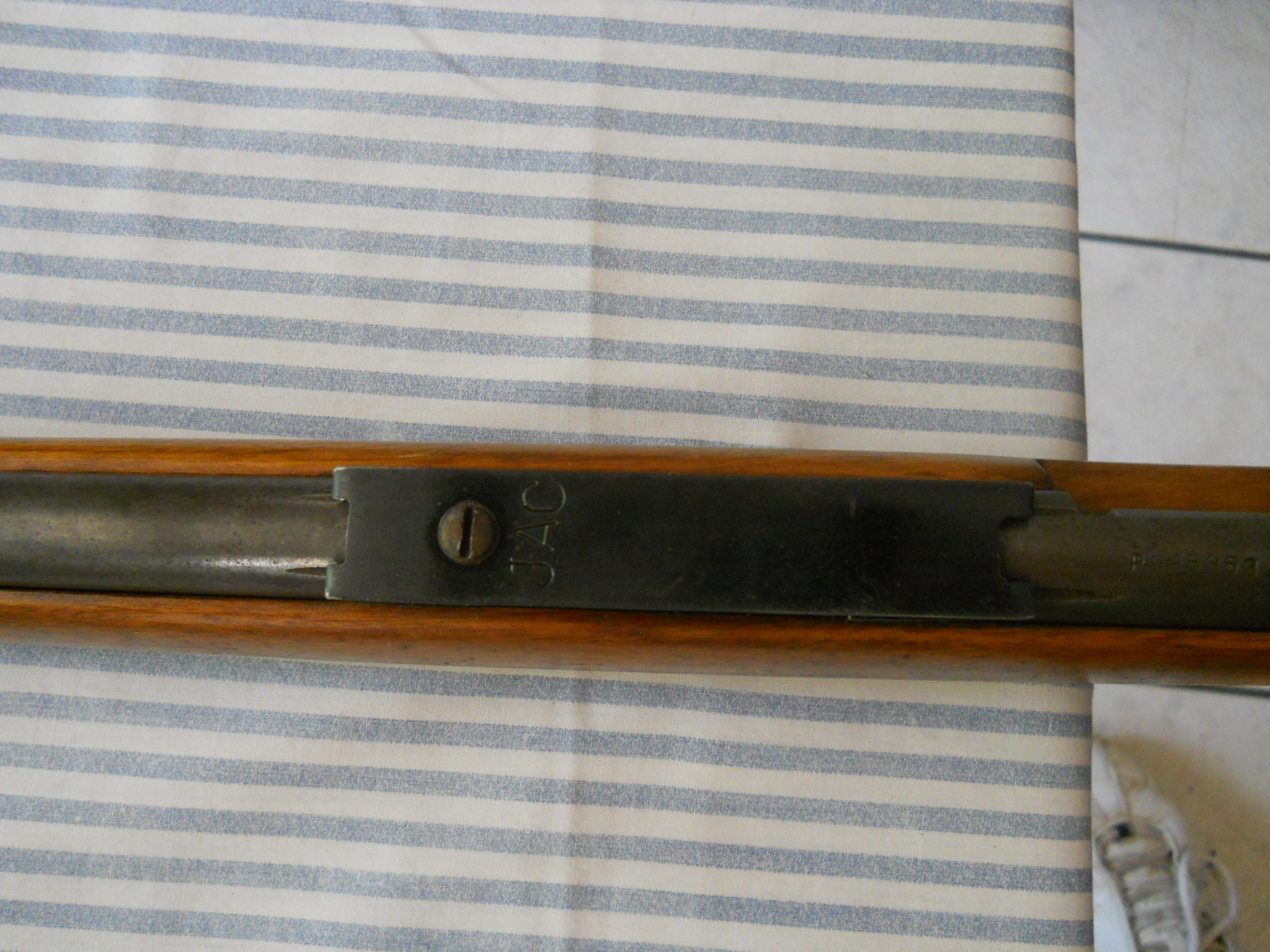

Hay folks, I'm in need of an odd ball screw to attach a scope/dot-sight mount to an old Savage .22 rifle.
It's got a 1/4" x 32 tpi hole in the top of the barrel where the rear sight mounts. The screw that held the sight on is too short to bolt on the rail I made.
Unfortunately, no one in town can even order one for me! Can't even find one on the net!!! ::shrug::
It needs to be 1/4-32 x 3/8'' long minimum.
This is the closest thing I have found, but would prefer to find one I won't have to alter..... it needs a head on it.
http://www.weldfabulous.com/Smith-Wdw77 ... 14588.html
Any help will be much appreciated!
..... Joe

Problem solved! ::ds::
I had the rail .100 above the barrel. I simply lowered it to .050 and was able to catch some threads with the original screw! ::nod::
Thanks for the idea, Jim! Re-taping probably would have been my next step (I really wanted to keep it all original if possible though) ::tu::
Thanks for the help, guys!!!
Now the fun part..... sightin the old plinker in ::woot::
Couple of pics below
...... Joe
