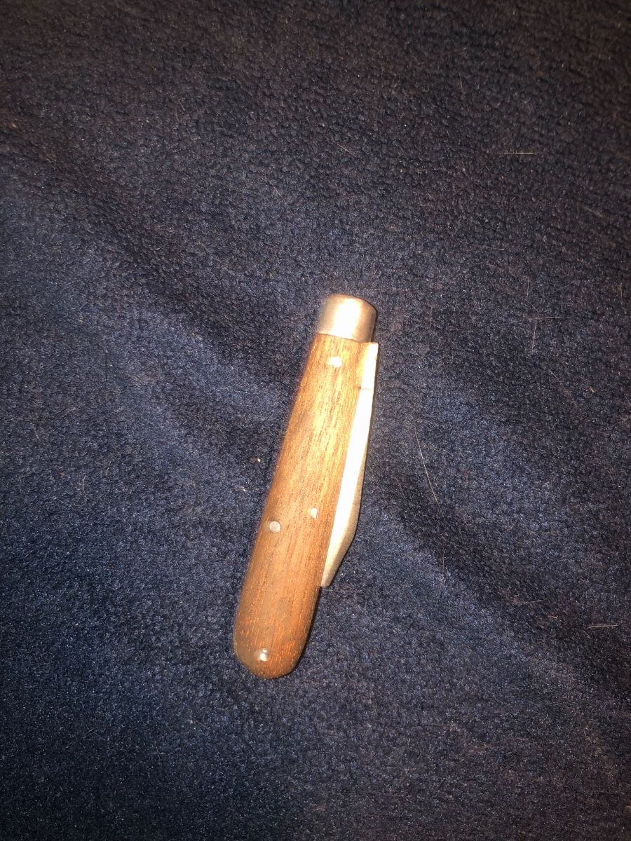

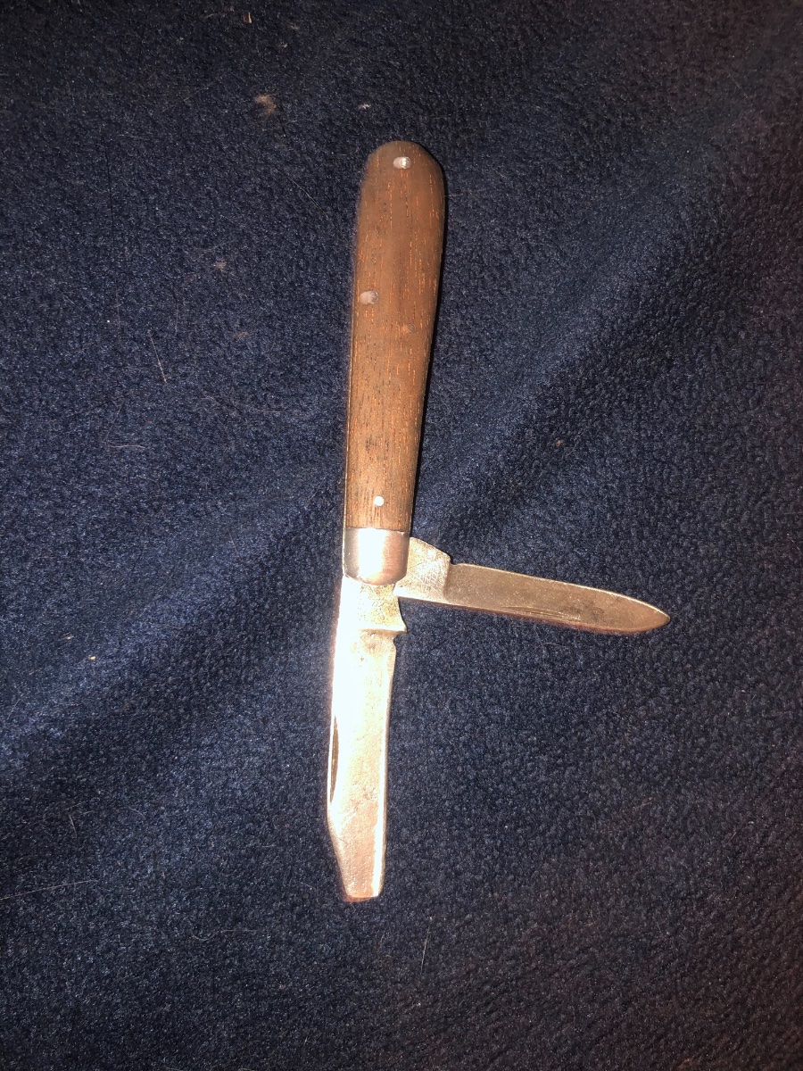

Hello! I am a 15 year old aspiring “knife mechanic” if you will, with a nice little workshop packed in a one car garage. Recently I attempted to re handle this old keen kutter, the celluloid scales were horrendous, but I could tell this was a well loved knife as the main blade was reground into a screwdriver. There are some gaps, and looking at them makes me want to throw it out a window, but hey, it was a good learning experience and it’s still a solid and functioning old jack knife. Here are a couple pictures I thought I would share.

Cooter wrote: Tue Aug 31, 2021 2:21 pm Hello! I am a 15 year old aspiring “knife mechanic” if you will, with a nice little workshop packed in a one car garage. Recently I attempted to re handle this old keen kutter, the celluloid scales were horrendous, but I could tell this was a well loved knife as the main blade was reground into a screwdriver. There are some gaps, and looking at them makes me want to throw it out a window, but hey, it was a good learning experience and it’s still a solid and functioning old jack knife. Here are a couple pictures I thought I would share.
Hey, it's still functional, right? And you pinned everything through also! Most on their first knife don't pin the covers (myself included). It's all about getting up the courage to take the darn thing apart in the first place.
Looks pretty decent from here. Get in there and do another!
