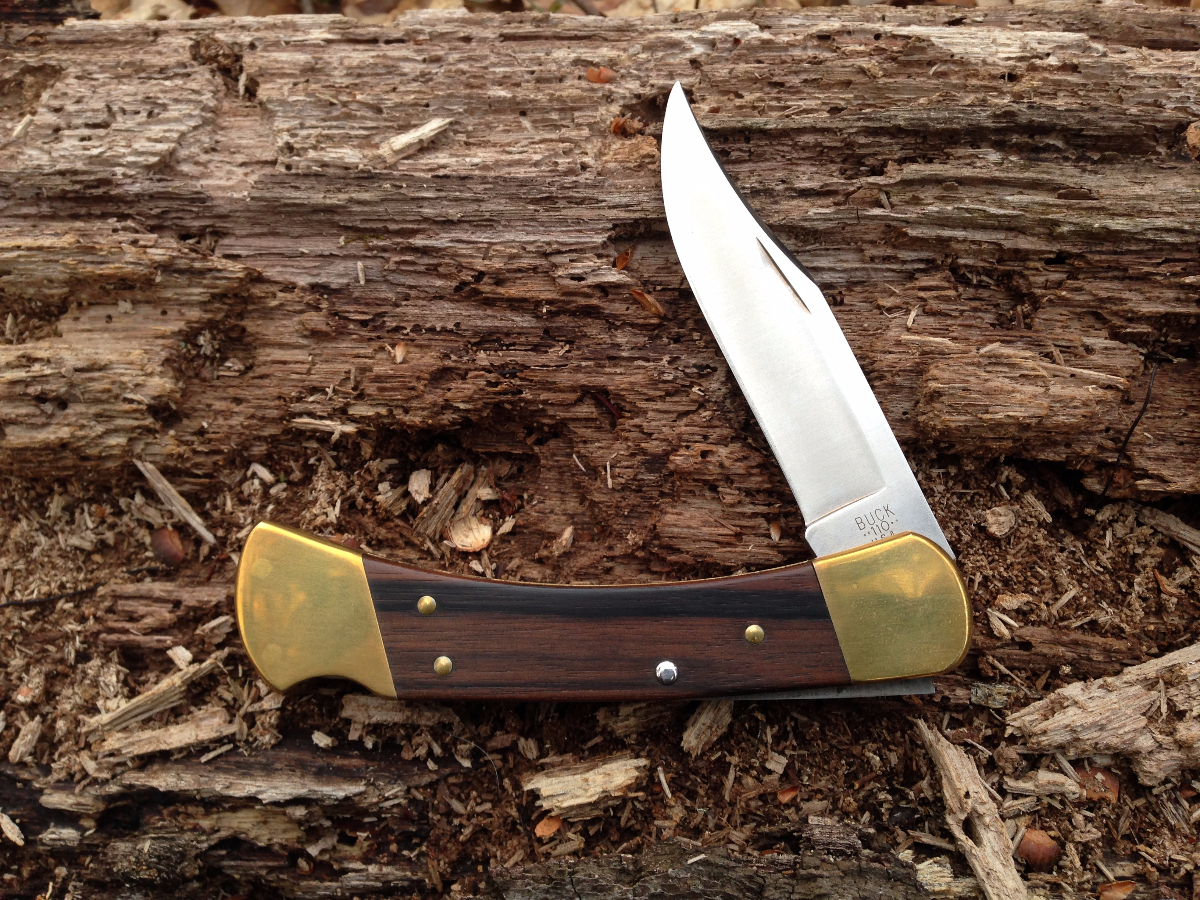

..110.. 1981-1986 the blade steel was 425 mod..
Re: Buck 110 4dot year ID help
thanks garddogg56...is there any way to pinpoint the exact year within that time span?

G Michael, you have a later Four-Dot, so closer to 1984/85. Your knife has a radiused edge. The early period Four-Dot Model 110 knives had the same blocky (square) edges as the Two-Dot knives. OH
Thanks so much for dating my Buck! I shined it all up, what a knife. Now another I see myself collecting.
Hi again
I just looked at the pictures it sure looks like a 82 with a hand done radius on all of the brass except the cut out, I must have had well over 100 of them, I also thought you may want to know why Buck used 425m instead of their famous 440c , it's because you can't fineblank 440c and Buck re tooled to fineblanking tools after 1980 ,just a few things for you to research
