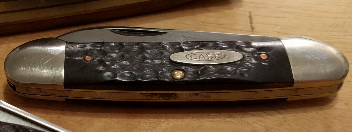

The Copperhead pattern is a pretty good choice for pocket-protection. I've also had great luck with my 6318PU, which dispenses with the spey for a punch and, while not sporting fully-sunken joints, has a Turkish clip blade and a reduced stockman profile that meets next to no resistance going into or coming out of the watch pocket. I also have a "pocket-worn" 6318 with the spey that doesn't fray my fibers in the slightest. There is a little room to file down the kick on the sheepsfoot without issues, as well.

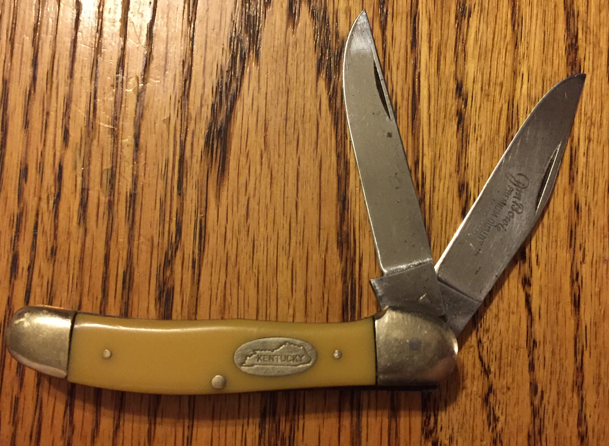

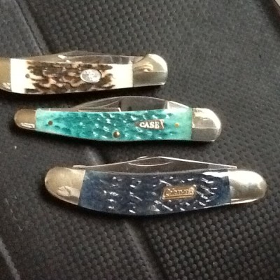

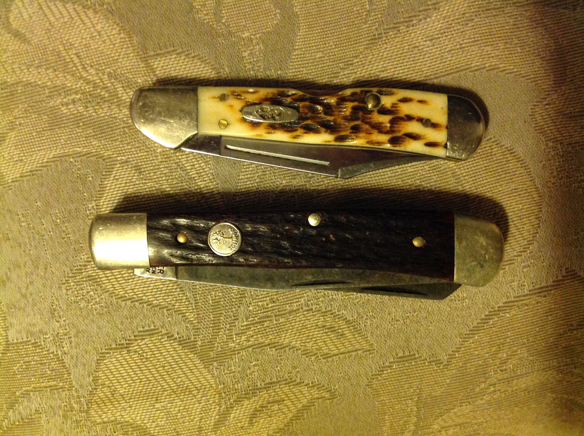

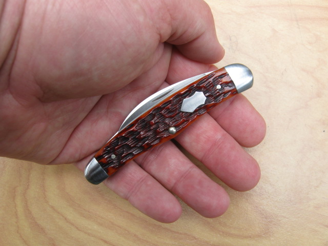

Edgewise, I like the Case Copperlock as a comfortable and useful EDC knife. It is a single blade knife that comes with a clip blade or a wharncliff blade. There is a mini version (3 5/8) and a regular version (4 1/4). It has a very slim profile and a copperhead bolster that covers the tang edge. It is available in a large variety of handle materials.

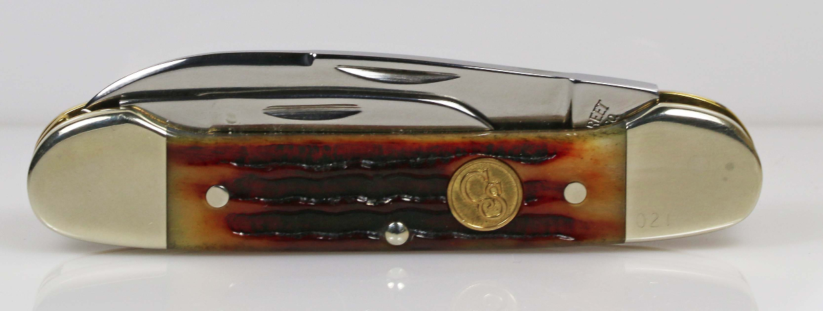

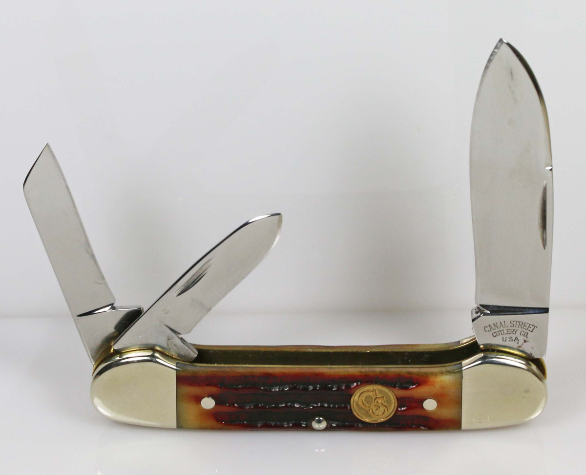

Canal Street made a knife called a Cannitler that might also interest you. It has 3 blades (spear, spey, sheepfoot) in a canoe-like frame. These are a little difficult to locate since Canal Street shut down. I enjoy carrying this knife.
In the pictures below you will see the tang on the copperlock is completely covered by the bolster. On the cannitler the tang peeks above the bolster ever so slightly. If you fidget with stuff in your pockets you will notice this, but I doubt it would be a serious wear & tear issue for you pants pockets.

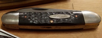

You may also have luck with 70s-era Case 62191 canoes, which are single-spring and have both tangs covered up by the bolsters. They are plentiful on the secondary market, vanish in the pocket and fit in most watch pockets easily. I didn't really have a good angle on my 4-dot brown bone canoe while closed, so I'm including a photo of a 90s-era (twin-spring) 62191 closed to show its profile.

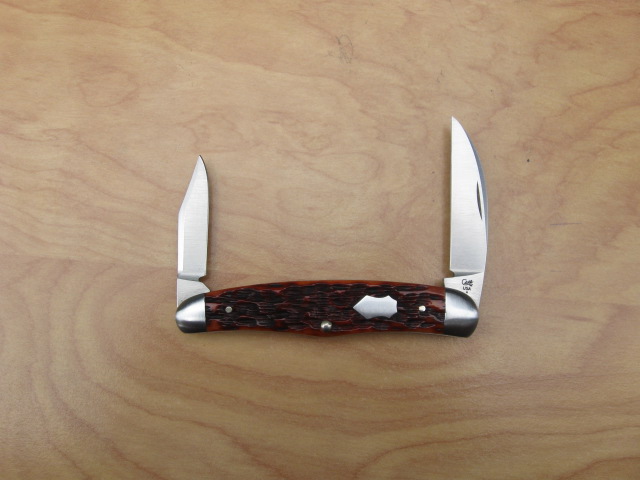

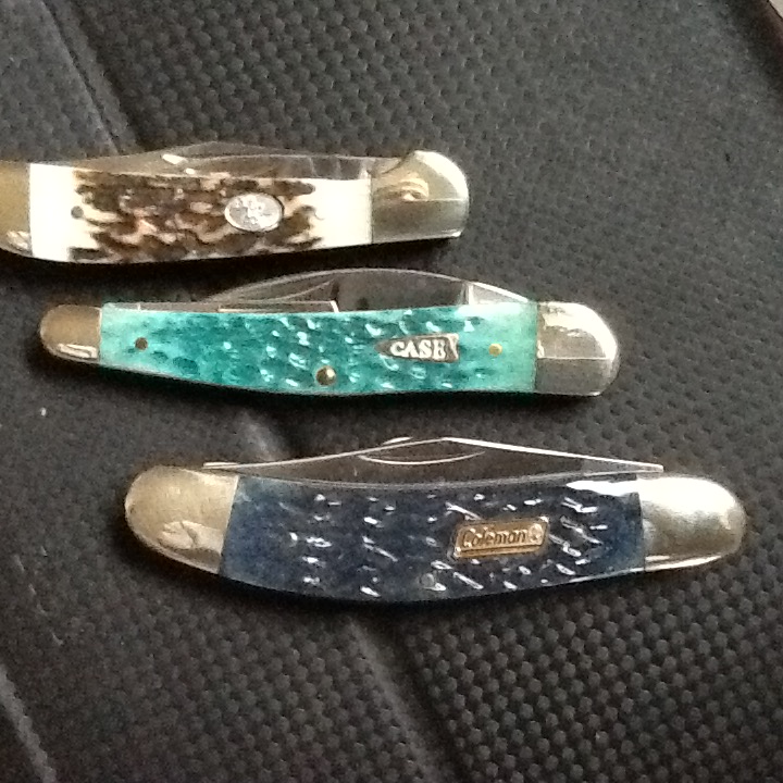

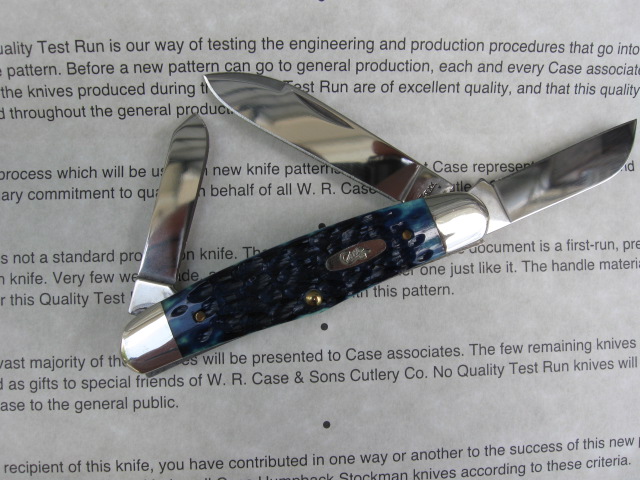

I don't have answers to most of your questions but what you are looking for is knives with sunken joints. I'm not sure what a Google search would turn up as sunken joints are rarely, if ever, part of a knife's description on dealer pages. You might try a Google search though.

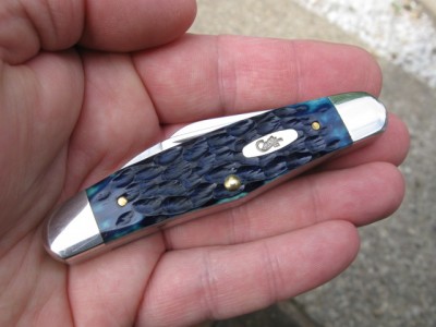

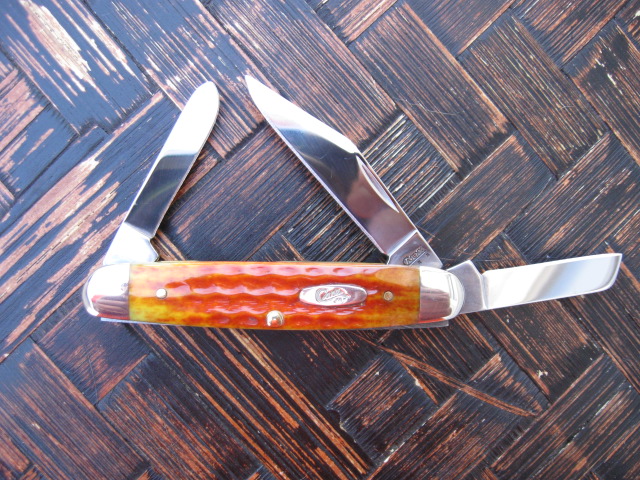

Since you like the your Stockman, I'll post a couple of Case Stockmans with sunken joints.
Humpback Stockman. Nice size and shape with a Spear main blade instead of the more common Clip blade.
6090 pattern.

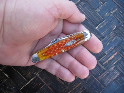

If you have the funds, The Case/Bose Norfolk is a really sweet knife with sunken joints.
Those are just a few suggestions but there are several patterns out there.
6090 pattern.

I have a better idea of what to look for now, and I think the Case Humpback is my best bet for a pocket friendly stockman.
I don't know how I missed that one. I wonder if they built them that way for pockets.

I thought it was called a copperhead because the bolster is "Hershey kiss" shaped like the pattern of the copperhead as viewed from the side. Anyway, I love my mini copperlock. Here is mine next to a full size trapper for comparison. And a copperhead!

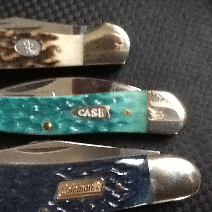

I have found that most modern cases are pretty easy on the pocket. The reason being that they tumble the blades for their mirror finish and it makes the tang well rounded and smooth, the downside is that it also does the same to the tip The as ground knives have much sharper edges (not the cutting edge) and tips.Tsar Bomba wrote:The Copperhead pattern is a pretty good choice for pocket-protection. I've also had great luck with my 6318PU, which dispenses with the spey for a punch and, while not sporting fully-sunken joints, has a Turkish clip blade and a reduced stockman profile that meets next to no resistance going into or coming out of the watch pocket. I also have a "pocket-worn" 6318 with the spey that doesn't fray my fibers in the slightest. There is a little room to file down the kick on the sheepsfoot without issues, as well.
Are the joints on the GEC #25 sunken? That would make another excellent candidate.

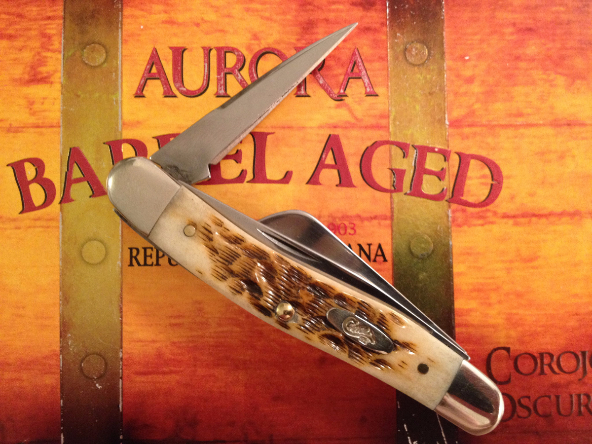

Beautiful knives all. I have never had Case's version of the copperhead, but I sure like the looks of them.
My favorite Copperhead pattern is the Carl Schlieper, both the eye brand marked ones and the Jim Bowie marked ones. Here's a Jim Bowie with a Kentucky shield. 3 3/4 inches long and real sharp carbon steel.

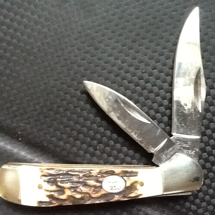

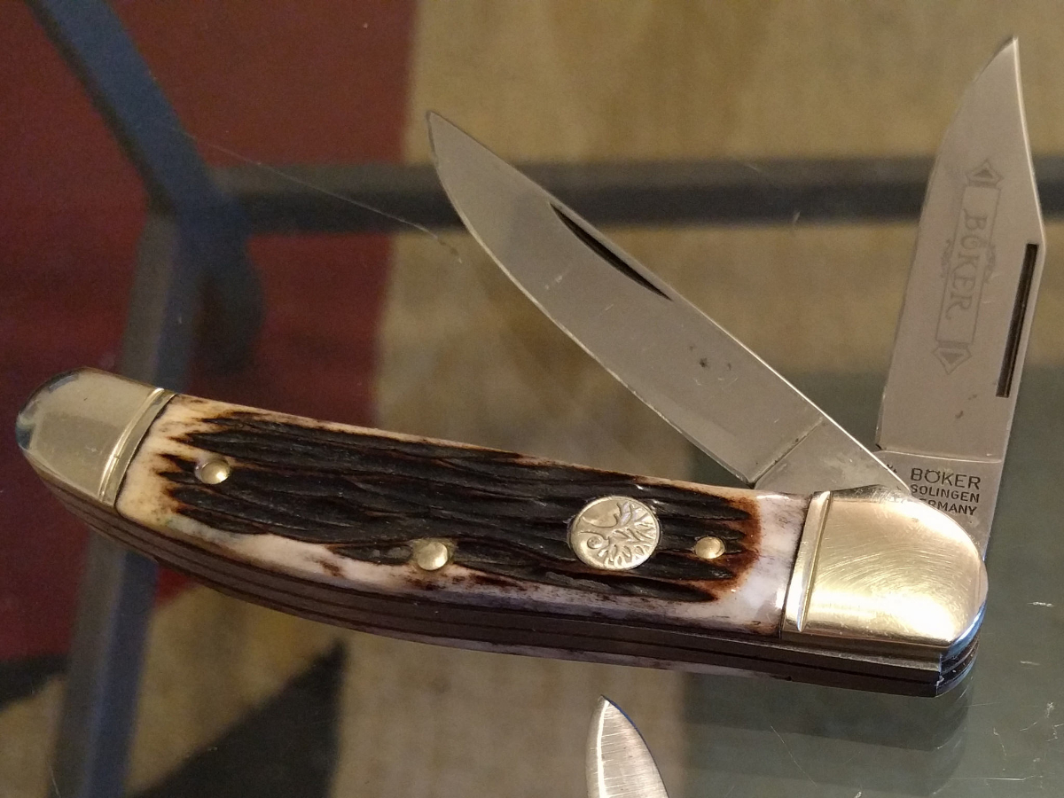

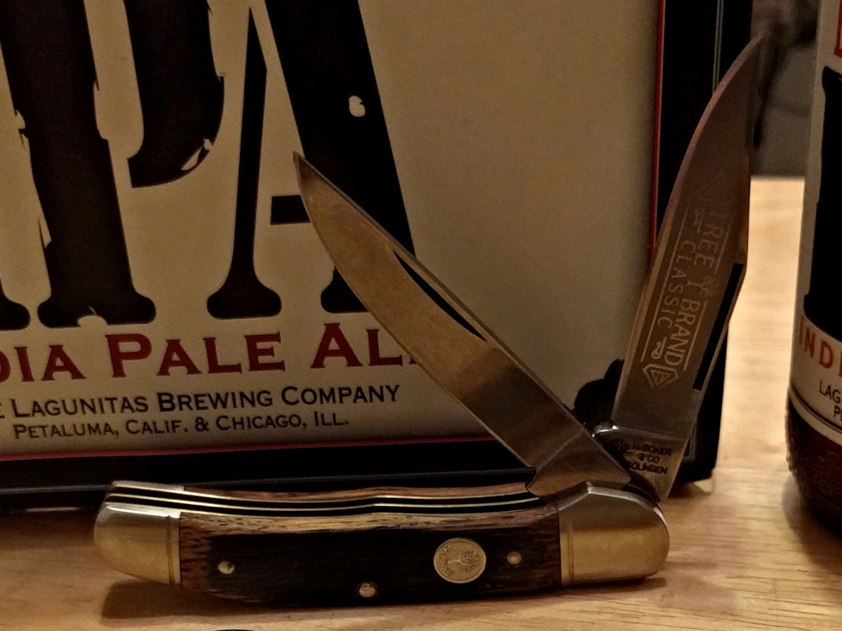

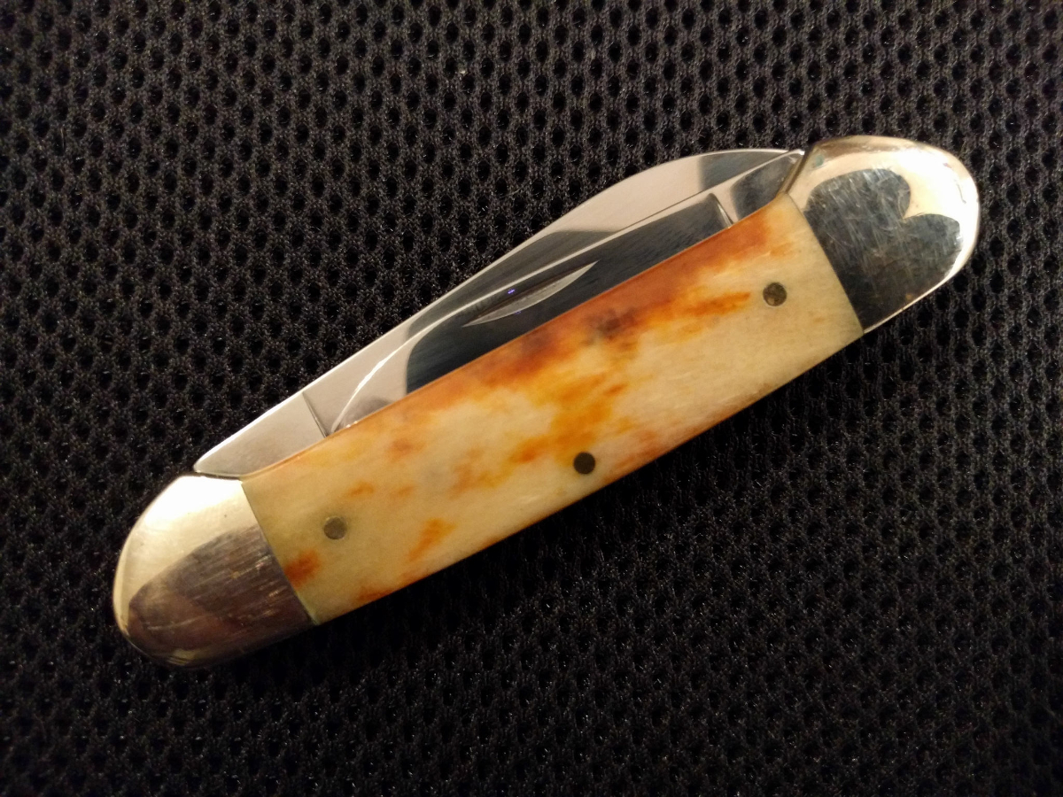

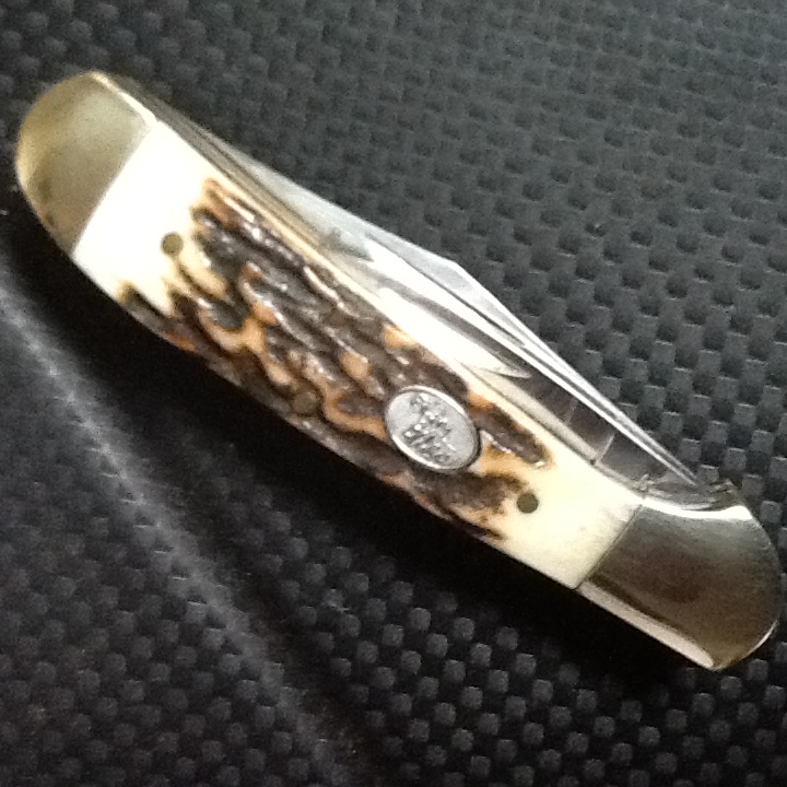

These are the two knives that converted me to the ways of the copperhead. The grooved bone (bone stag?) Boker was my first, and I liked it so much I bought the beer barrel Boker sight-unseen. Haven't regretted it in the slightest. I carried the new one for a week straight and made the skinner blade my own. This pattern is rapidly becoming one of my favorites.
- Posts: 13373
Re: Copperhead
We don't see many Boker, Germany knives posted here, so little Boker discussion. My experience with both vintage & recent Boker knives is 100% positive. They have high standards, very good quality control and quite reasonable prices for new ones.
Boker seems to have been able to survive the onslaught of Far East knives without compromising quality.

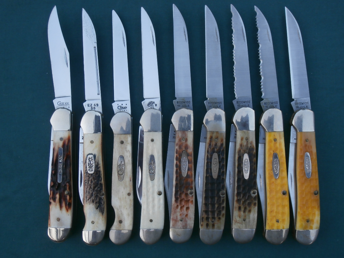

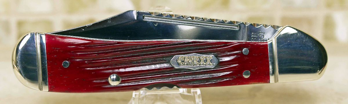

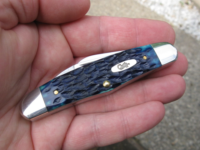

I think the Case 49 Copperhead is probably my second favorite Case pattern, particularly the ones that include a wharncliffe blade.
(Yes, Tony...I am a very sick man, indeed. Apparently, my affliction is incurable and my obsession insatiable. )

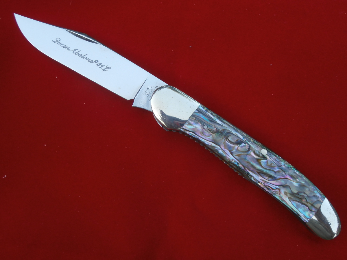

This Queen #41L Abalone Copperhead w/ liner lock is perhaps the best made Queen knife I have ever owned.

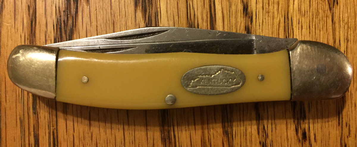

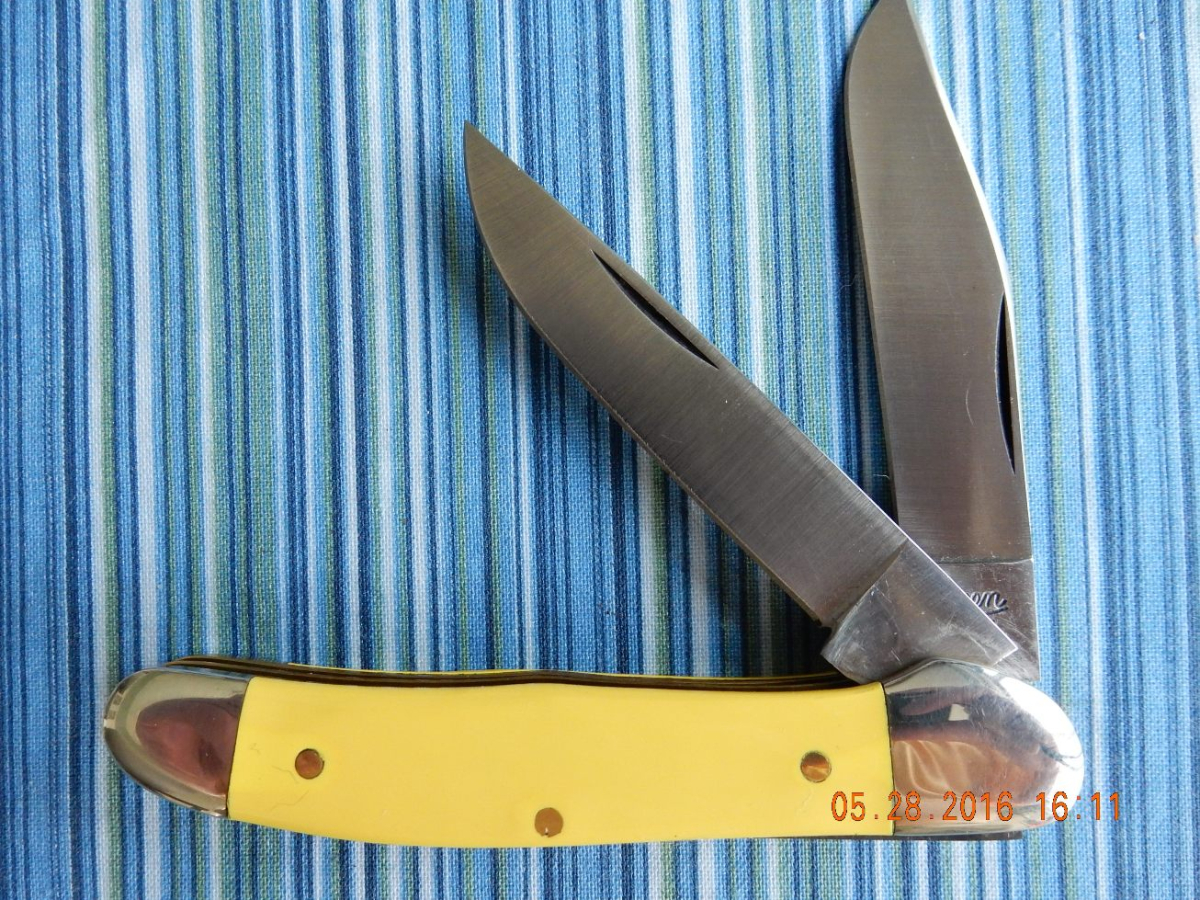

I have this economy line Queen Copperhead. The blade selection is different from the Case obviously.

Bokers have the same clip/skinner blade combo by default. I have yet to see a variation on that. The yeller Queen is awfully nice too but I mustn't let myself be so tempted.steve99f wrote:I have this economy line Queen Copperhead. The blade selection is different from the Case obviously.
