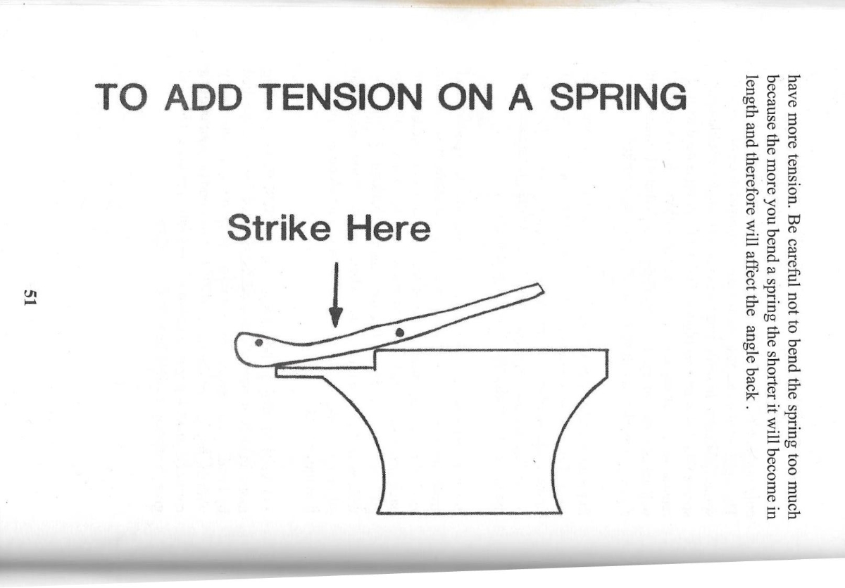

Is spring bending, or re-arching something that is commonly done to correct weak snap in pocket knives?

This is from the Adrian Harris book copyright 1981.

krinking or kinking springs can be done to improve weak snap, sometimes it works sometimes it doesn't. depends on the hardness of the spring and how much wear is on the spring and tang.
I have to disagree with the illustration in Mr. Harris' book. Striking the spring where he shows will shorten the distance between the butt and center pin holes causing a misalignment in the holes on reassembly. Strike the spring just forward of the center pin for best results. JMO, YMMV

Totally agree with Kaleb, you'll never get the pins back in, and if you do you'll likely crack the covers and pull a burr off the pin in the process.

Absolutely correct!
I use a block of micarta with a hole in it and a dead blow hammer to to bend the spring in front of the rocker pin hole. It is quick and easy and no damage to the spring from the hammer or the stiddy.

Thanks Dale. I just ended up giving the spring a couple of raps with a small tack hammer. Checked the deflection of the spring after each hit. Got enough re-arch acceptable snap came back to the blade, not bear trap snap, but I didn't want to push my luck hitting the spring too many times.
