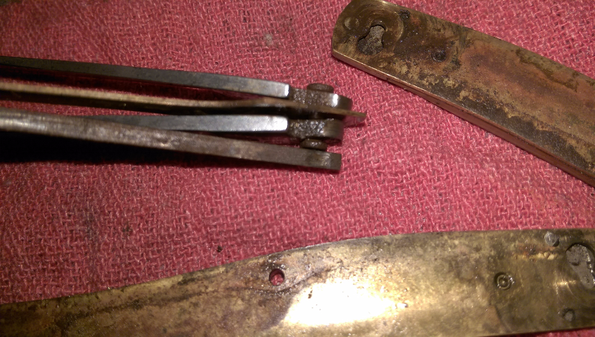

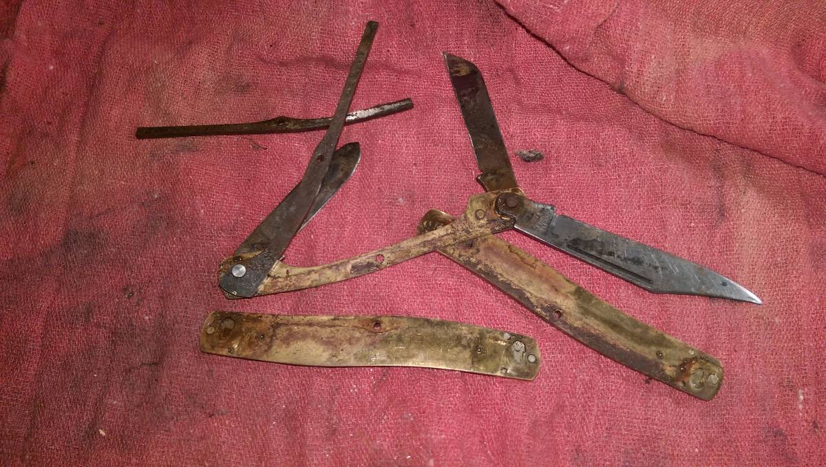

Picked up this 8OT with no snap left in the clip blade, and very little left in the sheep's foot for my first repair attempt.
Thought about trying to drill or cut just the rocker pin to save the barbells, but close examination of the revealed the spring was sank in the frame, figured it was my problem with no snap and worn beyond use. So I just cut it with a razor blade.
Looks like the user of this knife didn't know about oiling the joints... ::facepalm::
Now I need some rocker and through bolster pins. Any of you experienced repairmen know what size I need to get, so my lazy arse don't have to look it up. ::tounge::

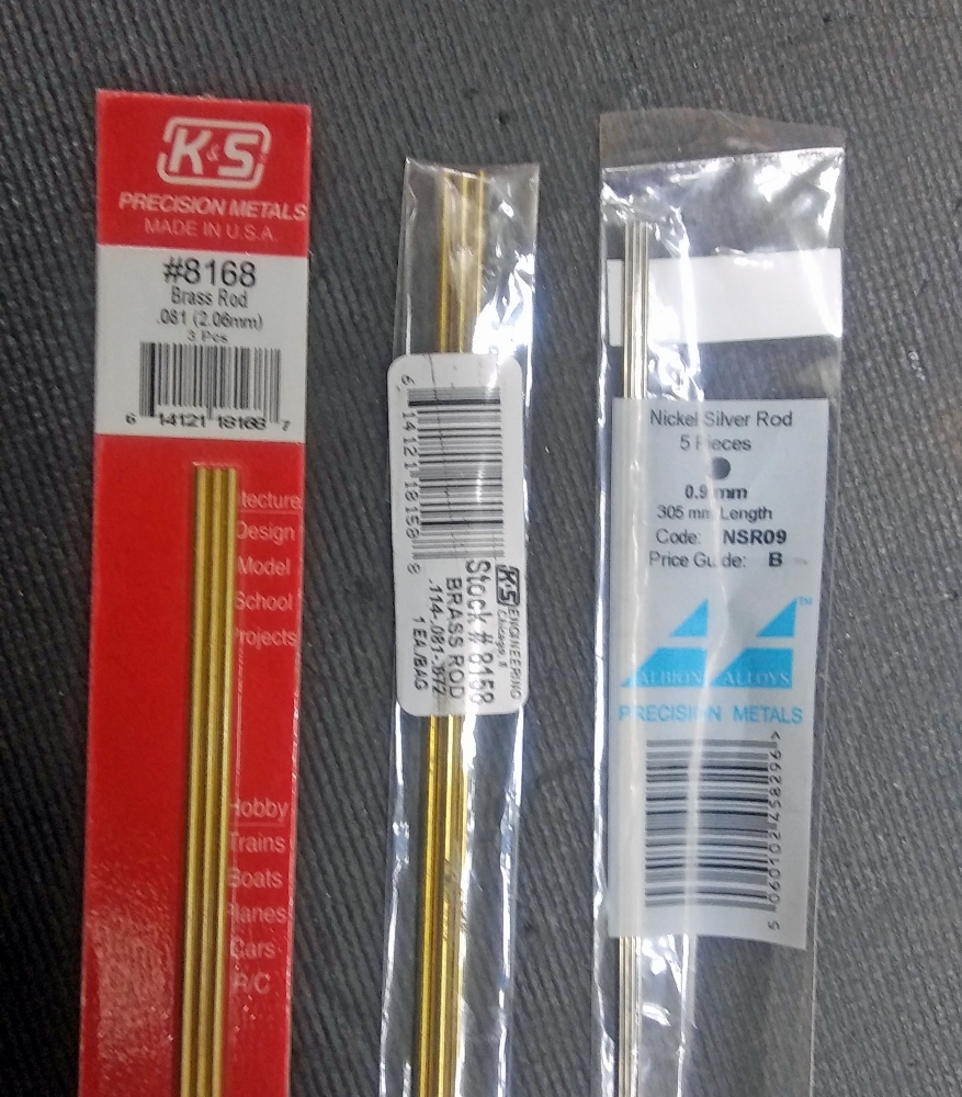

gwelker62 wrote:I had watched that vid a while back. It kinda convinced me I could give a Schrade repair a try. I noticed he used dowel stock and not the common pins sold on feebay and other places. Wonder if the dowel stock is what I should use?
Dowel stock?
I have not heard that term applied to metal pens or rods before. What do you mean by "dowel stock" and how is that different from the pin stock sold by Jantz Supply, K & G, and all the other Knife Makers supply houses?
The only brass and nickel silver stock I have purchased in the US is made by K & S Precision Metals. The newer ones are in the red packages and some of the older stock comes in the plastic sleeve with a stick on label. The package on the left is branded "Albron Alloys" and that I ordered from the UK through a UK eBay seller. Some metric sizes of nickel silver pins are not readily available here in the US. The .9 MM is equal to .0354 inches. Not a size I used often, but certainly not one I want to have to make when I need it.
The other sources I have found for dimensional brass wire are hobby supply companies dealing with beads. I have purchased small rolls of nickel silver and brass why are from such companies, and the wire is indeed the correct size. What I didn't know is that brass and nickel silver can be tempered just like steel. The wire is usually offered in two different degrees of hardness: "half hard," and "dead soft." I was pretty sure dead soft was not what I wanted to pin knives with so I ordered the "half hard" wire. When it arrived I found that the half hard brass & nickel silver were too soft to use as pins. The spring tension in a slip joint can bend a half hard pin and the pivot holes of the blades will quickly wear it out.
Basically the only type of pins that I have found acceptable in knife repair is the brass and nickel silver pin stock offered by Jantz and other knife maker supply houses, my local hardware stores will sell K & S brass pin stock, and a number of sellers on eBay from whom I have purchased K & S brass and nickel silver pin stock. If there is another source of dimensional brass and nickel silver pans (aside from purchasing premade pins) I would love to hear about it!

I believe pinstock is what he was referring to as "dowel" .VS. the premade pins from leftover factories that he sees floating around on ebay
I use some nickel jewelry wire but for pinning shields and sometimes handles. It's a pain turning down 1/16" stock to pin a shield or handle with a tiny hole. Soft wire is actually better for this in my experience because it forms a head very easily reducing the risk of cracking the handle. Of course you can't have the pin too long or the soft wire will bend when you strike it wit ha hammer

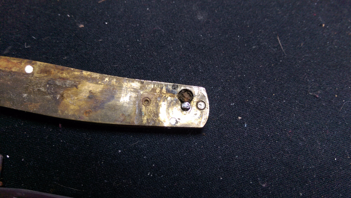

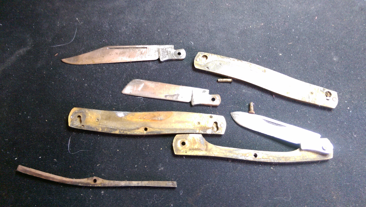

Took a second 8OT apart. This one I just drilled the rocker pin head off and pushed it out so I could possibly saved the barbells.
But as I feared since it didn't have any snap left, the spring is worn. Anybody ever recondition these springs by welding a little material in the worn area?

gwelker62 wrote:Took a second 8OT apart. This one I just drilled the rocker pin head off and pushed it out so I could possibly saved the barbells. IMAG0659.jpg
But as I feared since it didn't have any snap left, the spring is worn. Anybody ever recondition these springs by welding a little material in the worn area?IMAG0661.jpg
Yes, if done with care it is very effective.
As a side note, working on schrades basically approach any repair expecting to drill out and repin everything, if a knife is used and/or worn to the point it has a problem the swinden rivets are usually part of that problem

You can bend the spring to gain some snap too, just make sure you bend it just forward of the center pin hole, and not too much, a little goes a long way. You may have to re-grind the back a bit because the geometry might be thrown off, but it saves you the trouble of welding and grinding the spring. Trace the outline of the spring on some paper so you can gauge how much you're bending it.
