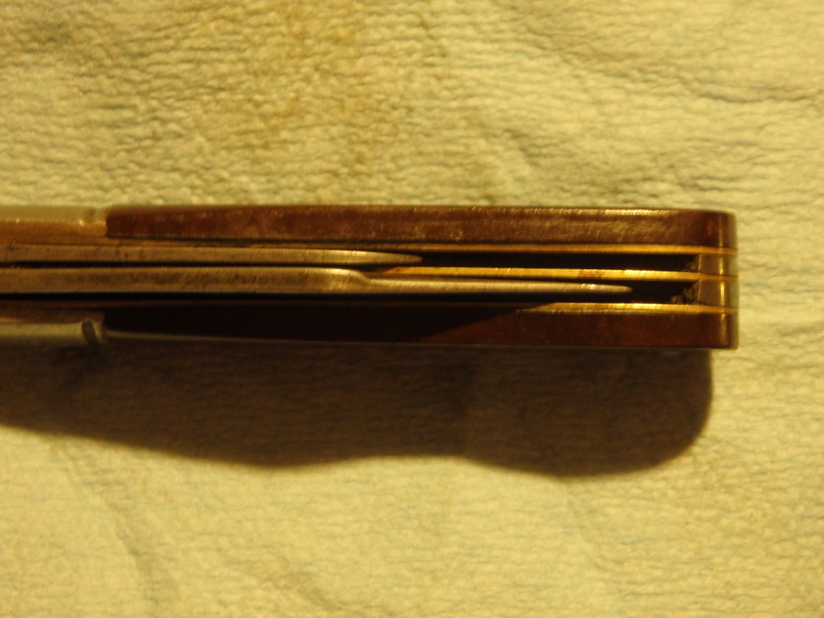

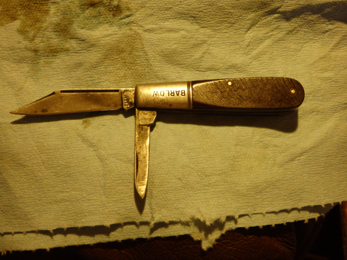

Been trying to learn some knife repair skills, just because I'm interested, and have a few to practice on. Now, I've never been a huge Barlow fan, but, been going through the Venerable Barlow thread, there are some pretty knives in there. I have a Camillus Barlow whose blades were both pinched inwards, toward each other, and no amount of oiling was helping them close on their own. I guess I understand the basic idea of crinking, didn't really want to break a blade, but, this was a knife I got in a lot buy (no wonder), little to lose, so....jump in with both feet! Using a variety of makeshift tools, because I'm NOT a knife repairman, so I make do with what's at hand---like a tinner's hammer (for sheet metal work, too big for the job, but, it worked), angle iron on my trailer outside for a stiddy (trying to keep the noise down in the house, significant other is sleeping), I either got very lucky, or accumulated life experiences allowed me to correctly "feel" what I was doing, and I have a functional, albeit cheap, Barlow to carry. I'm quite pleased with this, though I wish the blade was a little fuller, it takes a great edge. I'll smile a little everyday I slip this one into my pocket. Thanks for looking!

It's bending of the blade (or blades) so that it fits smoothly and fully into the bladewell of the knife. Good question, Bob.

This may or may not help, he doesn't explain much. You can see what he's doing if you already know what he's doing. Basically, hitting the tang of the blade so that the tip of the blade moves in the direction you need it to go. VERY carefully. ::tu:: https://www.youtube.com/watch?v=qhmQAoM ... 136.568865
