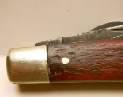

There is a guy near here that is doing beautiful work patching bone handles with super glue. He mixes leather dye to get the color he needs and fills in the hole. He uses a nail to get a rough shape with the jigging to be matched and then the Dremel to finish it and buff it out. You can detect his repairs if you roll the knife and watch the light reflect off of it,but you wouldn't notice it with a quick glance. I am going to go take some pictures and post some of his work.
I think to repair that you would have to fill it and then redrill for the rocker pin. If not the repair would lock the rocker pin.

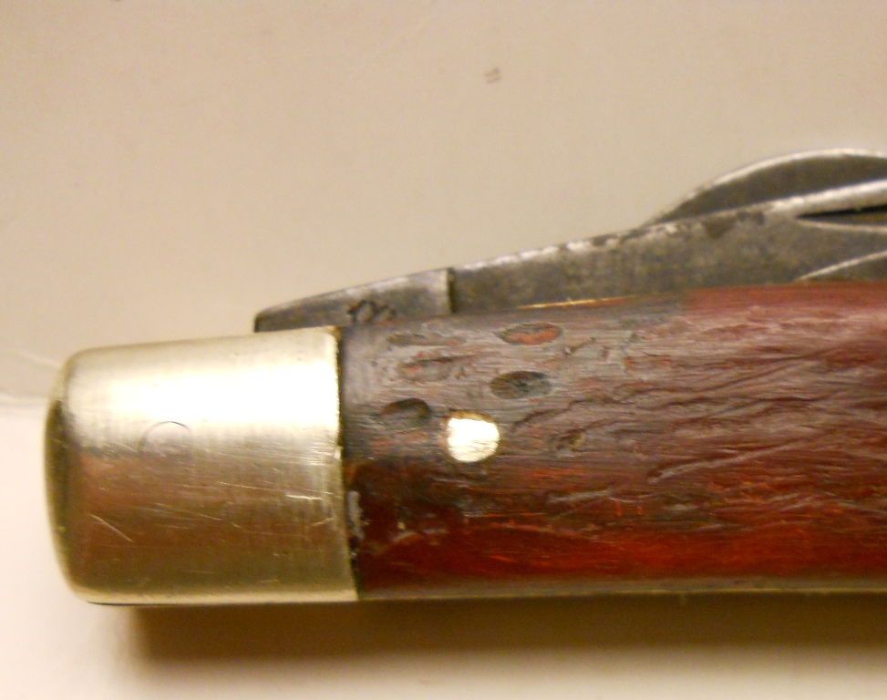

Duh. I happened to think after that last post that I had a knife here that the guy patched. 4 blade German Boker congress knife with red bone handles. I looked for a handle for a year and gave up on ever finding one. This isn't a perfect color match on this. With black or very dark colors the guy can match them dead on and that is the key to a nice repair. Look at the upper left corner of this knife. Super glue, leather dye, rough shape with nail, Dremel.

just bob wrote:Duh. I happened to think after that last post that I had a knife here that the guy patched. 4 blade German Boker congress knife with red bone handles. I looked for a handle for a year and gave up on ever finding one. This isn't a perfect color match on this. With black or very dark colors the guy can match them dead on and that is the key to a nice repair. Look at the upper left corner of this knife. Super glue, leather dye, rough shape with nail, Dremel.
thats a very nice patch job. I would be interested in knowing what brand of glue and leather dye he is suing. The superglue I use tends to gum up instantly whenever any kind of pigment is added to it.
