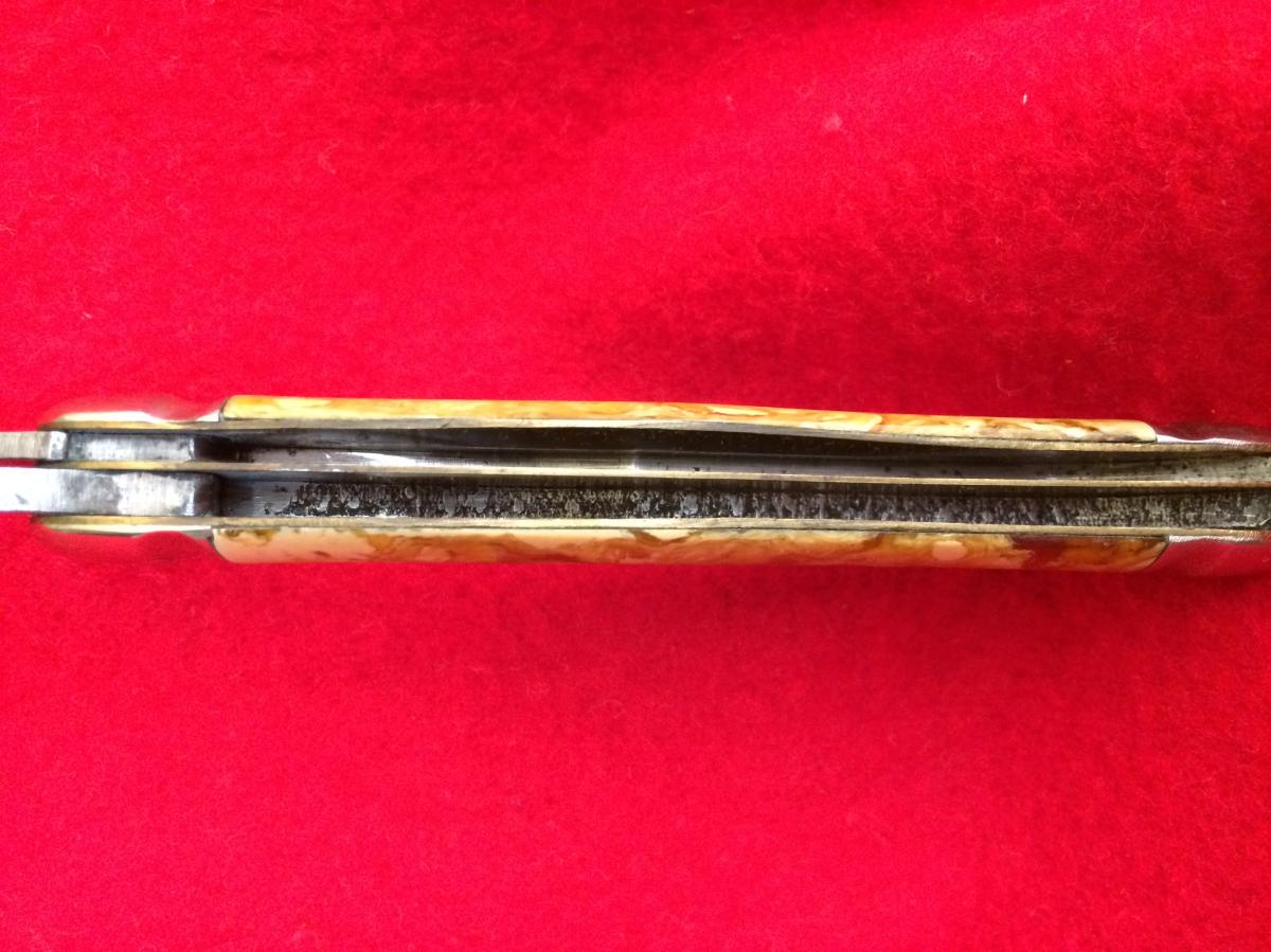

Looks modern to me also. Just one tang stamped? Unusual. Not sure whats going on with the interior view of the master blade but looks like a lot of deep corrosion with clean blades, again unusual. Unusual looking knife. Looks more like a recent German import.

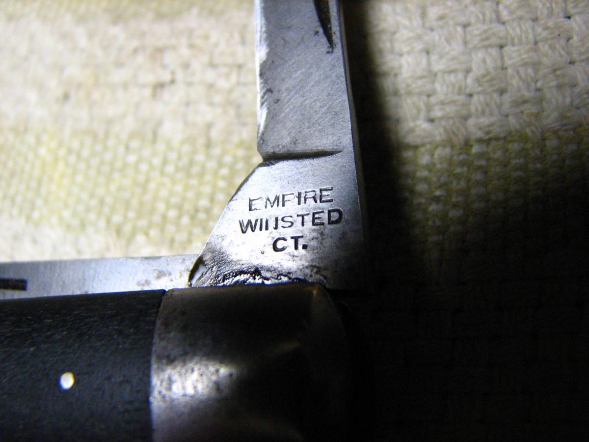

Hopefully a much better image of the stamping. And just the one stamp on the main blade, nothing on the secondary. I though I'd seen something like this before in one of the forums? Thanks.

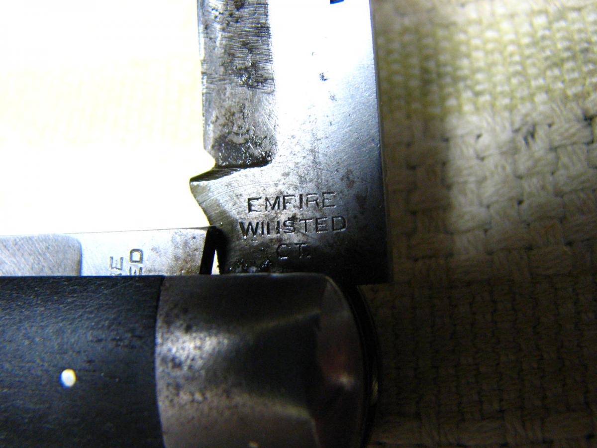

Thanks for your observations. I hate looking at stamps because I tend to over focus on that part of the knife and miss other signs/issues. But in this case, the stamp doesn't look stamped, more engraved when compared to an original older knife. Hopefully someone will have a more definitive answer. Thanks, Merle

Here's my Empire with both stamps. Looks like the same stamp hit both tangs. (on my knife)

Hate to be disagreeable but nothing about this knife looks modern to me. The handles appear to be celluloid (Bakelite?). Notice the long pull on the master, the way it almost cuts into the tang and almost into the swedge, something that is often seen on old knives. Notice also the rat tailed cap and bolster, another old detail. The lack of a tang stamp on the secondary is a little worrisome.
The knife may well have been cleaned and apparently hasn't been used much, but it really doesn't look modern to me.

The long pull nail nick looks sloppy, but that may be that the front edge may have been cleaned up, lowering the spine some. The thing that bothers me is the main spring in the well. That's quite rough from what I am used to seeing in knives of that vintage.
It has all the elements of a vintage knife, but they just don't seem like they all go together right.

One final observation (from me) look at the fit between the blades and the back springs, pretty tight.
Also note the pit on the back spring, unusual for a new knife, finally, if you look down into the knife, it looks like there is a considerable amount of pitting, another possible indication of age.

The pitting on the interior of the main back spring is a prime indication that this knife has been taken apart or recently assembled from parts. Deep corrosion pitting with no visible active brown rust along with signs of heavy abrasive cleaning. Note the shiny areas showing scratches with no brown rust or scale. You can clean the gunk and rust from the interior without taking a knife apart but not to this extent.
Deeply corroded and subsequently cleaned interior. Shiny blades with no evidence of pitting or obvious heavy cleaning. Interior view of the blade tangs also shows no corrosion or pitting. Doesn't add up.
If I had to point out one thing that looked right about this knife I would be hard pressed to do so.
