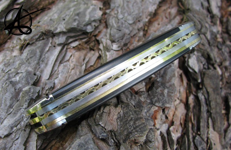

Western 901 camp knife with linen micarta covers, fileworked backspacer (901's have this HUGE thick brass spacer. It BEGS to be carved on!) and big 'ol rat tails on the bolsters.

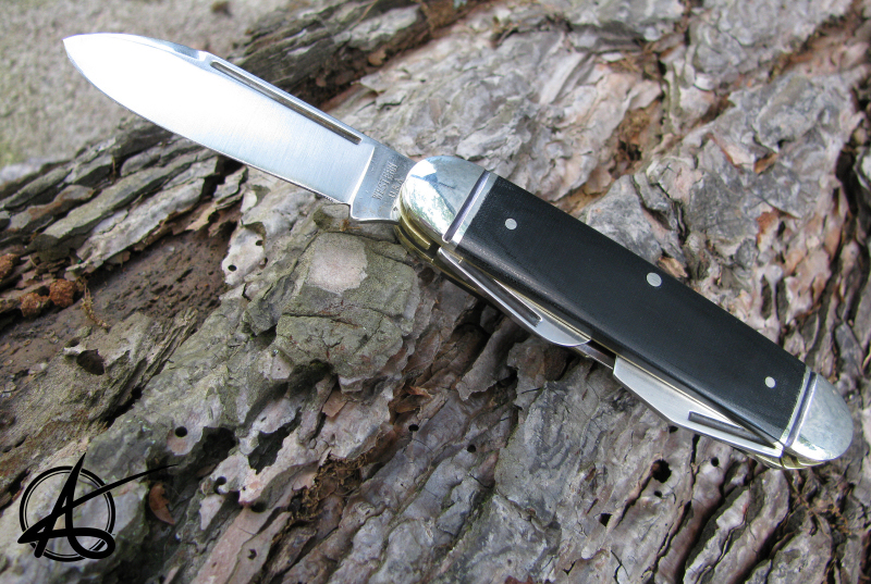

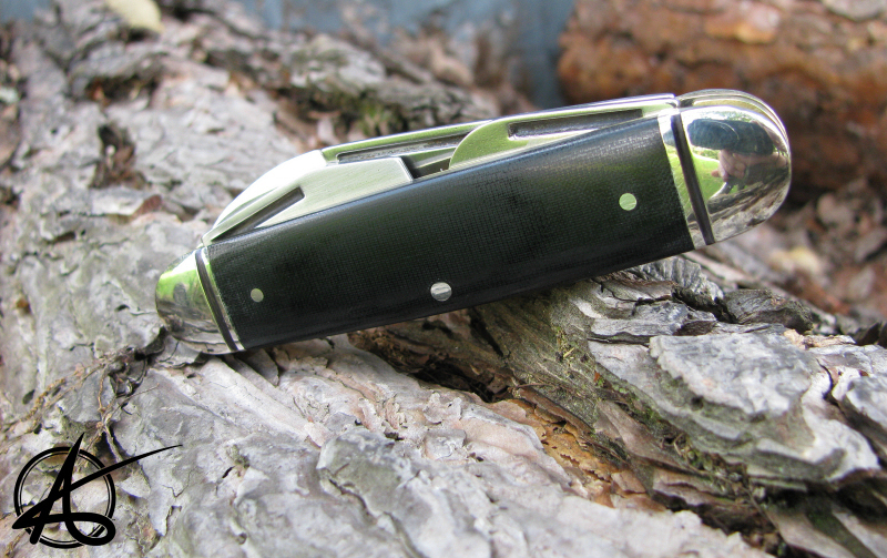

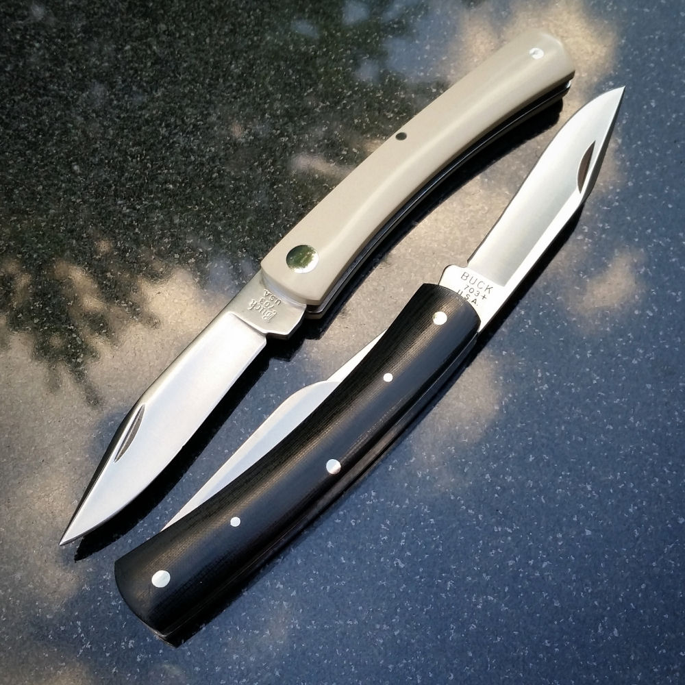

After Chuck Buck's passing, I realized I didn't have any Buck knives in my collection and I was saddened by the fact. I did, however, have an old script 703 in my project bin with a broken spring on the secondary blades, and a block 703 I had bought for parts (before I discovered the 2 to 3 spring conversion. duh). I pulled them apart and did a nice pair, the script was stripped down to the only usable spring and rebuilt as a shadow pattern with a sodbuster style pivot and ivory micarta, the block 703 was done as a shadow pattern in black linen micarta.

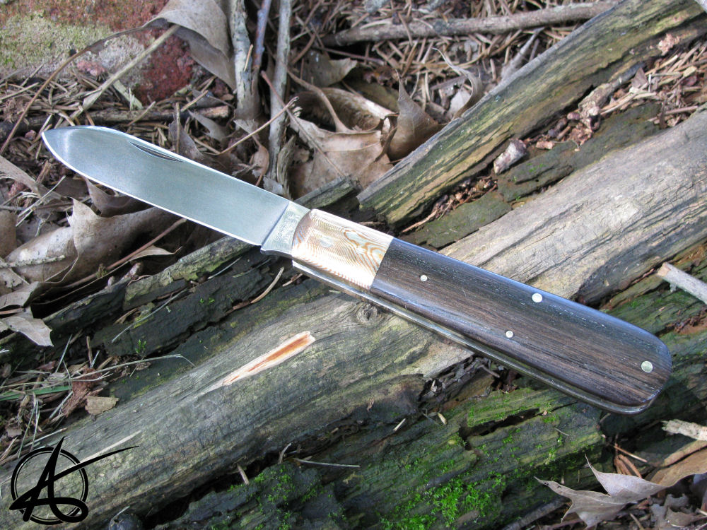

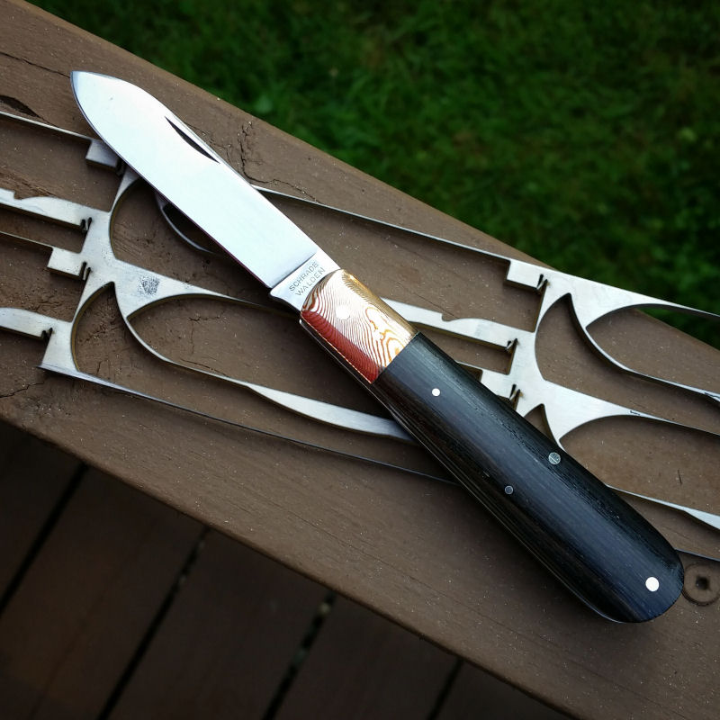

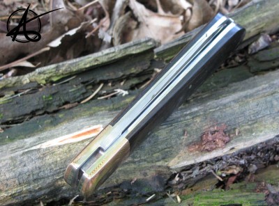

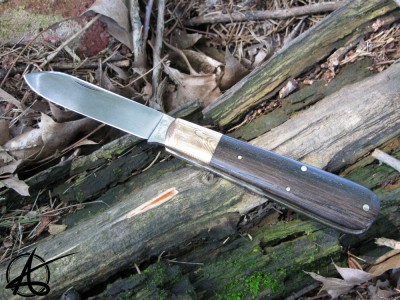

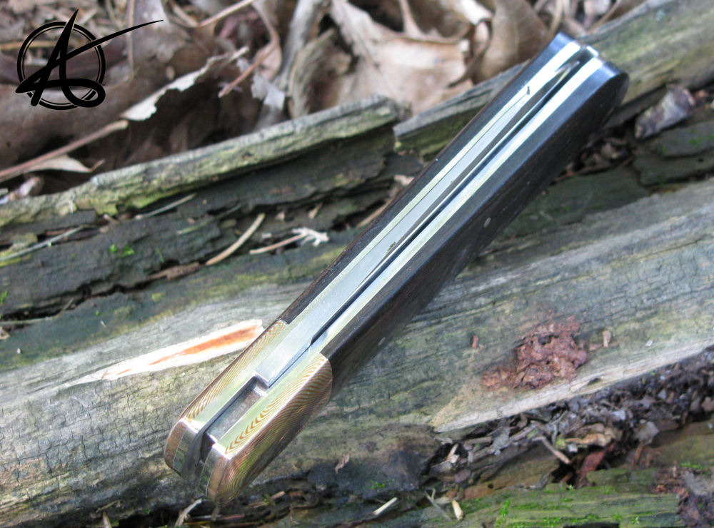

I also rebuilt a Schrade 204 linemans knife. This was a full rebuild with new, thick nickel silver liners, soldered extended copper/nickel mokume bolsters and some 5000 year old, stabilized bog oak covers. The blade was cleaned up, then stonewashed in a tumbler with some fine ceramic media giving it this milky, hazy kind of polish.
Copper/Nickel Mokume ages really well!

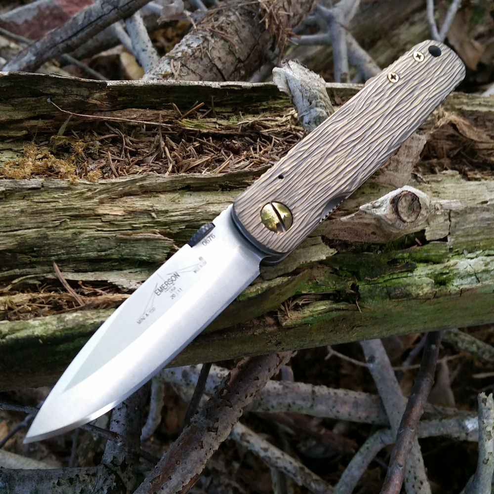

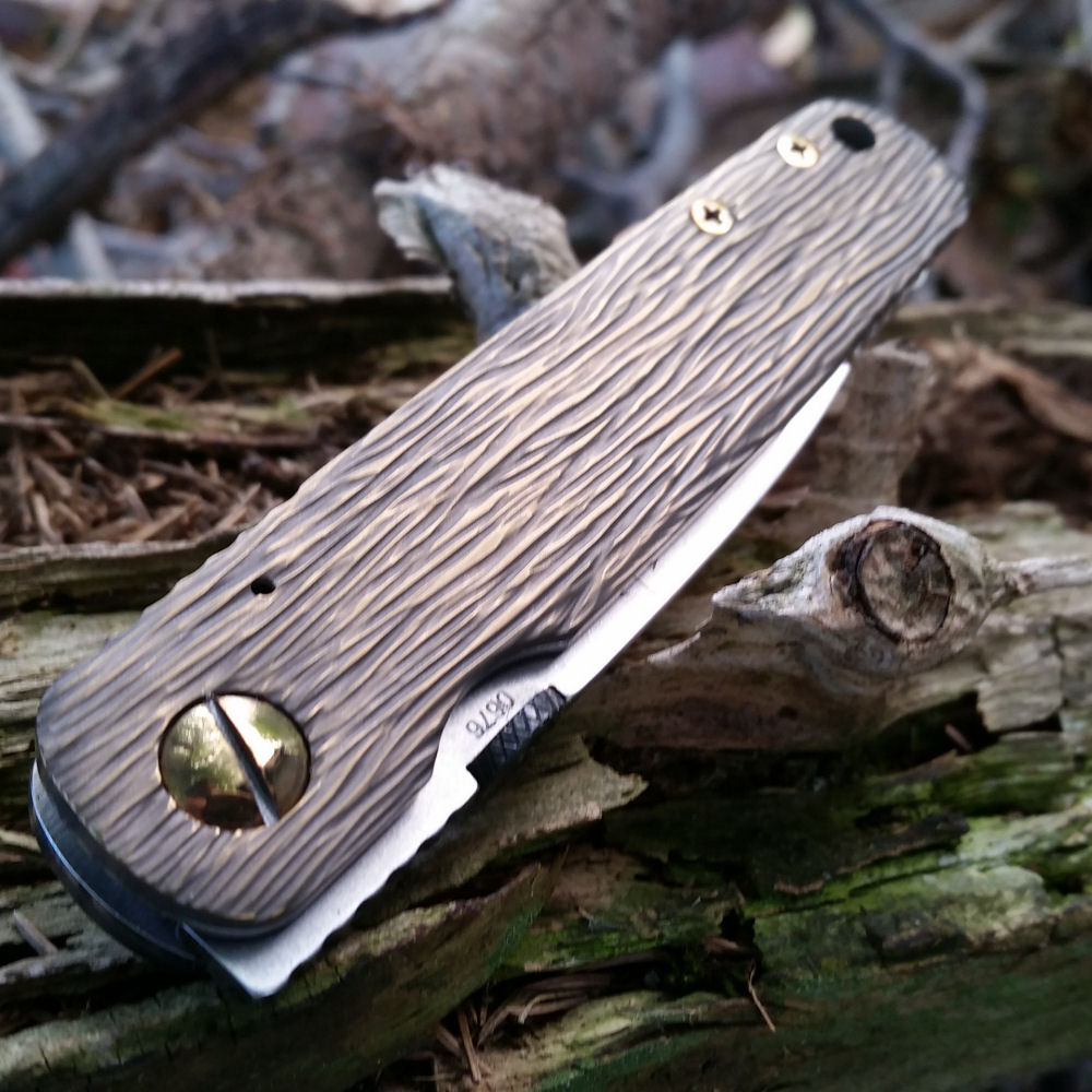

For the "modern" knife lovers, I toyed around with some titanium scales for my Emerson Mini-A100 as well. After a few months of experimentation and testing, I'd come up with a way to emulate woodgrain textures pretty convincingly.
The end result, through carving, blasting, tumbling and polishing, makes for something that is extremely "fondle-able" and reminds me of the "feel" you get from some nice, well done jigging.

I love what you did with the Western camp knife...that's a knife I'd brag on.

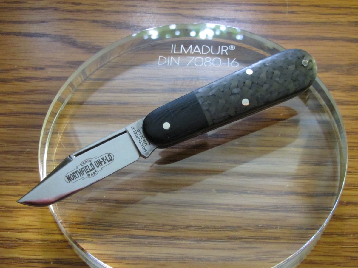

Do you remember this one....I will use it one day...I really will...

I do Bob!
To date that's still one of my favourites! When I try to explain to people what I mean by customized, and I don't have something on my person, that's one of my go-to photo examples. That's one of only two times I worked with CF, so consider yourself lucky . I like the looks of it, but that's about it lol. It's nasty to work with... very unhealthy dust, finishing is a pain, voids you have to deal with, and oh the tiny glass splinters for days afterwords... I have a little sheet of LVA in my materials bin, it's been there for like 2 years. I just don't wanna touch it

Adam it's great to see you participating here again. I'm impressed with all the knives you've posted on this thread, but that Western Camp Knife is special. I really, really like what you've done with it.
